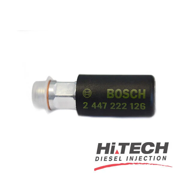

Do you have a link for the bosch pump or how I could find it
Bosch part number 2-447-222-126
I just replace this not the whole module?
Correct.

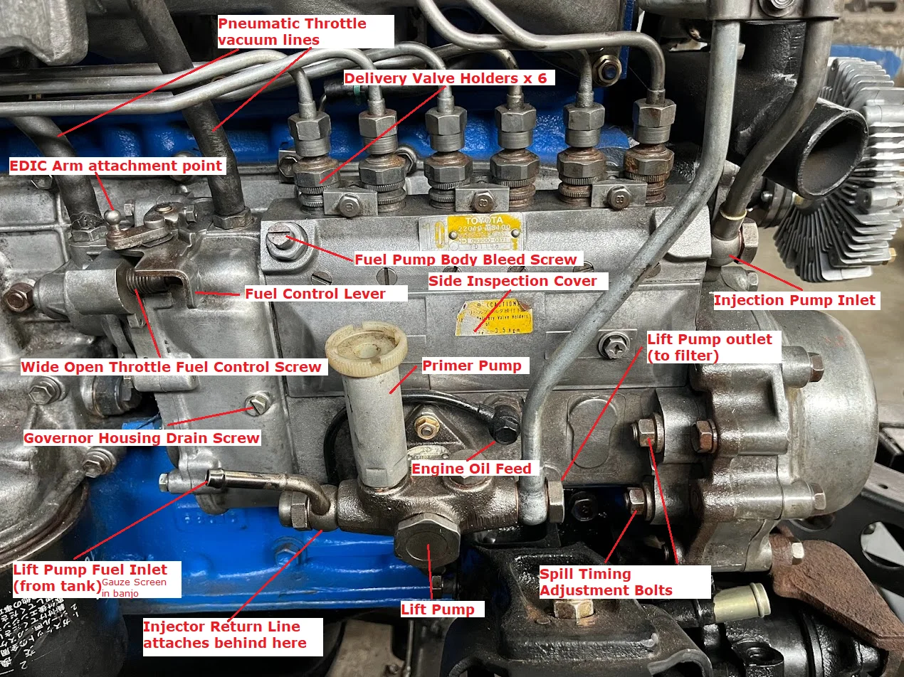

There's essentially three pumps:
1. Primer Pump
2. Lift Pump
3. Injection Pump
You only have an issue with the Primer Pump.. here's an image I created for the 2H Injection Pump Assembly that shows the three parts - amongst many others. The 3B injection pump is much the same..
Ok thank I was lookin on line for the lift pump and couldn't find my same issue and was having trouble thank you for clearing it up.
