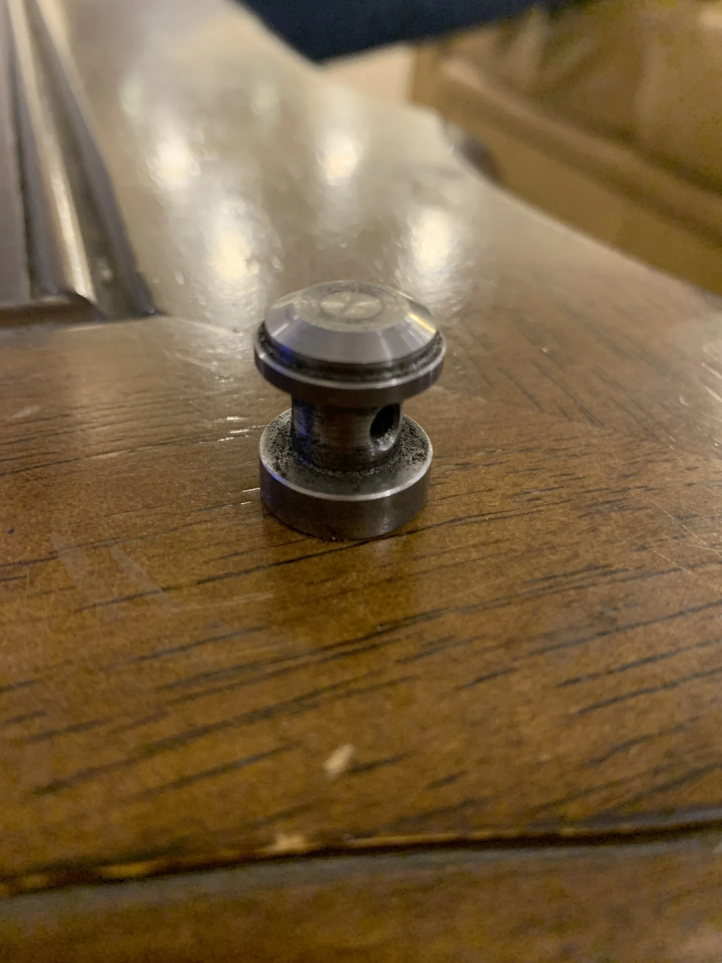

Yesterday, I was replacing the oil cooler O rings on my 1984 3B engine, I removed the Oil relief valve assembly case to inspect and remove the old gaskets on the cover. However, in my own stupidity, when cleaning up the old gasket material with my central vacuum system, I accidentally sucked up the valve. After searching the bag I used an earth magnet on a plumbing snake to locate and retrieve it in the central vac plumbing.
Upon the rediscovery of my relief valve, I couldn't happen but wonder if I collected all the pieces Is there supposed to be more to this valve than what my picture shows? perhaps a steel ball? The FSM doesn't seem to show anything else included but I have to be sure before I re-assemble my 3B.

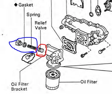

Blue circle: I already have these.
Red circle: I have the main piece, not sure if anything else that is not specified By the FSM is missing.
Black: what does that piece do? I don't remember taking it out.
any knowledge is welcome.
