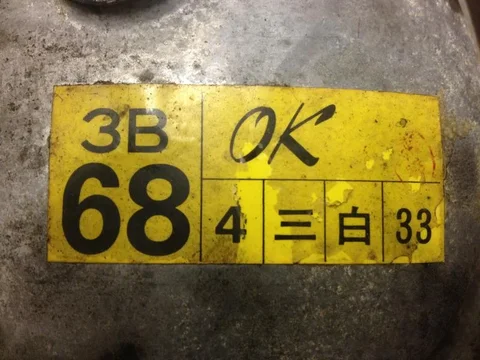

Anyone know if Shane reproduces this decal. Looks like a QC mark. Maybe they are all different depending on who QC'd the motor?
