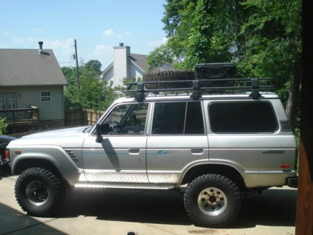

My other friend sold this... 3B-T H55 and it did have power:D
attachment.php
the plan
The plan is to turbo it eventually. I have the BJ60 so I have all the parts and it is the cheapest solution.(Unless someone wants to buy the drivetrain so I can configure it differently:D)
The BJ60 non turbo was my daily driver for awhile and easily hit 75 on the highways of Texas. I suppose for any mountain driving or elevation gain a turbo is a necessity. The runner will be lighter than the 60 by a lot! Really I am looking for a veggie burning pre runner with a removable top for the summer. Guess nobody has a 3B conversion or swapped 60 axles then.
