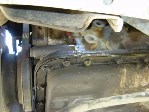

My 82 BJ42 has recently starting leaving big puddles of coolant on the ground after running for a few minutes. I've crawled underneath the vehicule to try and find the source. The last area I can see goes to the backend of the waterpump housing? (It's wet as fair as I can reach with my finger) - Has to be the waterpump housing seal? Am I missing another possible source?
Arrow shows last area I can see.
Thanks for looking!!!
As much as I can guarantee anything, that definitely looks like a waterpump to me. Mine has the same drip pattern. It's just as often leaking out of the shaft as the gasket.

Thanks Lumpy
So when I pull it all apart - if it's wet by the shaft waterpump is most likely the culprit. I wasn't thinking waterpump as I though it would be leaking on the front side of the waterpump casing.

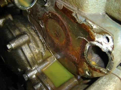

Waterpump Housing Off
Well I pulled the waterpump housing to check the gasket and it seems the gasket was likely the source. :eek: It's almost totally disappeared in some areas !!
I spun the waterpump and pump spins very freely and feels very tight at the shaft - any other checks I should do on waterpump before re-assembly??? Ordering new gasket tommorow.
