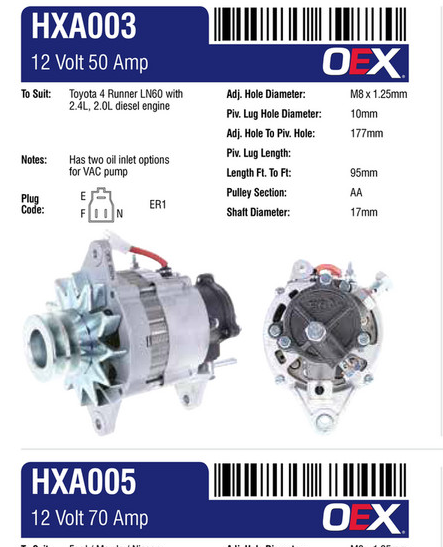

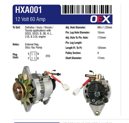

OEX says its for L and 2L diesels. I think you need HXA001 Note you can check the dimensions on the RH side of the pic. It looks like the FT to FT distance will be too small on the HXA003. Its an internal measurement. There are HXA001 alts for same price on Aust ebay. I think the HXA001 would fit the L and B diesels, it seems to mention them in the 2nd pic. And the HXA001 is 60 amp

I have a 3B from a BJ60 in a BJ40 so other alternators I looked at were the OEX HXA001, and the HXA003 which would both mount as I have the mounts for both the BJ40 and BJ60 applications. They do have different electrical connections, but this is easily overcome. The latter would also fit the 84-85, and probably the 84-87 pickup. OXE has dimensions for each alternator, which is useful in determining if they will mount to your engine.
However, the most detailed application list I found for the OEX generators is at www.tinkr.nz, specifically the listing for the HXA001 is at Tinkr - Car parts & Accessories - https://www.tinkr.co.nz/product/385386/alternator-12v-60a-suits-hitachi

3 prong connector, 2 oil lines, 1 vacuum hose. Seems like HXA003 has the 3 prong, HXA001 has 4 prong…so 003 might be the best fit? Question is pulley and mounting dims lining up…anyone know how I could be sure it’s an appropriate swap?
