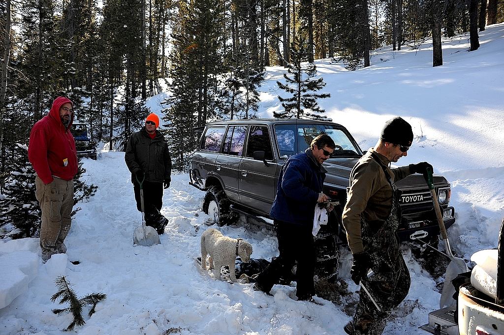

Thanks guys for a great time. Thanks for digging me out, pulling me out, pushing me out and above all helping me out. Here are the highlights..
The short axle shaft broke just inside the birfield. Everything else looks good.
