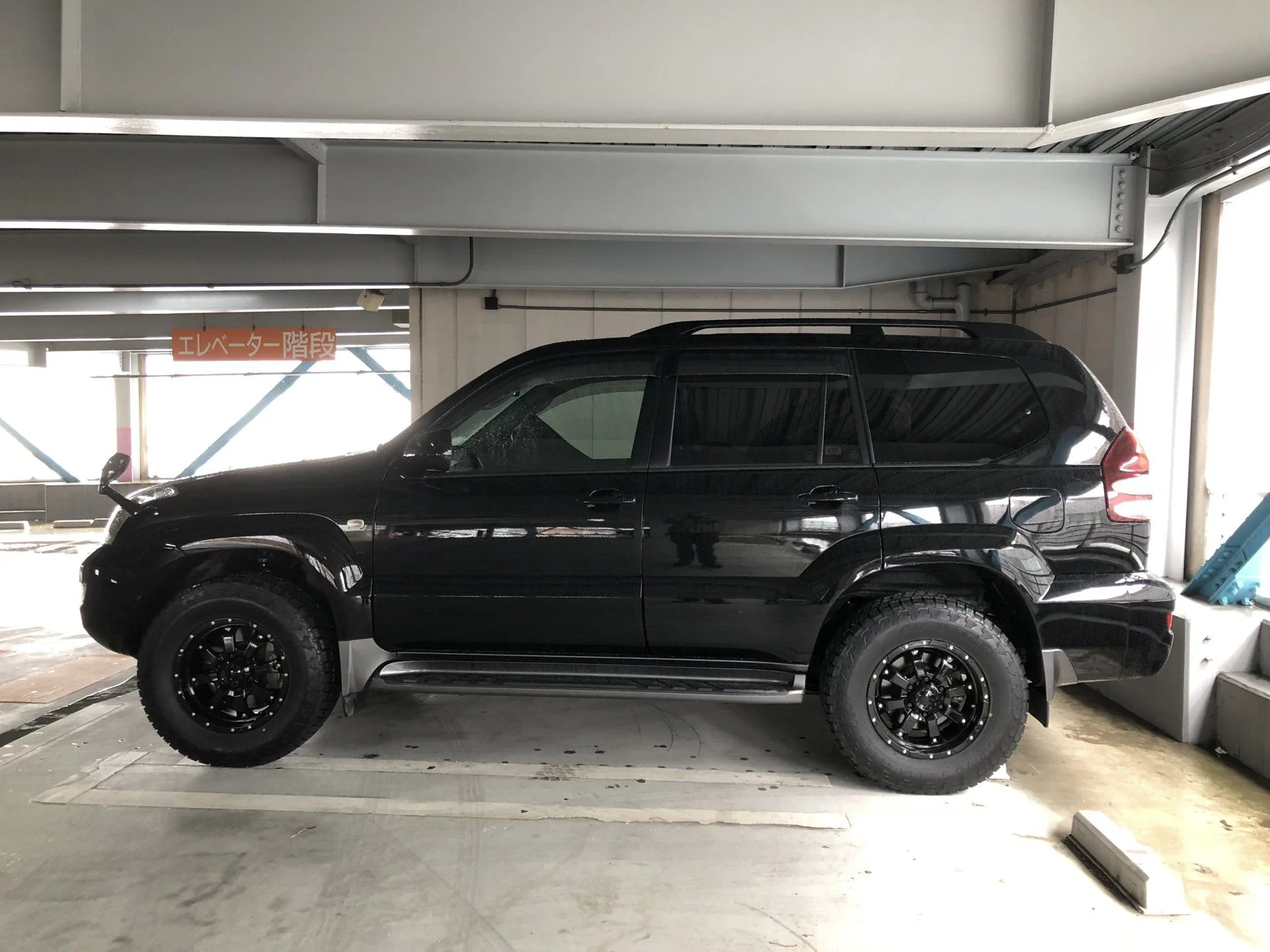

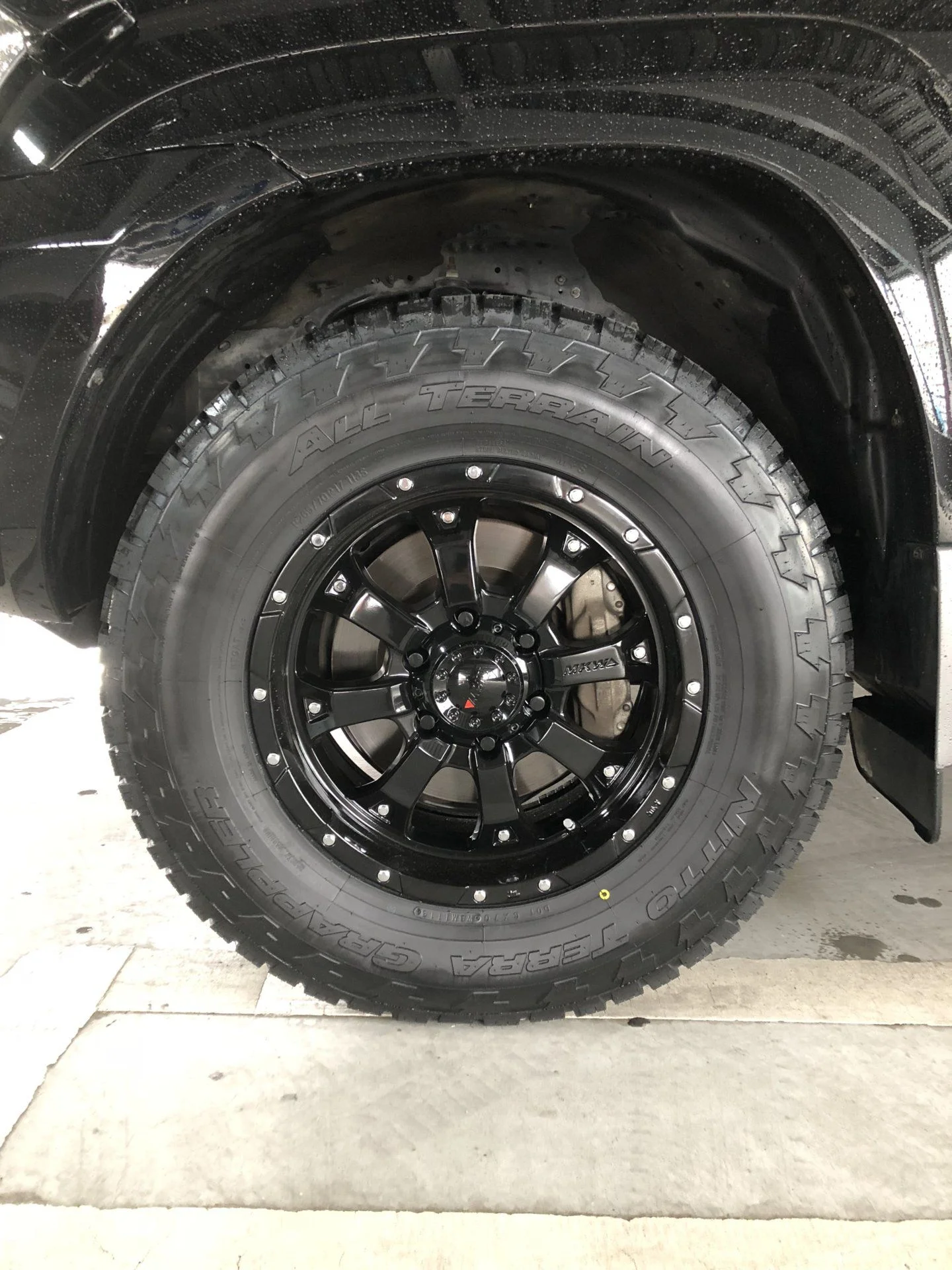

I run 265/70/17 Nitto Terra Grapplers. So far, I have no complaints about the ride. No significant change in mpg. No road noise going down the highway.
