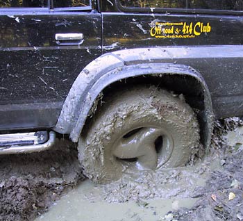

Another alternative is to just cut the fender lip and mount some sort of low profile rubber fender trim. Something like this but not so big.
