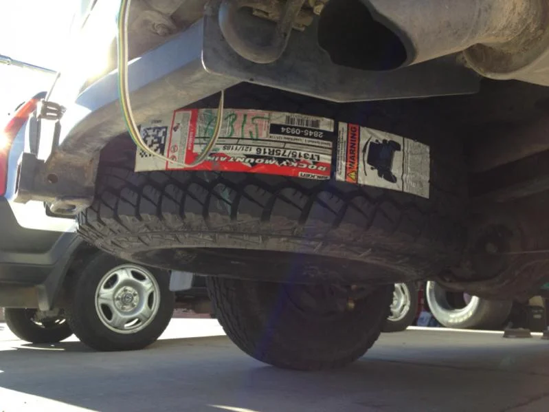

I BORROWED A new 315 Falken from my buddy at a local Discount Tire and guess what... IT FITS like a glove with the factory tow hitch installed. Certainly no spare room but I was able to winch it up and down without too much profanity. I think I will order the AJIK relocation kit and see if I can get it tucked up a couple more inches.

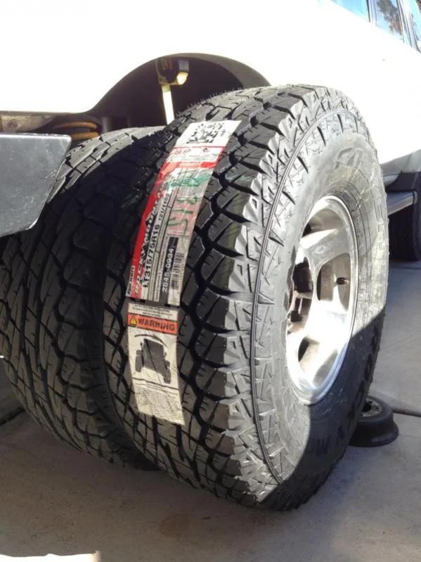

285/75-16 mounted. 315/75-16 outside. 315 is about 2.5 to 2.75 taller than 285.

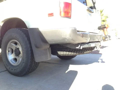

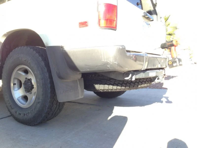

315 stuffed in.
Just like Prego... It's in there! ;)

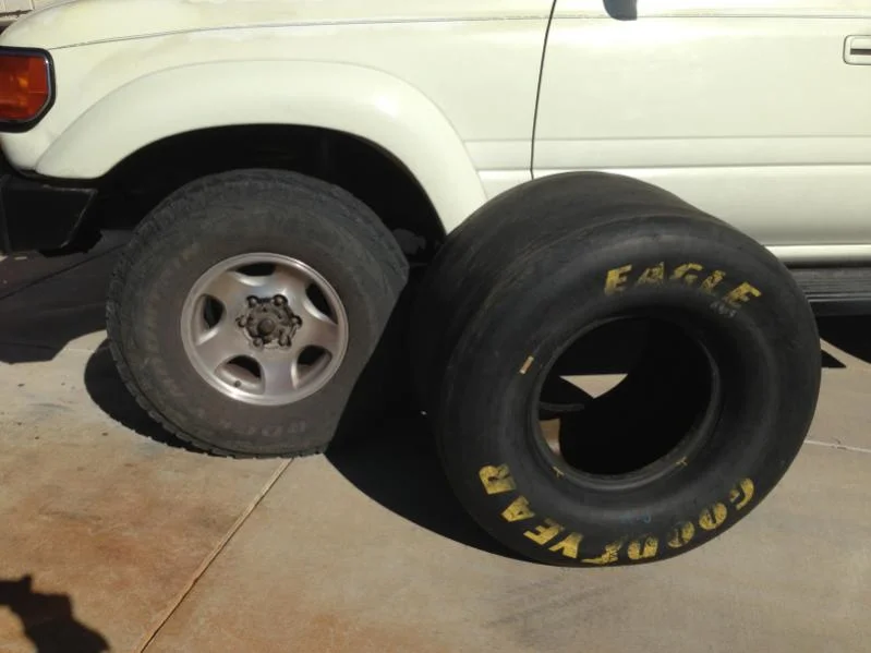

I had this kicking around the shop but I couldn't make it fit ;)

Make sure that the spare isn't touching the panhard bar on the rear suspension. Then you're good to go!
It IS touching the panhard bar... Now what?!
Most newer 315's are slightly too big to run in that location. A tire that is less than 34.25 inches seems to fit most LC's that are running a stock hitch. My suggestion is to run a super skinny spare (34x9.5x16) Swamper on a 16 x 6 steel trailer wheel. With your hitch, it will almost be entirely tucked up and out of the way. With the AJIK relocation kit and a 1.5 BL, my hitch becomes the lowest point in the back and makes a great defacto rockslider. Of course, I do not run that spare in the rotation, but it's close enough in size to a 315 that I can run it if need be to get me back home without worrying about damaging the 4wd system.
