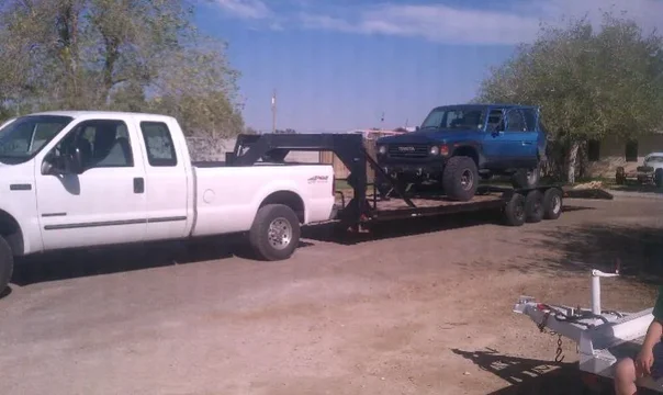

As to if its strong enough, would need to know dimensionally where the support points are. Wet thumb in the wind answer is probably. Who built it? Picture(s)?
I'll snap pics of the frame tomorrow.

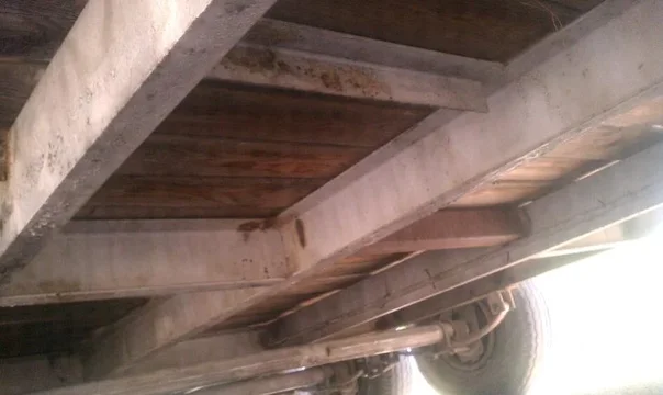

Here is a pic of the underside. I'm wondering if it will strengthen it considerably by just boxing the c chanel in with some 8" 3/16 plate.
Torsional strength will increase significantly, but bending strength won't increase by much. Load capacity is in the top and bottom flanges. The further apart that they are the more load that they'll carry. Another of those counter-intuitive things, seems like the load would be carried in the flat sides, but consider an I-beam's shape and how it's best loaded. If you want a stronger I-Beam you'll end up with one that is taller more than one with a thicker web. All the web does is keep the flanges equi-distant apart. Same is true of the fabricated roof beams; note that the flanges are real lumber while the web is usually particle board.
More load capacity would be more easily achieved by adding a "strong-back" "fin" to the middle of the lower flanges, and then running a piece of strap about the same width & thickness as the 'C''s flanges down the length of the strong-back - effectively turning the lower flange of the 'C', the fin, and the strap into a fabricated I-Beam. Start and finish the strong-back with a taper so that the strap can be welded directly to the existing flanges of the 'C' beams at each end.
Was it me, I'd try it as-is. I think that there's enough structure there to work. I'm more concerned about the way that the tongue is shaped and attached to these rails.
So, add a "T" to the bottom of the existing c channel?
What about boxing the inner channel and adding the strap to the bottom of the 1/4 in boxed section?
The goose portion is fairly well built. And is supported against the frame well.
I'd try it as is. Looking at the first pic again it doesn't look like there's room above the axles for adding much.
I'll guess that the camper will need a significant "spacer" under it to clear the 'neck. If you're really worried about it expose the rails from above and stack a second 'C', 'I', 'T', or box section on top of the existing. Just be sure to gently taper the ends. Not for toe stubbing issues, though that's important too, but to gradually change the bending strength of the frame. A sharp end on the doublers would be a massive stress riser.
Yeah, I'll be modifying the space between the axles and the frame. They are way to close.
