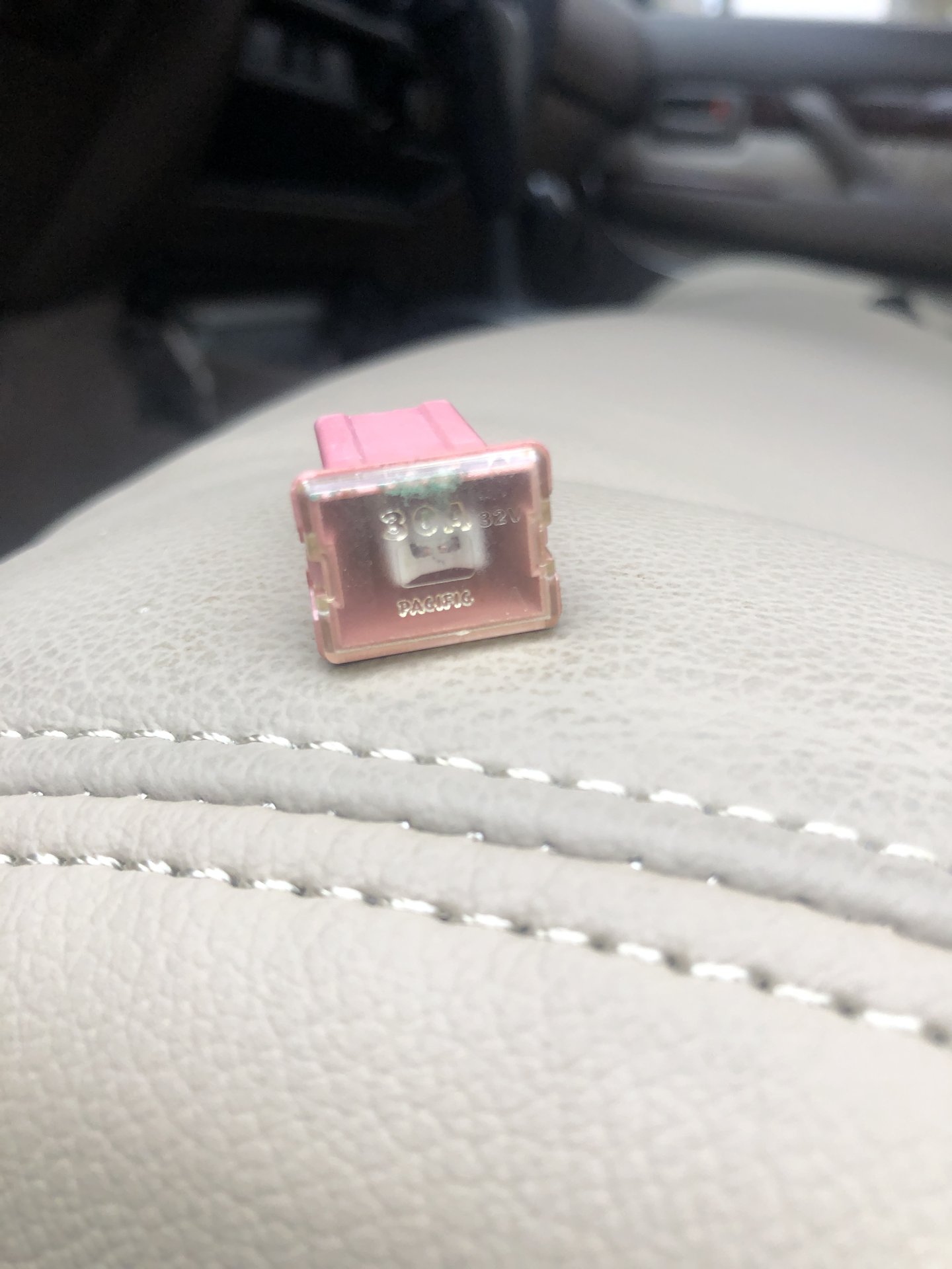

Need a replacement one for this amp on the dash. Is a replacement available at an o’reilly or autozone or do I have to get from dealer?
As @NLXACY said. Not available everywhere. 👍
Most NAPA stores carry them.
But if ordering online, be aware.... they come in both Male and Female versions. Yours is female (mini fuse).
