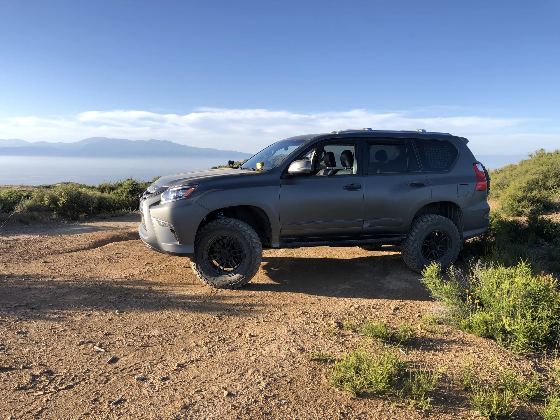

I got about 2.75 from Ironman medium springs… only weight on the rear is some of the roof rack and sliders

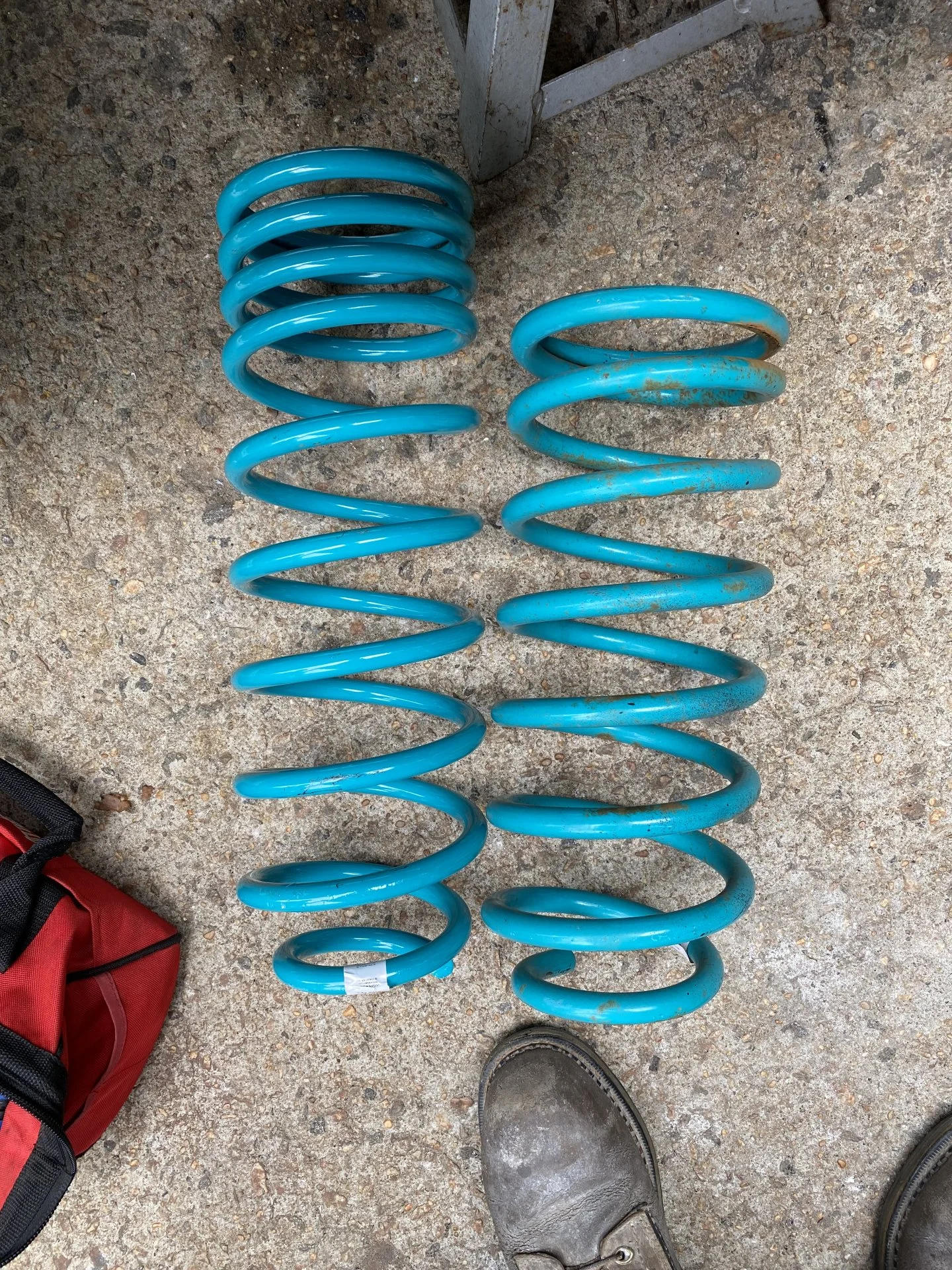

Just installed Dobinson C59-677V supposed to be 3” of lift. I’ll let you know how the go. Don’t have the rig back on the wheels yet, but I can say they were probably 4” taller than my previous Dobinson 1.75-2” coils, don’t know the number.
