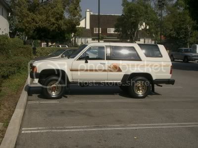

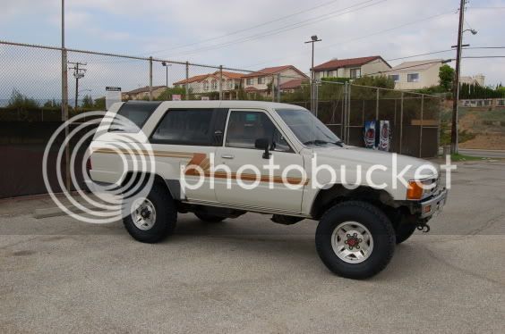

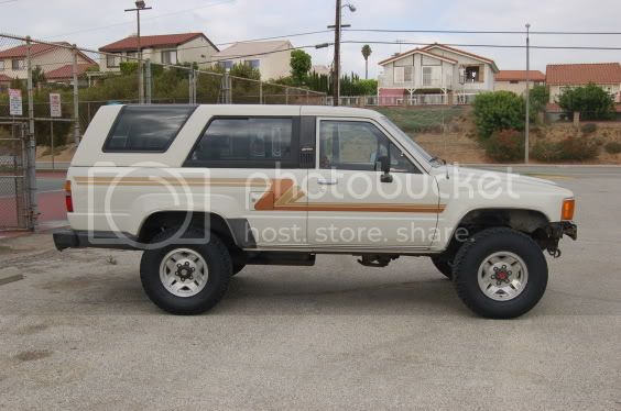

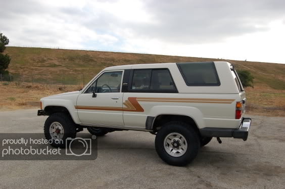

I just finished the install this past weekend which went pretty smooth. The install is about a :banana: to :banana: :banana: job. I am a newb when it comes to working on trucks. So if I was able to do this anyone can do it. The truck rides a little more stiffer now than before but much smoother. The addition of new 31 BFG AT helps a great deal too! I especially like the new to me SR5 wheels that I picked up from mud member Haddock. Thanks Todd for the wheels!
Before lift
After lift w/ new tires & wheels
Another
Last one
