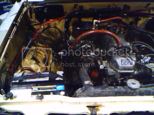

I picked up that 1980 Pickup a few days ago (got it for what i thought was a good price, way lower than what he wanted), it has a 10" lift, 35" BFG MTs, lockers, 35k on a rebuilt motor, and a few other things...

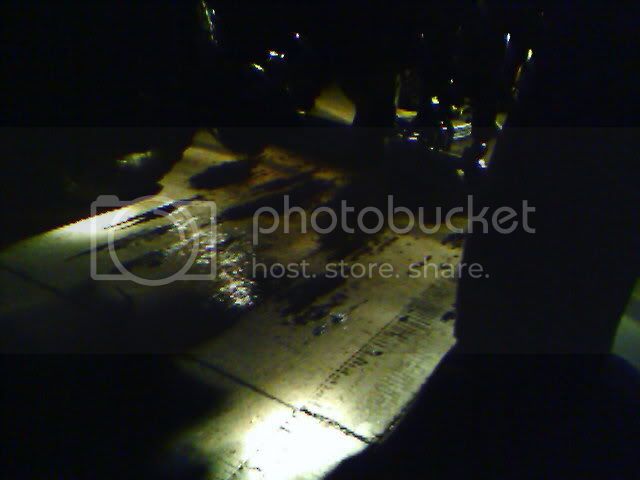

Two hours later we're driving down the highway doing 65 and I notice that I can't see s*** behind us, it's 100% smoke... we pull over and...
Sweet. Have it towed home and we start ripping s*** apart.

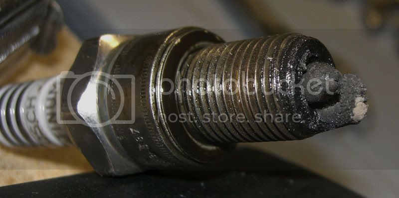

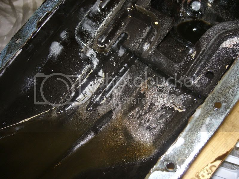

Turns out it was the gasket at the front of the crank, cheap fix - right? Oh wait, no. I start it up and drives it around the massive dirt lot beside my house and it starts rod knocking/spun bearing noise like ***k so..... s***. We pull the oil pan because I assume it's a spun bearing :cool:

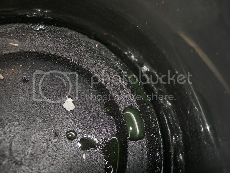

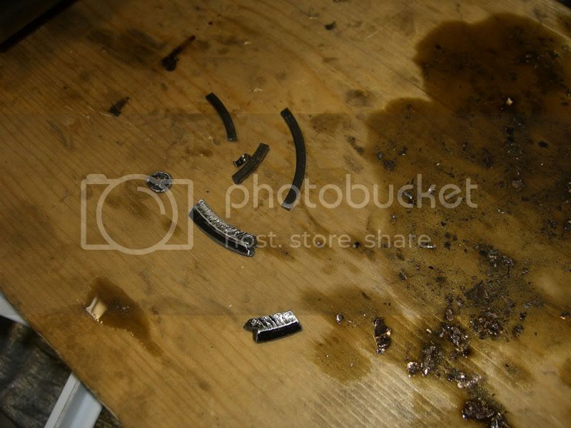

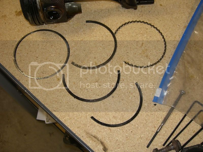

Oh, cool. God damn bearing s***, ring, and piston. Rebuilt engine 36k miles ago?

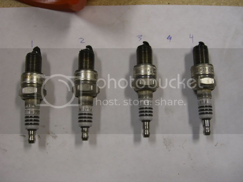

Wtf. Looks like cyl 1 rings (at the least) are screwed. Time to tear it apart.

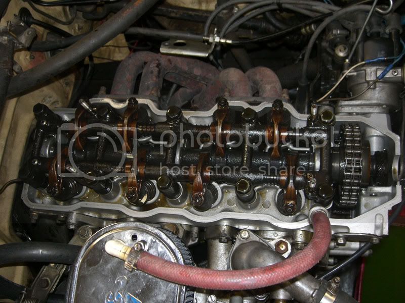

Valve cover off, cam looks scarred pretty badly.

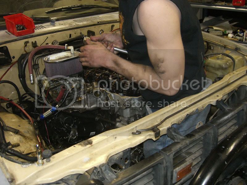

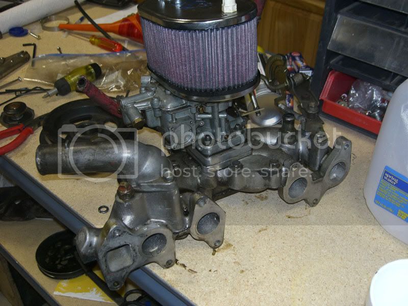

Pulling the intake mani off, someone ported the head. It has a 22r block with a 20r head.

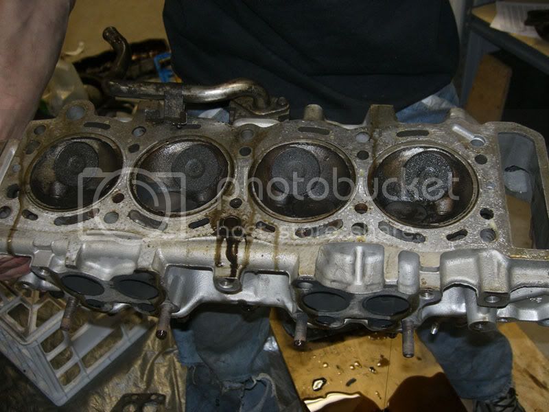

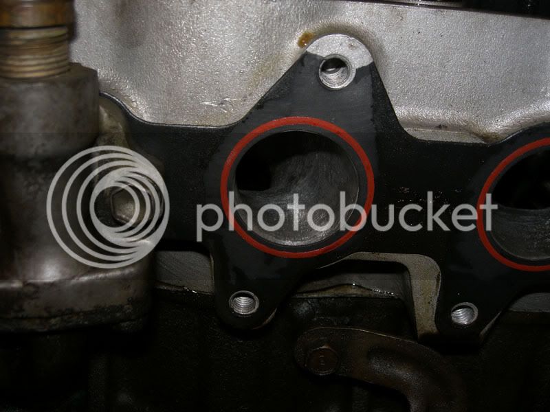

Head off. Well, that doesn't look good. Where is the ring?

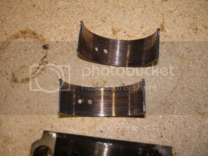

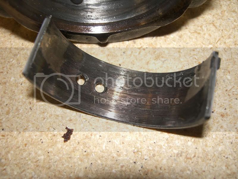

Bearing is eaten.

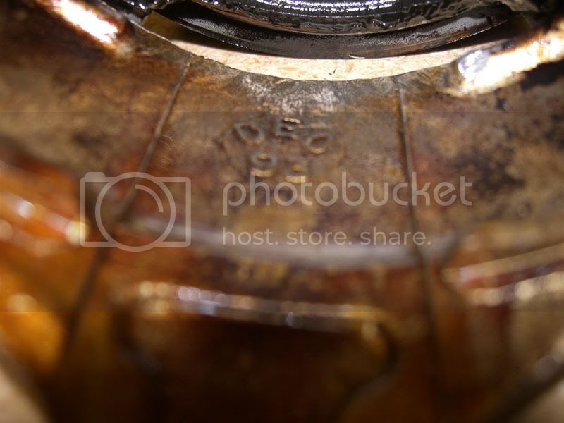

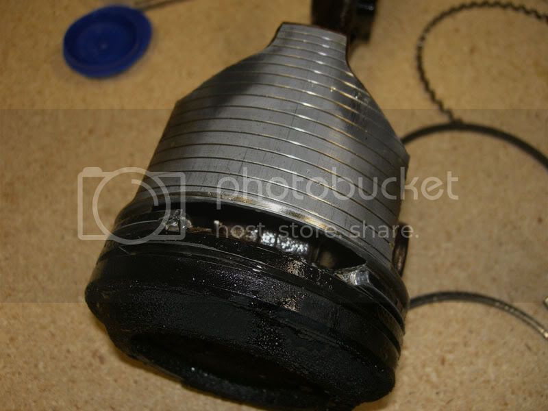

Fxxxing awesome. Yes, that's a hole in the piston. Oh, and the pistons are from 93 - according to the markings cast. 36k miles since 93. What the christ?
Bearings for piston number 4. Raped.
