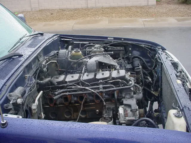

Well, I finally removed the toyota engine tonight, hardest part was dragging it up the driveway. I have some picts of the truck with the body lift, and a few with what I have done since last week. Unfortuantally, one roll of film did not turn out.. I think the sun got to it.. So, I will post some pictures later on this afternoon. Other than that.. im tired, So Untill then.

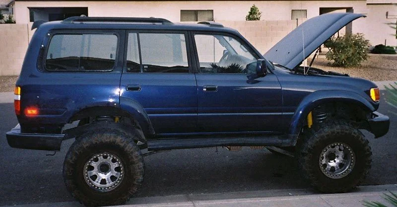

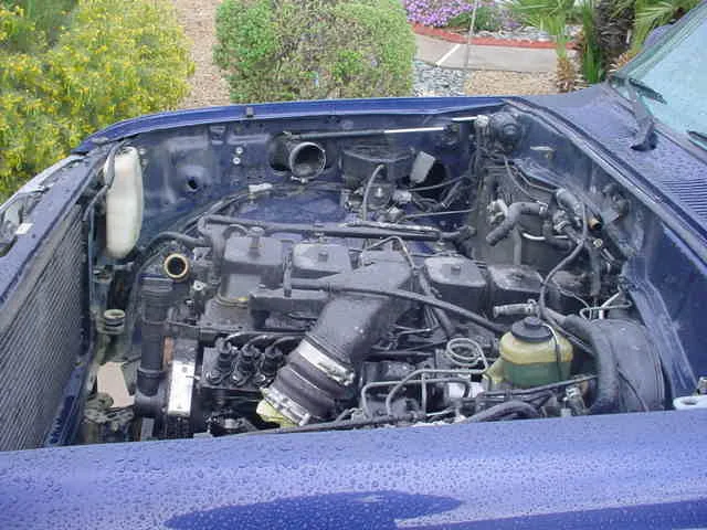

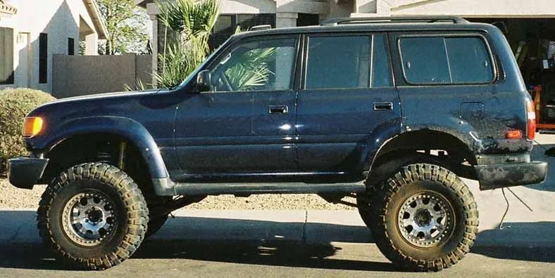

Here are some picts of the body lift after installation, You can see the gap is much larger in the rear now than it was before. Also picts of the engine.

Alright, Well I joined the board, and now have more room to spare. No picts of the removal yet.. Its a good thing I decided to do it last night.. Cause I dont think I could have done it as safe. I ended up using my neighbors dolly last night to wheel it up the drive way. If not, It would still be sitting on the side walk . One good think about the rain though, .. Is that it wont look like ive been working on the road with spilled oils. All washed away with some tide detergent. Ill get some more picts of the engine removal by monday or tuesday. as well as some new close ups of the body lift.

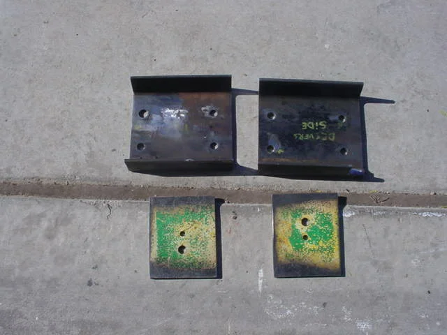

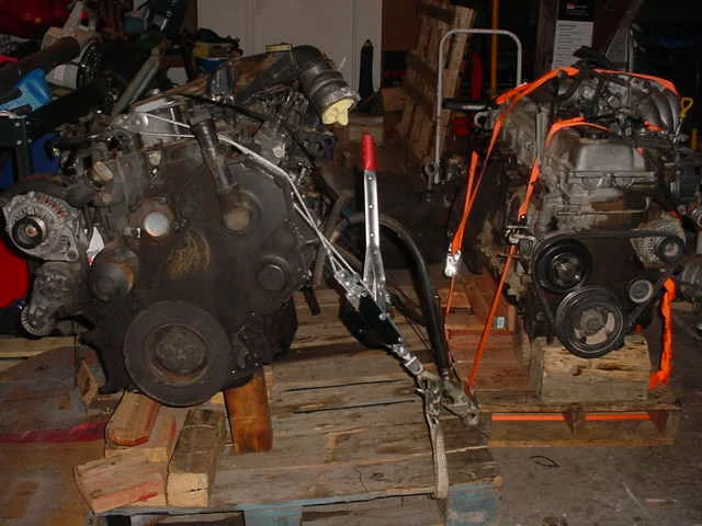

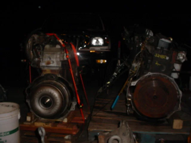

I wasent able to do much yesterday on the occasion of Rain, I was able to make a pallet to hold the toyota engine, And I stripped the Cummins of its un nessary parts to lighten the load a little. I am however, In need of custom motor mounts. I think 3/8"- 1/2" Steel Plate will do for this. When Ill beable to get to that, I do not know.. But as soon as the Mounts are fabbed up, I can drop her in and go from there. Id like to do it myself, But Im not much of a fabricator. If anyone knows someone good, Id appreatiate it.

Its really not, only about 3 or so inches higher. Plus, in the pictures, Its sitting on a larger pallet. Im working on the motor mounts right now. Got some scrap steel stock from work, So tomarrow Ill have to cut them down some more, test them again. Ill know tomarrow night if they need to be shorter or notched. If not, Ill drill the holes and start on the side supports. If all goes as planend, Ill beable to weld and mount the engine this weekend.

Well, I wont beable to drop the engine in this weekend, due to the fact that I dont have the engine mounts finished. Ill have to go into work early next week so I can finish them. I have the Engine plates done, But I still need the frame plate and the connecting plates.
Right now, I do not know what I am going to do with the engine/tranny/transfercase. For now, Im going to sit on it.
Well, Plans have changed, and I will beable to drop in the Cummins this weekend. I should have picts sometime during the week. Spike let me use his shop, and I finished up the mounts. Tomorrow well figure out how we can get this all to work. Heres a pic of the empty engine bay untill then.
Well, Unfortuantally, My motor mounts didnt work.. though the engine and transmission are in. I think I will have to possibly cut the old frame mounts off, and weld on new ones. I dont know how Im going to do that.. but Im sure Ill find away. Fortuantally, there was not too much rain fall were I live, just a sprinkle every now an then.
Here are some picts of what she looks like.
You still gonna be able to use the mounts you fabbed?
Maybe you can remove the frame mounts so that they can be reused.
