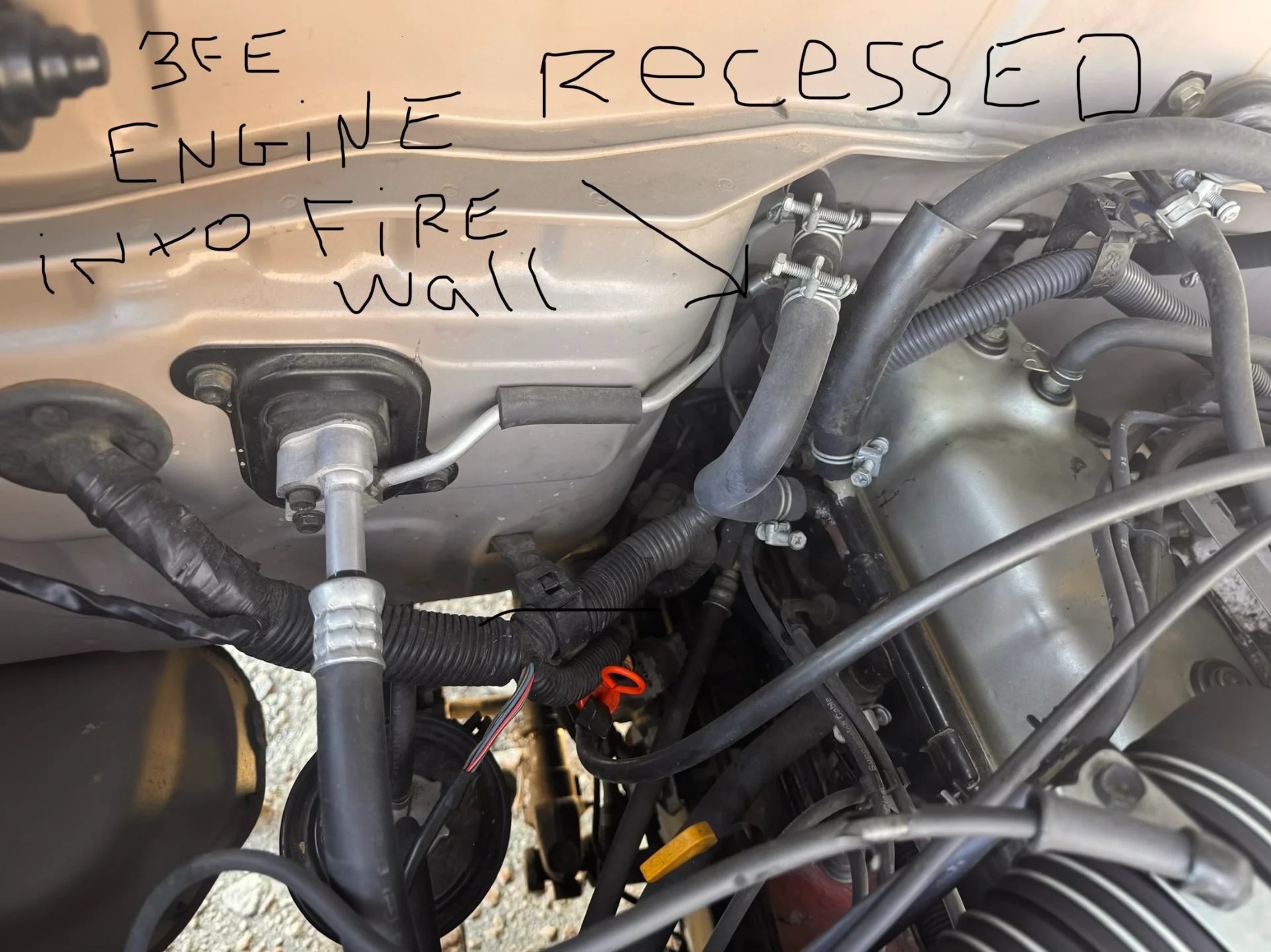

Hello all. Working on a 1991 FJ80L-GNPNEA. It is bone stock aside from OME suspension, ARB bumpers, and the Nomad valve body. It has a 3FE engine and an A440 transmission.
I’ve been hunting for the bell housing Toyota made to Bolt the 2UZ to the A440 transmission (PN 35111-60110) and finally found it. My question is….
I’m sure someone has done this swap so a few questions:

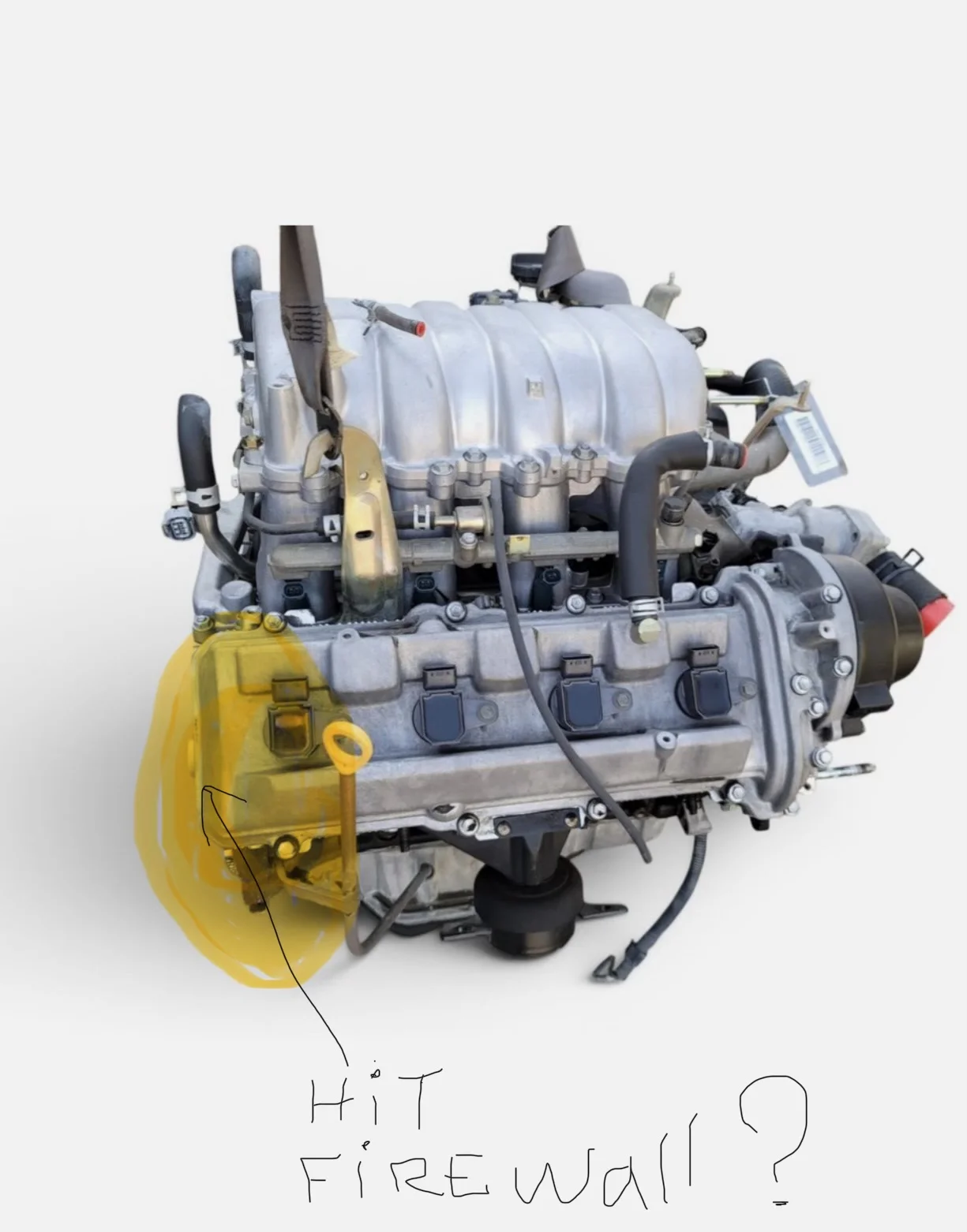

Does the 2UZ engine clear the firewall when bolted to the stock transmission stock location? Looking under the hood of my truck, the 3FE engine recesses back into the firewall. Referencing photos I found from eBay. It looks like the back of the 2UZ motor is in plane with the back of the valve covers. I don’t want to have to bash my firewall for clearance. See attached photos.
Will the A440 torque converter bolt to the 2UZ flex plate?

If you haven’t found this yet it’s going to help you greatly…. While most of it is based on the FZJ. There is a link to another thread I think that will have the info your seeking
Your going to need engine mounts and trans cross member the 1fz and 3fe are set to the driver side a good bit. The UZ has to come forward about 5- 51/2 inches and shift passenger a little bit.
These are very good and what I used for my truck. Very well made and puts the UZ right where you want it
