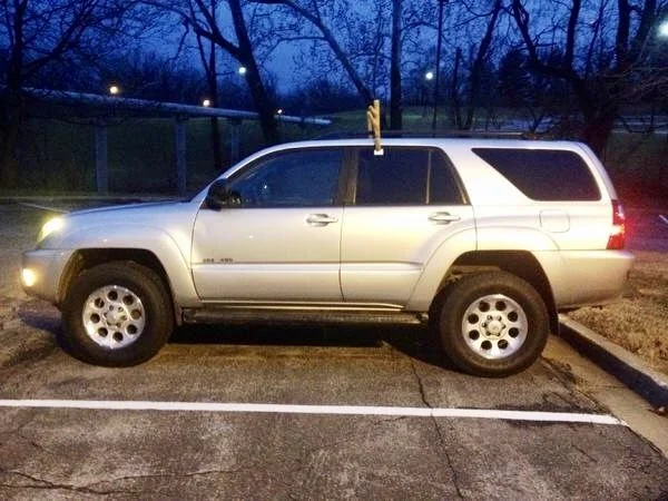

Ps, this is what my 2004 T4R looked like after the taco swap. Not bad really for $50.

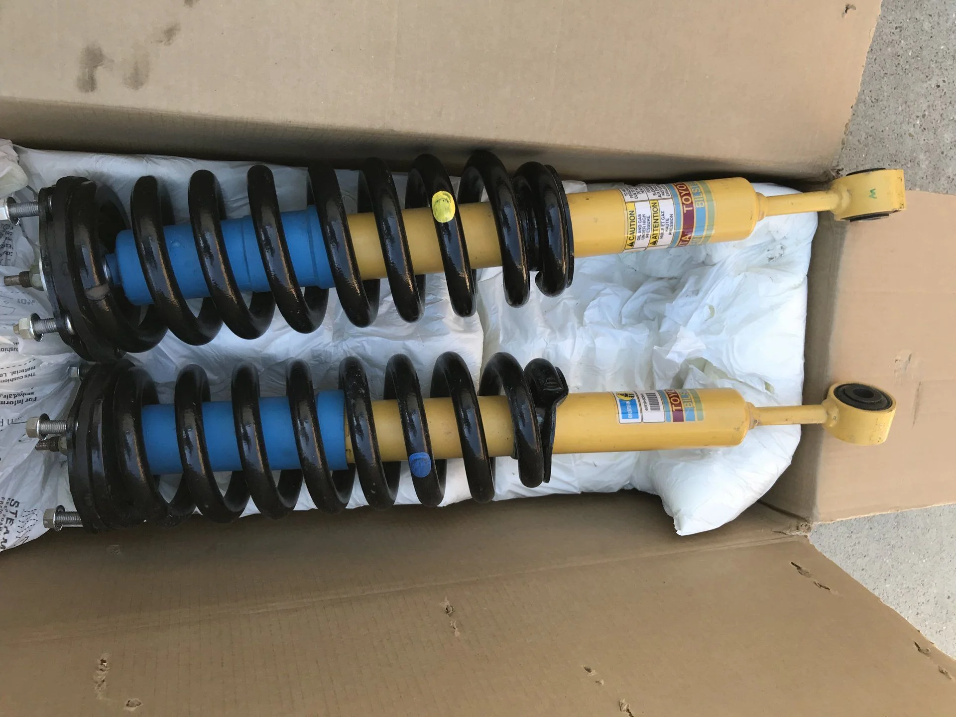

Working on getting a set of 2018 Tundra TRD Off-Road coilovers and rear shocks from a buddy of mine. I prefer to use the Toyota bilsteins (yellow & Blue) so I’m holding out. He should get his toytec kit in soon and will have his oem components swapped out within the next two weeks. I’ll keep this thread posted with any updates.
Update:I ended up just getting the front coilovers because when I compared the rear shocks to each other and the sequoias have a welded eye mount (top and bottom) and the tundra’s rear shocks only have a single eye mount with a top nut on the upper side.

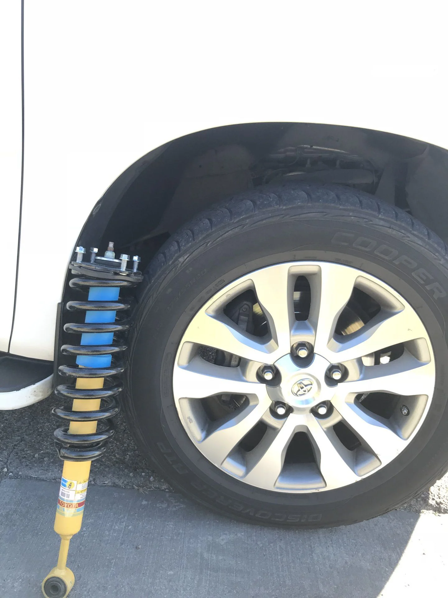

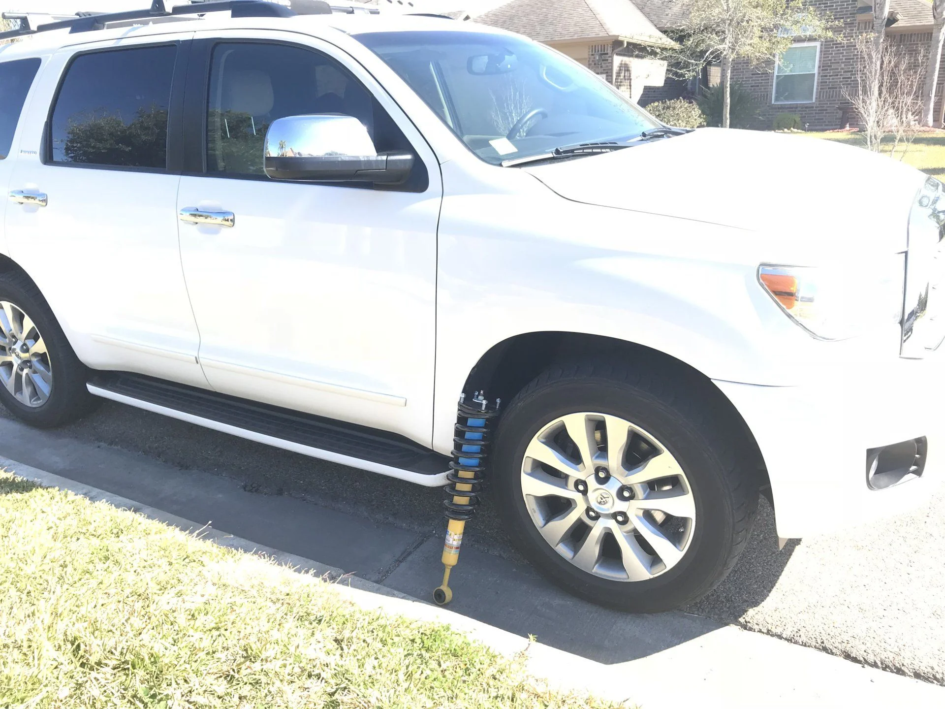

Done with the Tundra front Suspension Swap and I’ve got results... (BLUF: 1.25” front lift!)

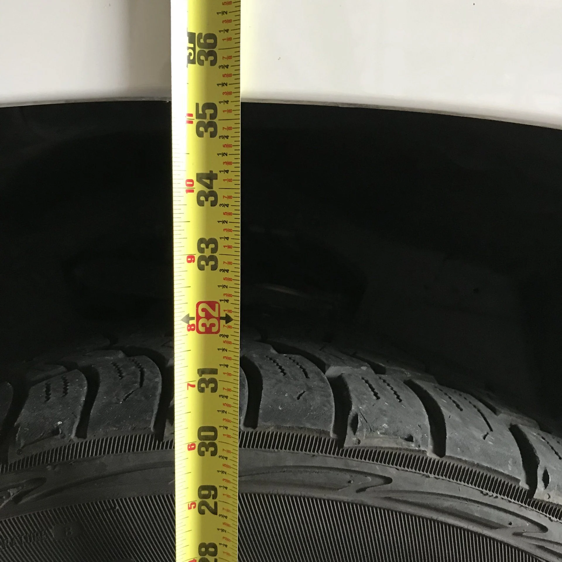

Before measurements:
-From ground to fender 35 & 1/4”
After measurements:
-From ground to fender 36 & 1/2”
My Vehicle specs: 2010 Toyota Sequoia Limited. Stock rims with 275/55R20 Cooper ATPs. 107,xxx miles on original OEM suspension.
Donor Suspension Specs: 2018 Toyota Tundra TRD Off-road front strut (coilovers) assembly. 1,000 Miles
The idea is to be able acquire a low cost OEM lift for those that are just wanting bump up the front end of the 2nd gen sequoia on a budget. IMO it has a nice leveled look. I might actually go for a protune 1” rear spacer ($79 Amazon) for the rear springs. Ill have to see how it looks. I’m definitely ordering the 5100s for the rear shock replacements.
After measurements:

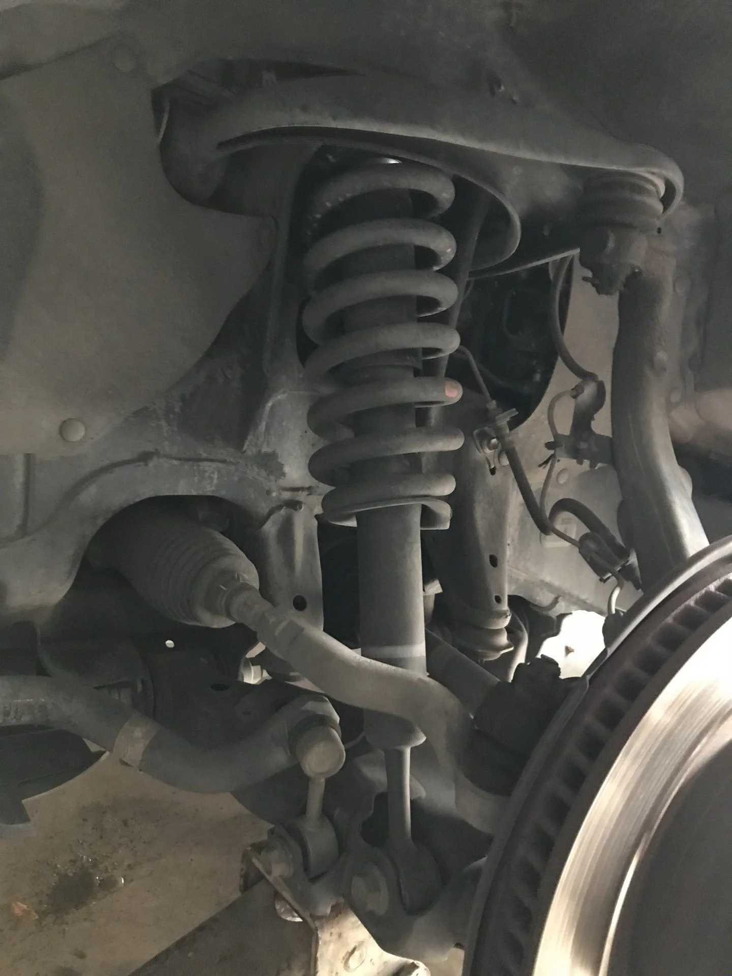

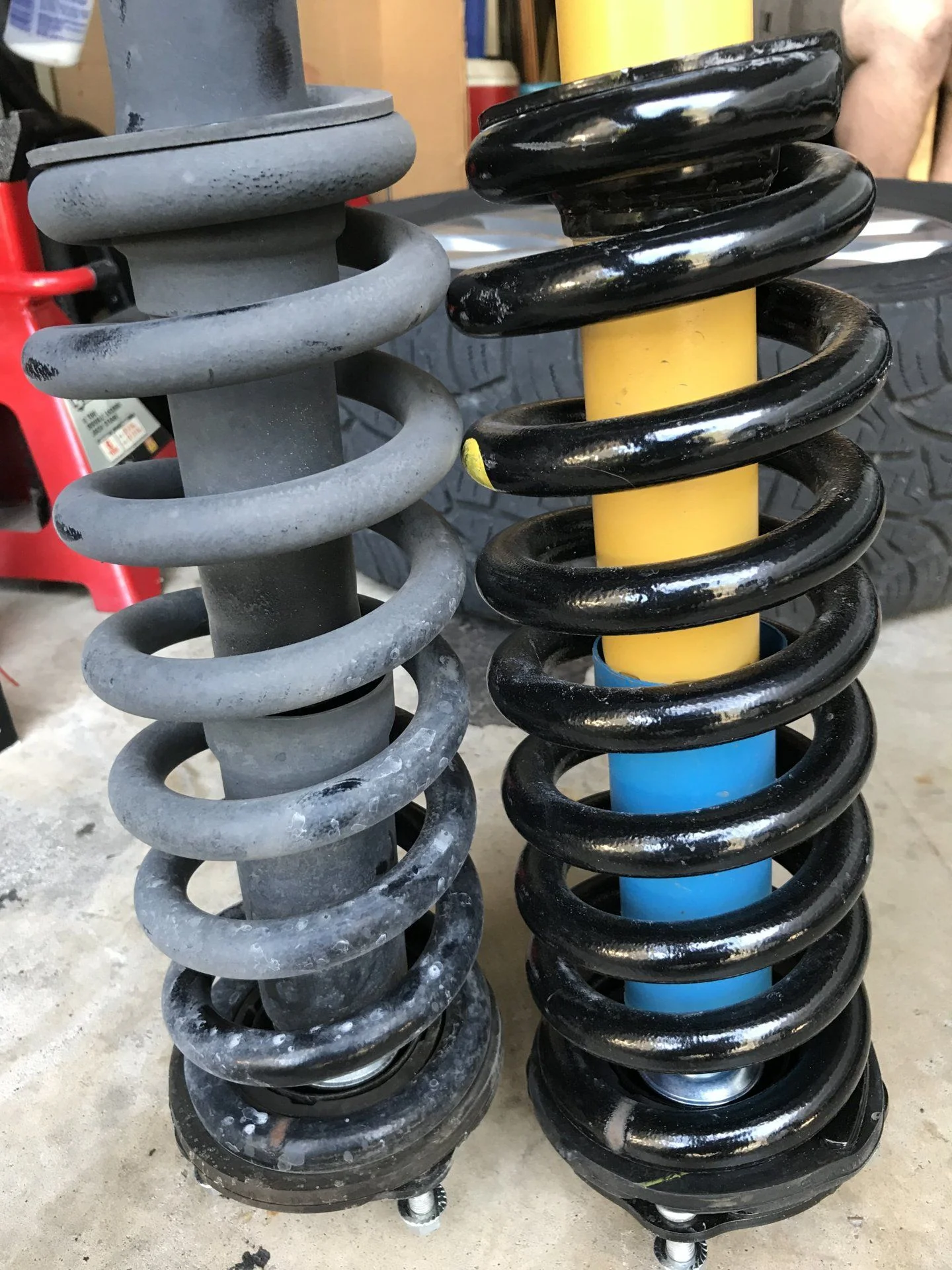

Old clapped out components...

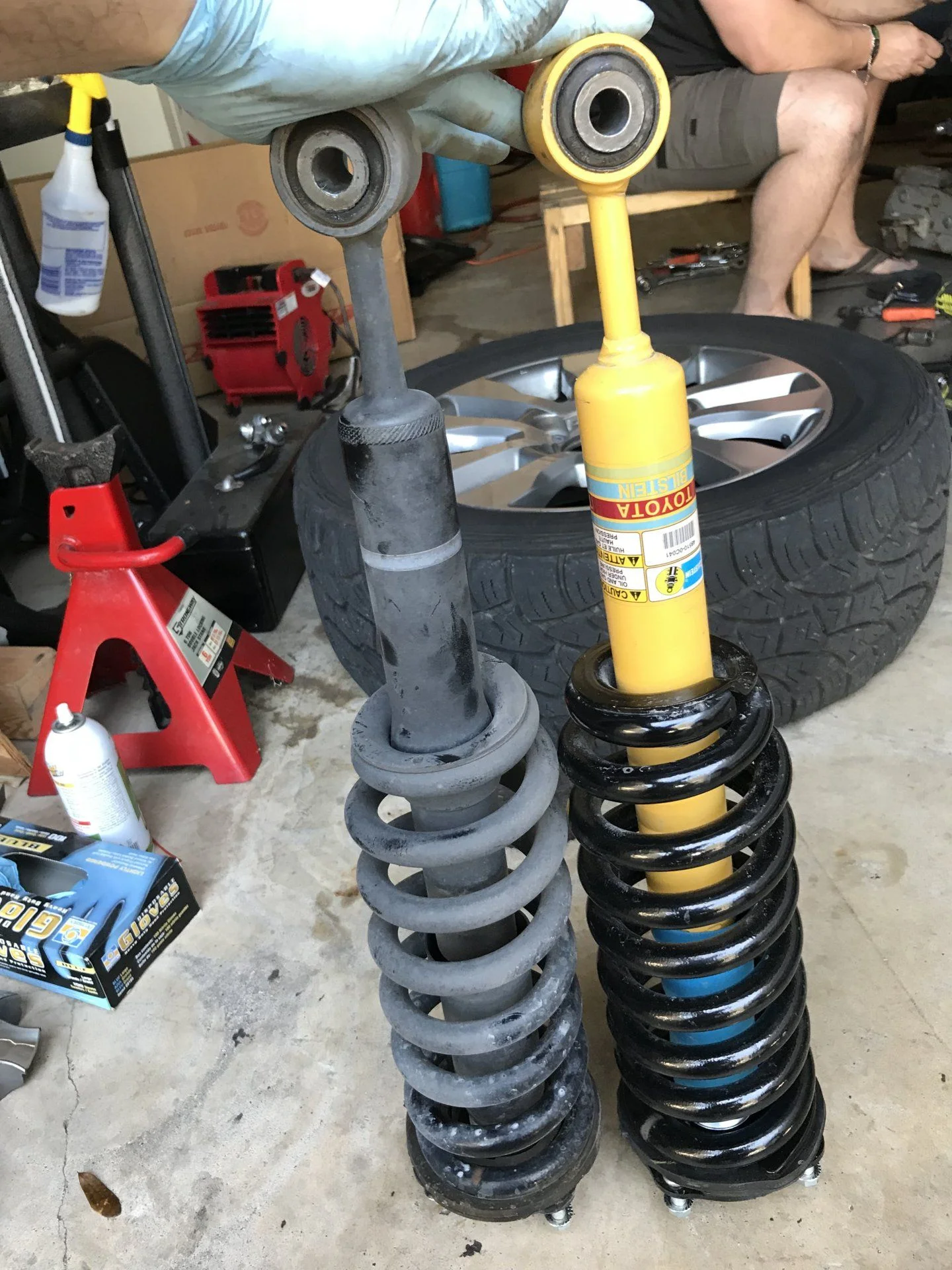

Old and new... next each other
Same height but definitely not the same load rating...

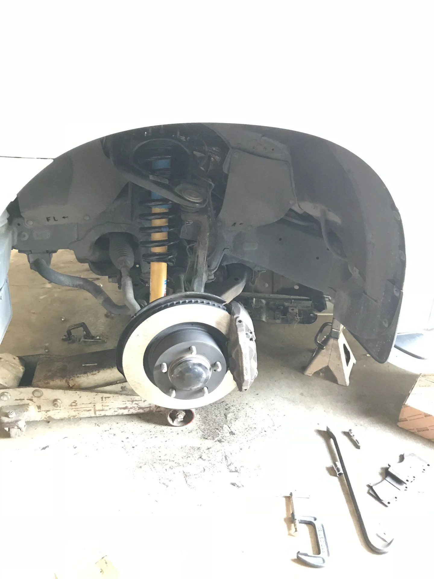

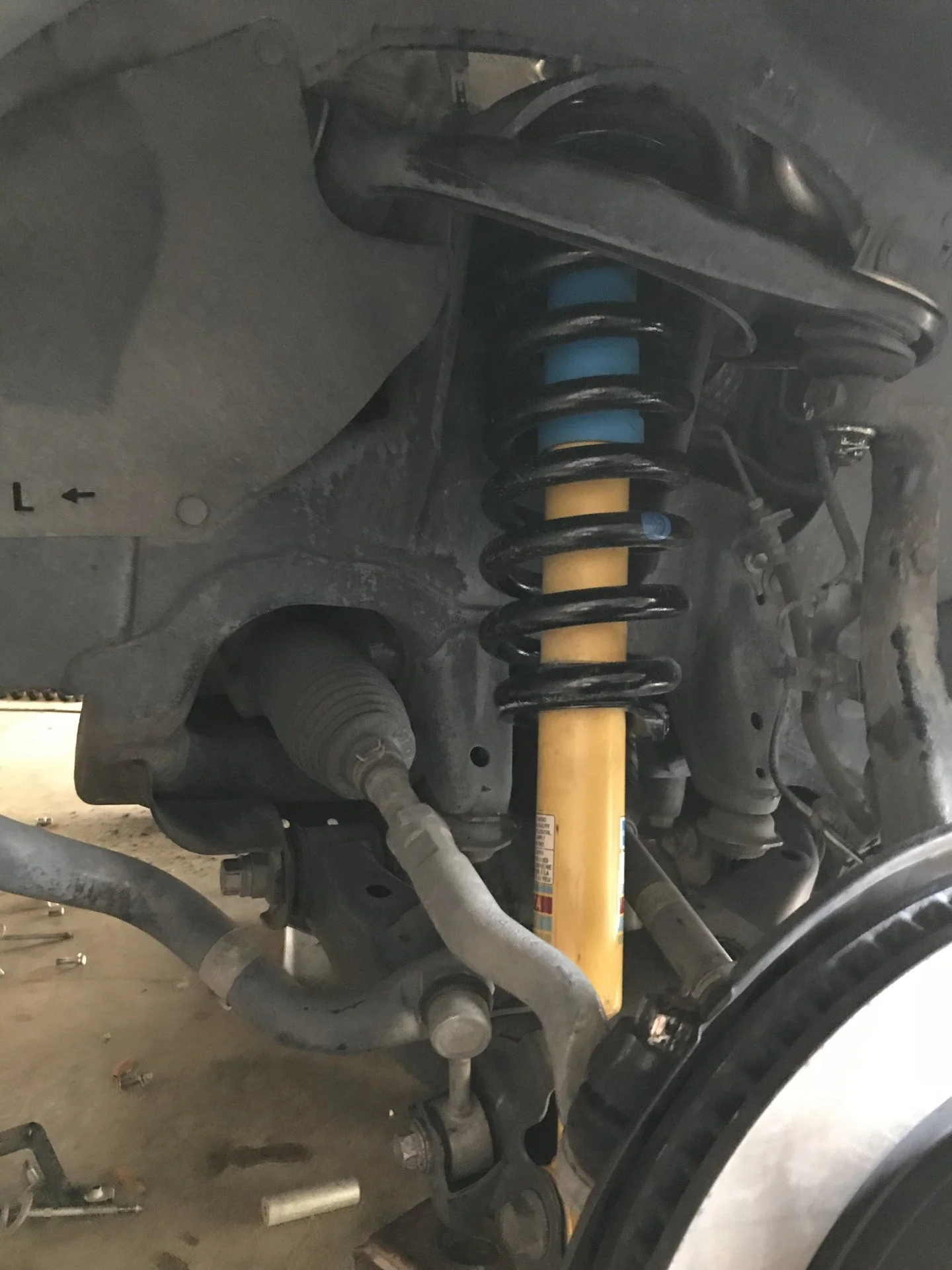

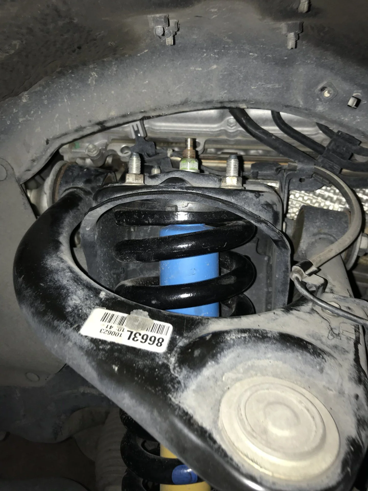

And the new TRD Offroad sus components installed...
@MojoCruiser Looks good. Do you have any full photos of the Sequoia before and after? Just curious to see how it looks. Nice work.
Good question, I wish I would’ve been more intentional in the before pictures but let me see what I can find. I will post some after photos for sure. It’s been unusually bitter cold in South Texas lately. Of course, it’s not a seriously drastic difference but in my opinion it does look a little nose hi for me. Going to order a 1 inch spacer I think when I replace the rear shocks with 5100s
