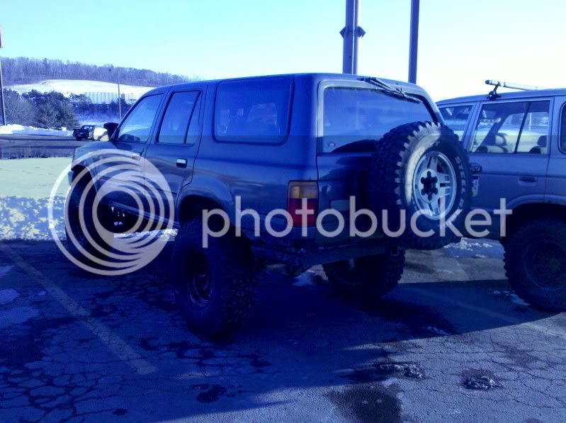

The 90 I looked at yesterday was nice...frame was solid, body was fairly clean. The guy just put a 3 or 4" rough country lift, new wheels, new 35's and an aussie locker in the rear a few mnths ago. He said it has the stock gears but says they are 4.56's. I thought the 5speeds came with 4.10's and the auto's came with either 4.56's or 4.88's?????? Anyway it ran good, it felt strong and pulled great through the gears like it had lower gearing. I have had a few mini's and 4runners on 35's and they were dogs with the stock gears.

Here is a pic
If it came with 31's and a tow package etc... than it would have 4.56's.
