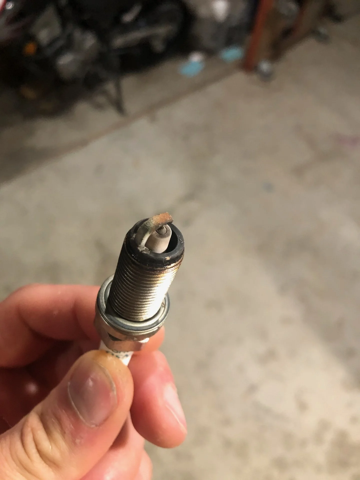

2nd cracked spark plug - why?

If a cylinder runs lean it can do that. Maybe you have a dirty injector. Haven't seen that on the 200 before.
Could have also been a bad batch of plugs, but I'd guess clogged injector causing detonation.
Wouldn’t the ground strap show evidence of detonation if it was bad enough to crack the porcelain?

I can’t find #8. I thought I threw all of them in a box but 8 went AWOL.
Yes. The ground strap on his #6 plug appears to show evidence of a lean condition, but hard to tell from the pic.
#6 looks pretty dark on the strap to me and the point is also dark in color. I thought a "clean" or white spark plug was the tell tail for the cylinder running lean.
A slightly lean will be clean generally. A very lean condition will look similar to #6 above. Here is a handy chart.

For 150k that's not bad looking. No plug will be pure and clean after 150k. A chart like the one posted is great.
A good rule of thumb going forward is if one plug goes bad replace them all. Now if you recently replaced them all and the same one goes bad again before the others then you need to do a little trouble shooting to get to the problem.
