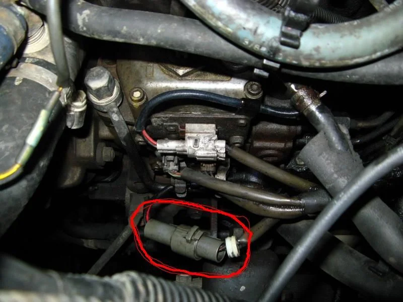

Hello! I need some help once again. Today I stopped at the gas station and I was shocked. For 385km I needed 70l of fuel. That means 18l/100km or 13mpg. I came to the point, where my injectors are redone, fuel filter is new, no drag on the wheels, no oversized tires. Can the injection pump cause such a bad mileage? I had somebody take a look and he was mentioning the grey connector on the picture is probably causing the problems. He also said, the pump is leaking. He also told me to turn the pump about 2mm clockwise from the marks for timing.
My question is, can the pump leak into the engine? I get smoking start ups even 1 hour after stopping the car.
Does anybody have a description for the pump? What is the grey connector related to?
I think, this is the right time to change the pump... :frown:
Thanks in advance!

well i just check your truck,it has lot of blow by on the breather! what does this tells you,even though you have 480 psi cranking pressure,does not tell you,your engine is in good shape. the connector is for injection timing control.blowby mean the engine internal need attention.simple as that.
