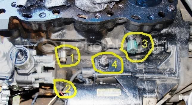

Hello everyone, My names David and I'm doing a bit of a re and re on my LJ78. (Its been sitting around for about a year now) I'm hoping the little 2L-TE lasts me at least another year and half until I'm done with university (fingers crossed), then I will have more money to replace the thing. Anyway here's my question:
Regarding the installation of an aftermarket water temperature sensor.
In reference to the image below:
1. As I understand this is a coolant drain plug. (1)
Can I relocate the factory water temperature sensor from the thermostat housing to the location of the coolant drain plug?
If so then i would like to put the aftermarket sensor in place of the factory one. If this is not possible then I will just remove the factory temp sensor and leave the drain plug alone.
Thanks :)

1. Block drain
2. Crank position sensor (or that's about the right location)
3. Temp sensor for computer (controls fueling, glow time, trans operation)
4. Starter main power connector
Either remove the factory sensor or drill and tap for a new one. There are small sensors available that can go in to a 1/8" NPT hole.
If you need help with parts call us.
Good luck with that thing, they can be real money pits.

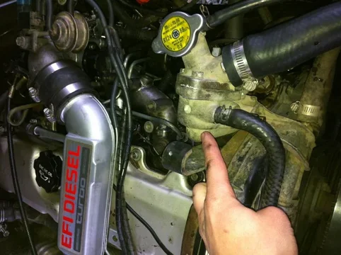

The gasket on the thermostat housing (engine side) is leaking. I'm having a bugger of a time getting it off to replace it. Should it just pull strait off?
Thanks again everyone for this awesome info!!

Redd has some great ideas in his post with regard to improving the cooling system, but I highly recommend also doing everything you can to prevent the heat in the first place. The heat is directly related to EGT's. Keep the EGT's down, and the water temps will also stay down (assuming your cooling system is functioning at least normally).
The side of the thermostat housing with the rad cap and hose that goes to the radiator is the part that comes off. Take out the rad cap and give the housing a gentle wack with a rubber mallet. It should break the seal and then come apart easy.

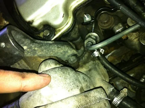

Hey GTS,
Unfortunately it is leaking on the side that should not be removable.... I think?
Just above my finger, in between the block and the non removable side of the thermostat housing.
