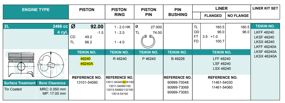

Piston: Teikin 2L piston kit / 46240
Rings: TP Ring kit / 13011-54060 / according to reference
All the work was done on the liners according to the piston used
My problem became after 5 months(5000km), same problems of compression and oil burning, blowing out oil from dipstick so i decided to change the rings brand (probably some bad luck factory failed :hmm: )
So i put some NPR Rings (13011-54060) and failed again
