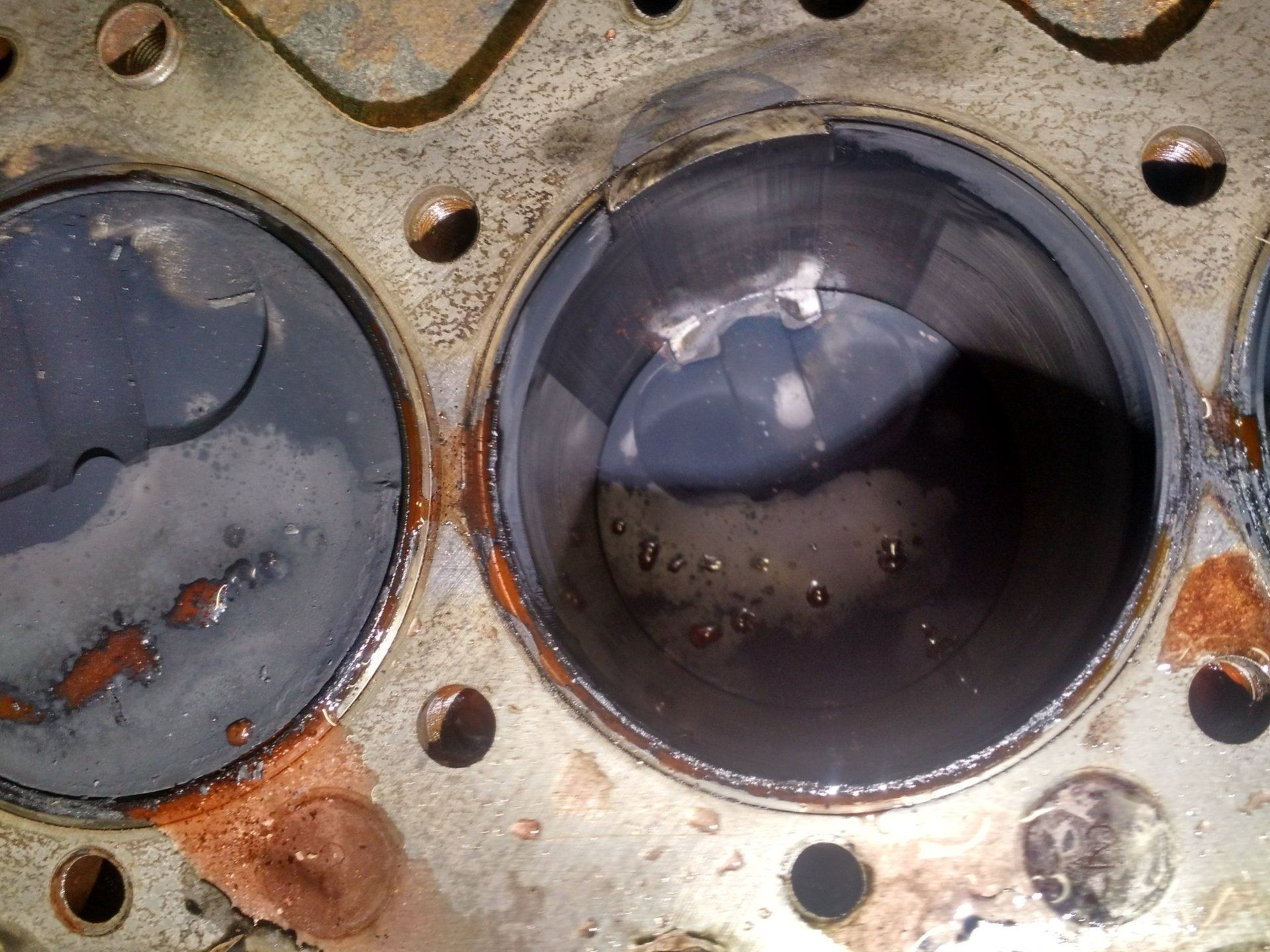

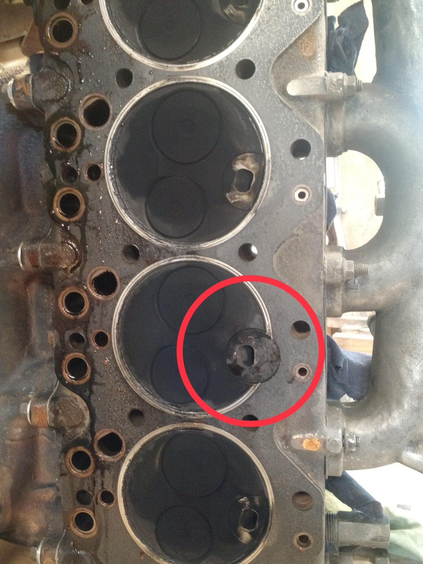

Metallic Tick tick tick. right after a rebuild, machinist decked the head with pre cups installed when they are supposed to be slightly proud and firmly compressed in place by the head gasket.

Pre cups are only able to go in the orientation they are supposed to.
They have a sung but not super tight fit and are held in place pinched between the head gasket and head.
The problem is if the pre cup holes aren’t completely cleaned of carbon before new installation they will shake loose. planing a head with a high pre cup sitting on a chunk of carbon will cause the issues seen in the pictures above. the pre cup will shake loose and rattle into the piston top till it mushrooms the edge enough it scores the cylinder wall sleeve top to bottom and you need a second rebuild after less than 10,000k.
