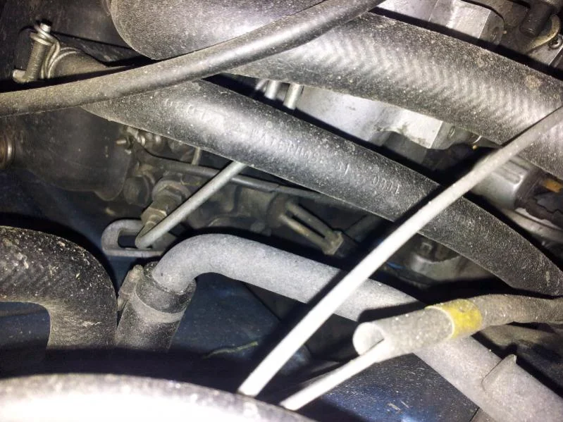

On my 2H block, the block heater is plugged in pretty high and right at the firewall. I don't see the freeze plugs or maybe don't know what they look like to see them, but I traced the wire on mine and it went somewhere so difficult to see that I had to stand on a stool just to see it!
I tried taking a pix, but man, even with the iphone deep in there, I could not get one off, sorry! There must be a place there (right behind the valve cover towards the firewall) that is meant for block heaters. I haven't tried if mine works, but it does have continuity, which is a good sign I guess :)

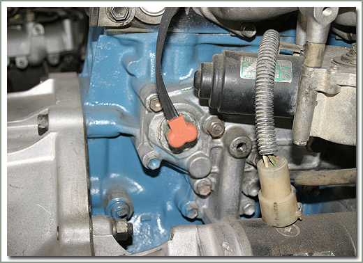

Based on the Temro catalog, it should be on the right rear (when sitting on the truck) (See page 25 here). So in the picture with the yellow circles it will be the on the left...

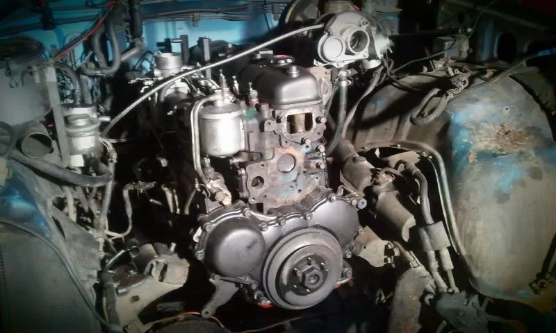

The plug i used is on the passenger side, right behind the intake manifold. On the picture of the hanging motor to can barely see the end of the plug.
Snapped a picture too, you can barely see it.

So it will be the freeze plug closest to the torpedo wall that I circled out in yellow ?
Yup, correct! Pita to get in there.

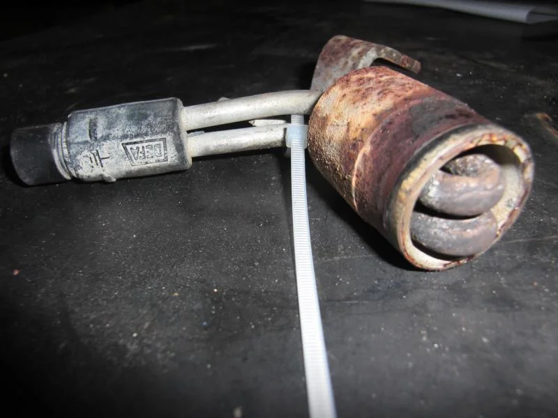

2H from sweden,block heater mounted in the last hole on passenger side.
Block heater 30mm diameter.
