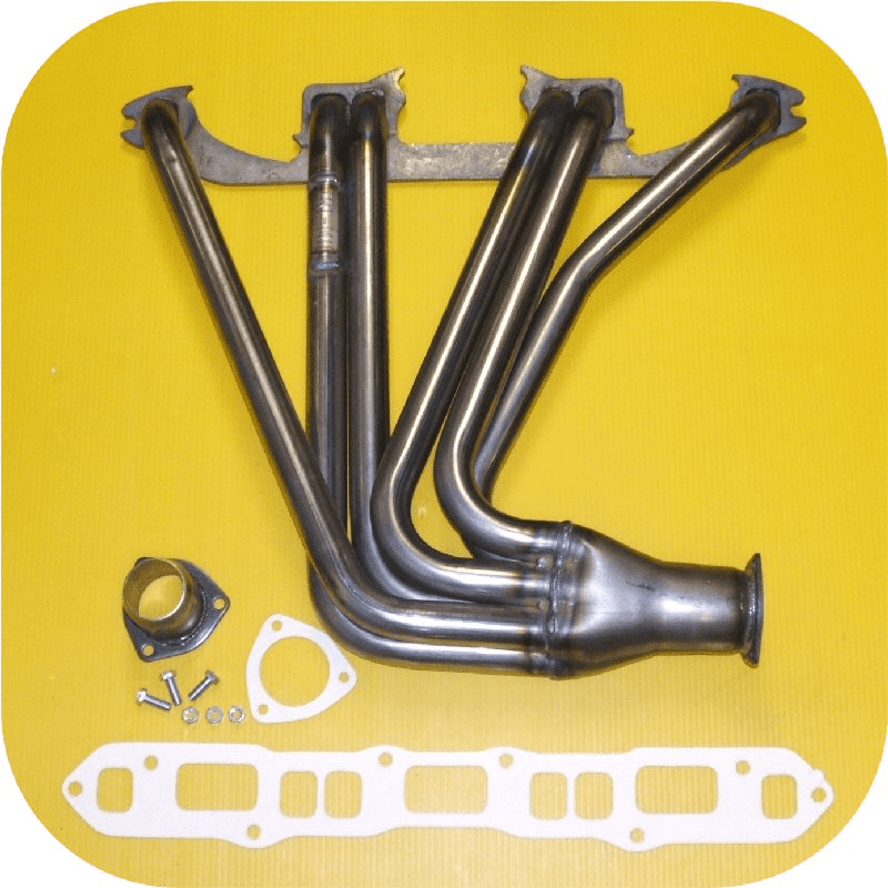

Tyler, while likely not the HP gain you are looking for, I have in my possession a header and Weber carb for the 2F. The header looks a lot like this one....
Neither are Ca smog legal so if you are interested let me know. Otherwise I will probably put them on Mud or something.

That header has my interest. I'll txt ya
