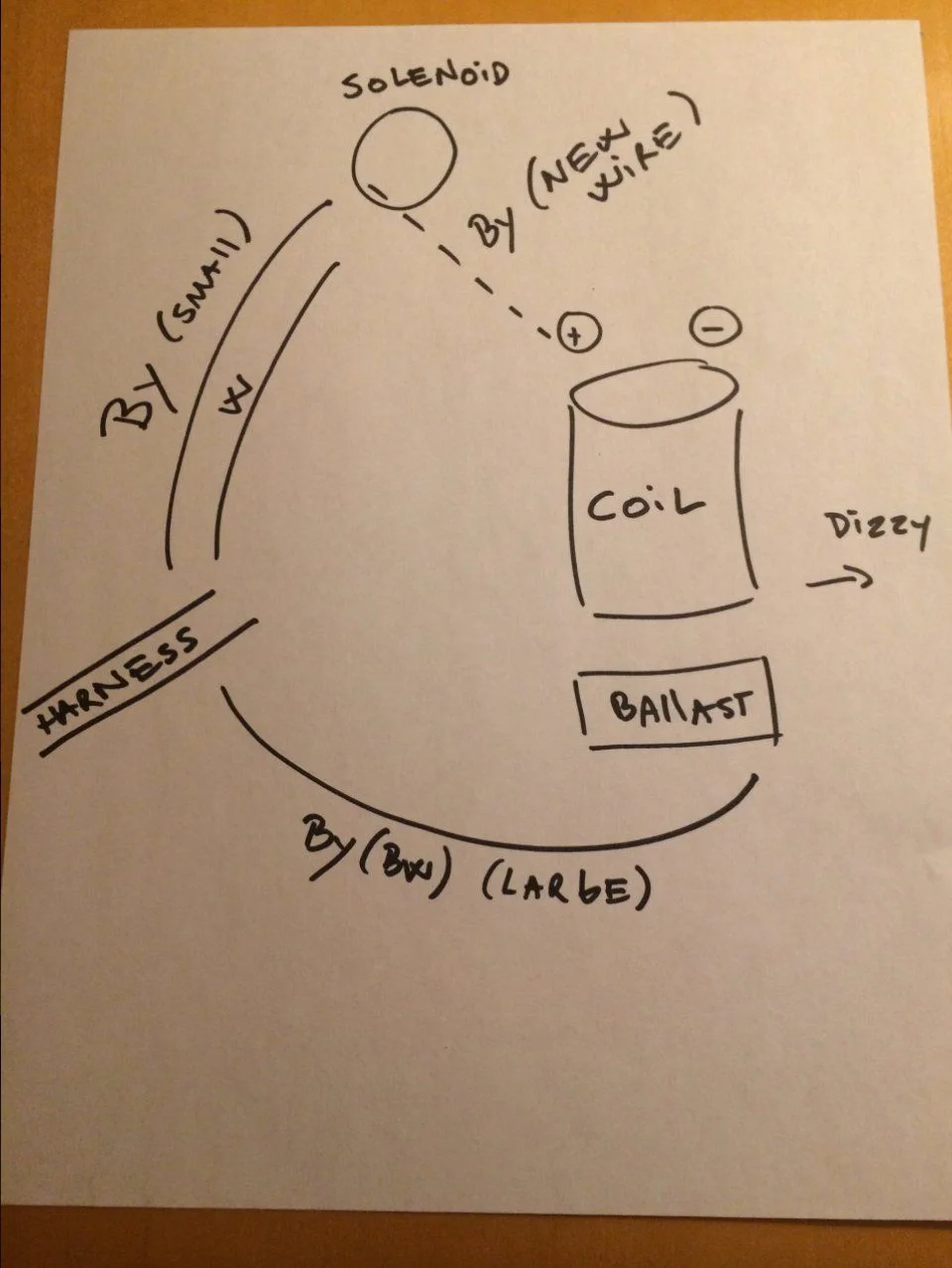

I am having problems figuring out how to hook the stock 70 harness up to 78 ignitor and dizzy.
1. So far only thing I can figure out is hooking free BY to + side of coil
2. Assume red and white wires from ignitor goes to dizzy (have to modify wires)
3. What other connections? All the wires from ignitor are already hooked up to coil.
4. Do I need a BW from solenoid to + side of coil too?
Is this a setup worth hooking up, or should I do something else? Need simple and as stock as possible.
Thank you!
If you have a B/Y wire from the solenoid, it goes to the + side of the coil. The larger B/Y wire goes to the side of the ballast resistor that the ignitor connects to which is the opposite side than the one connected to the + side of the coil. You connect the distributor to the ignitor and it should run.
If you don't have the solenoid wire, then just connect the larger B/Y wire to the ballast resistor opposite from where it connects to the + side of the coil.
Maybe, but I can't really tell the necessary details from your diagram. The main power to the ignitor/distributor is a larger black wire with yellow stripe that comes out of the wiring harness. The colors may be faded, so peel back the harness wrap for a better look. It is hot in the Ign or run position of the ignition switch. This connects to one end of the ballast distributor along with the power for the ignitor. The other end of the ballast connects to the + side of the coil.
Most cruisers of that vintage also have a "ballast bypass wire" that in BY that runs from a connector at the starter solenoid to the + side of the coil. It is only hot during engine cranking.
I checked the 1970 diagram again:
1. BW large wire goes to solenoid
2. BY wire small goes to + on coil
Does this mean i should run the small BY to ballast since BW must be hot on cranking only?
The BW wire that attaches to a spade lug of the solenoid is the start wire from the ignition switch. It has nothing to do with your distributor.
The small BY wire that connects to a wire coming off the solenoid is the resistor bypass wire. You can skip this wire or connect it to the + side of the coil.
There should be a larger BY wire from the engine harness that is hot with the key on that used to connect to your coil. If you have the other end of the 78 green plug, you could connect it to the 78 ignitor. You could also use crimp on connectors to plug this wire into the connector with two wires that does not go the the distributor. Alternatively, you could connect it to the ballast resistor where the ignitor also connects which is opposite from the + side of the coil.
