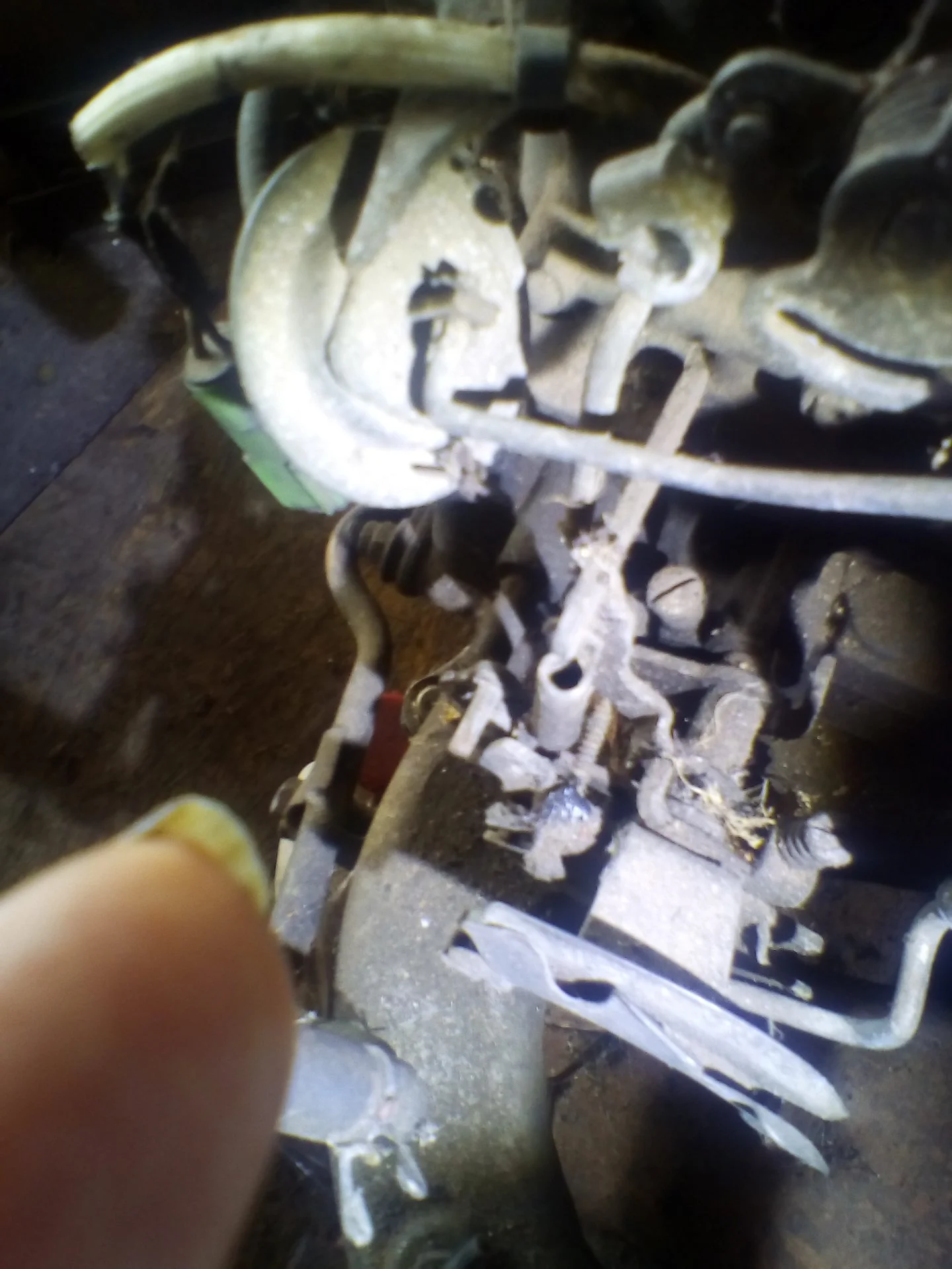

or you can cheat and mechanicalize it. The self tapper next to the spring in the pic opens the secondaries at about 1/3 throttle. I actually like it like this, so I left it.
