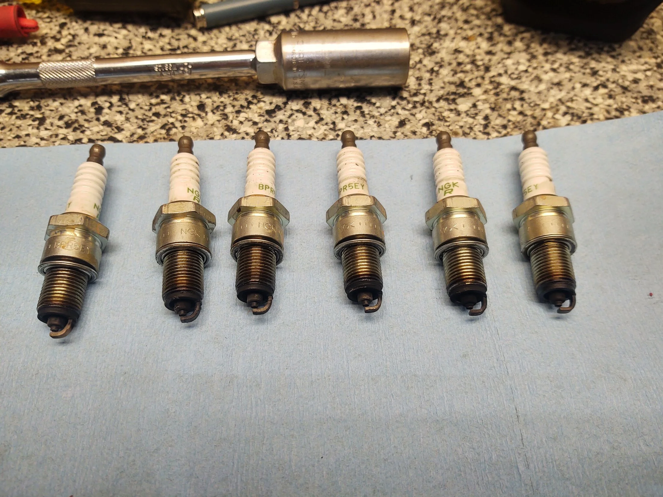

gonna check the plugs this weekend and yes a full valve adjustment on a warm engine.
That's a funny thing too. I have recently done the infamous timing cover seal leak reseal and read a ton on that! So I did a pre and post warm up adjustment. With that being said I adjusted the valves twice when doing my post purchase baseline tune up. Like it burned off some stuff off the valves and came out slightly out of adjustment? or I just didn't get it right? wierd!
Reference pics
#2 & #5?
Should I gap these for USA 1.0mm or world .8mm since it is desmogged?
It seems to not be lean (plug reading) or a vac leak (plugs and manifold-vac.).
I thinking that oil is making it into the combustion chamber on cylinders 2 and 5. Either thru the valve stem seals, or the piston rings. I don't know that this is the problem, but, maybe you're engine will perform better with clean plugs. I clean my plugs about three or four times a year - this certainly helps the idle remain smooth as silk, and I know when I'm due for a cleaning by the rough idle. However, I only have hesitation on a cold motor, and there was more of it when I first fired up the engine, post scrap-yarding.
