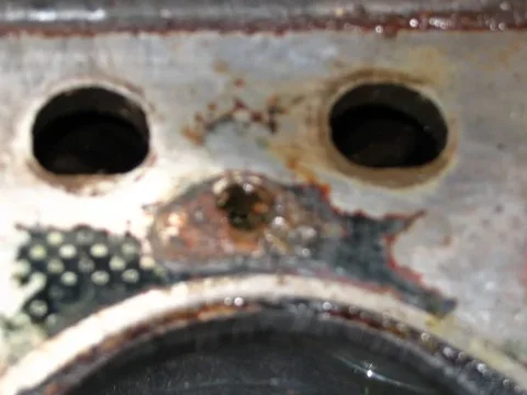

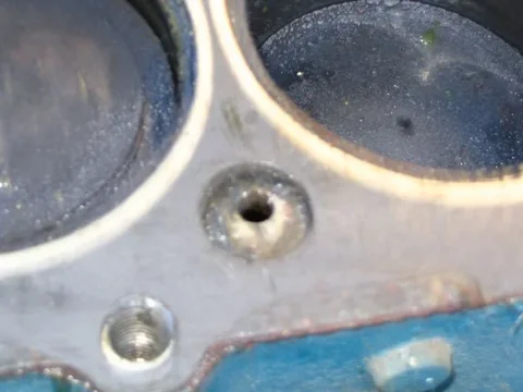

Okay I took off the head this afternoon.... please look at my pics and tell me what you think.... I can not believe that the head gasket was on wrong... I marked it when I took off the head (btw they are really heavy) seems like everyhting lines up???? I was realy dirty but this is the first head I have ever pulled... so I have nothing to compare it to...

It looks like things were right. Did the rocker support have a hole that lined up with the head? Maybe someone can pipe up on where the oiling comes from, I think its from a cam bearing. Usually there is oil in the head bolt hole adjacent to the oil passage... anything in yours?

Yes the gasket is the right way around.
no oil what so ever up there... I will purchase the star and post some more pic of the head if you think it will help...

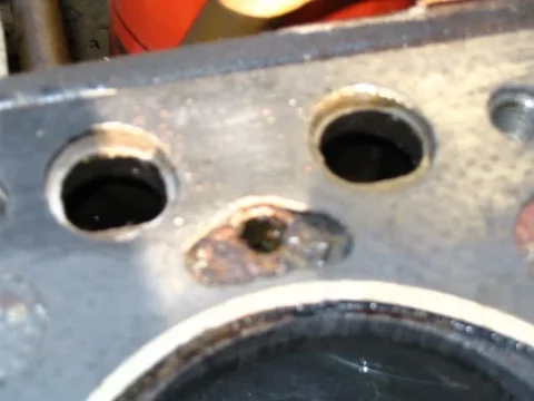

ok... got the star... now more pics of the block...

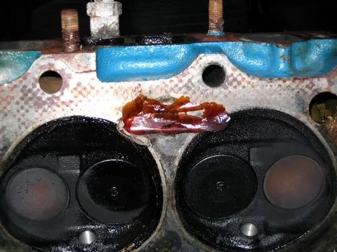

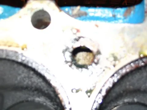

and now some of the head, ok you will see in one pic here there was somthing (must be part of the gasket or somthing that was over a hole... what I dont know is if this happend when I was trying to lift the head off or if it was there... seems like nothing was really holding it on, and I can not believe it could block anything.

Looks like an F head. I don't see the oil hole in your picture of the head. You need to show us a close up of the 3rd headbolt hole from the rear on the passenger side.

ok guys... I need more help... I looked at the oil holes on the head and the rocker.. blew air throught the holes and came through just fine... on both the head and the rockers... ( btw the head bolt that goes in that hole is not suppose to be hollow is it?) anyway so I took off the distibutor and used a 18volt drill to turn the oil pump.... took off the oil filter and the oil poored out of the hole when I was running the drill... put it back on and tryed for about 5 min. to get oil to the top of the block where the oil should come out of the oil hole... nothing ever came out.... so can anyone tell me what that means... I am begining to think that the head and rockers are okay and there is some reason why the oil is not getting there is in the block... Talked to my old man and he mentioned the Cam Berings? somthing about if they are not inline then the oil hole could be blocked as they move?? could the oil filter be so blocked that absolutly no oil could pass through? help please!!!!

Oil goes from the pump to the filter, then to the main oil gallery. From there the oil goes to the Mains which also feed the cam bearings. The third main bearing feeds the third cam bearing. If either of these was installed wrong then the holes wouldn't line up. I believe the third main is the thrust bearing, I don't know if that makes it any more likely to spin or not line up. 5 minutes should have been enough time for the oil to get up top. When I rebuilt my engine, I did the pre-oil with the drill to make sure oil would get up to.
