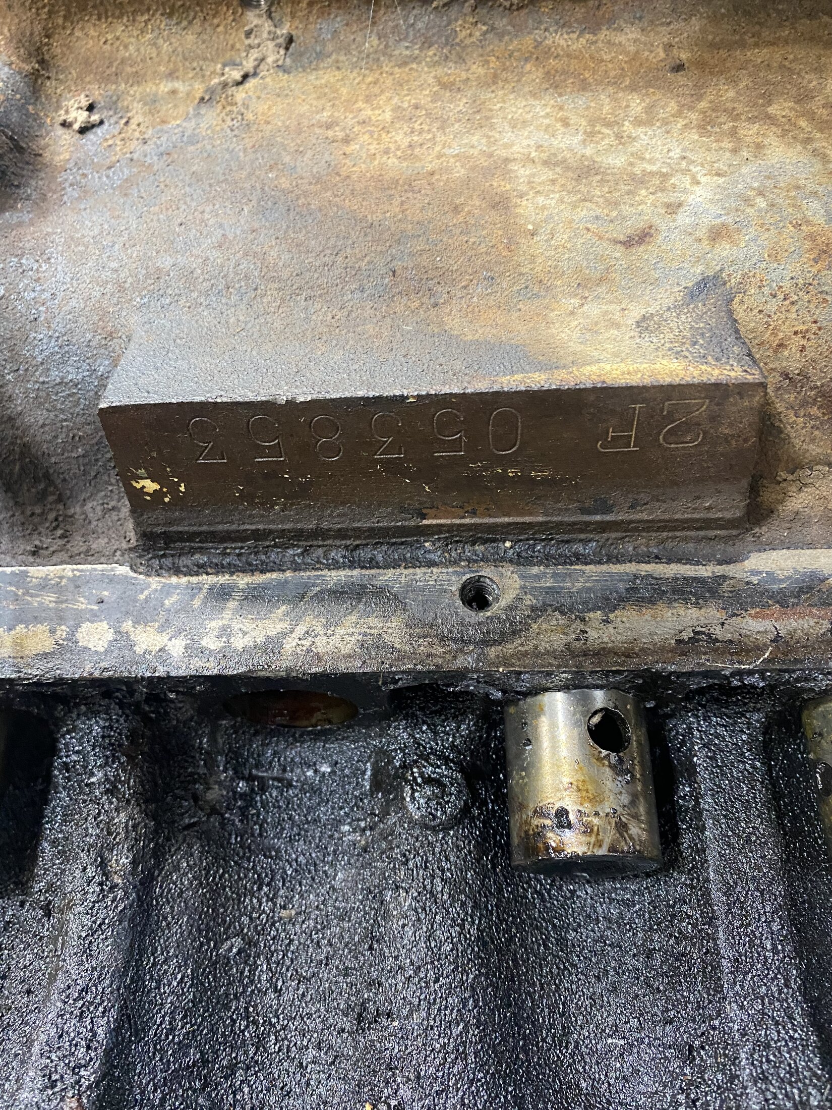

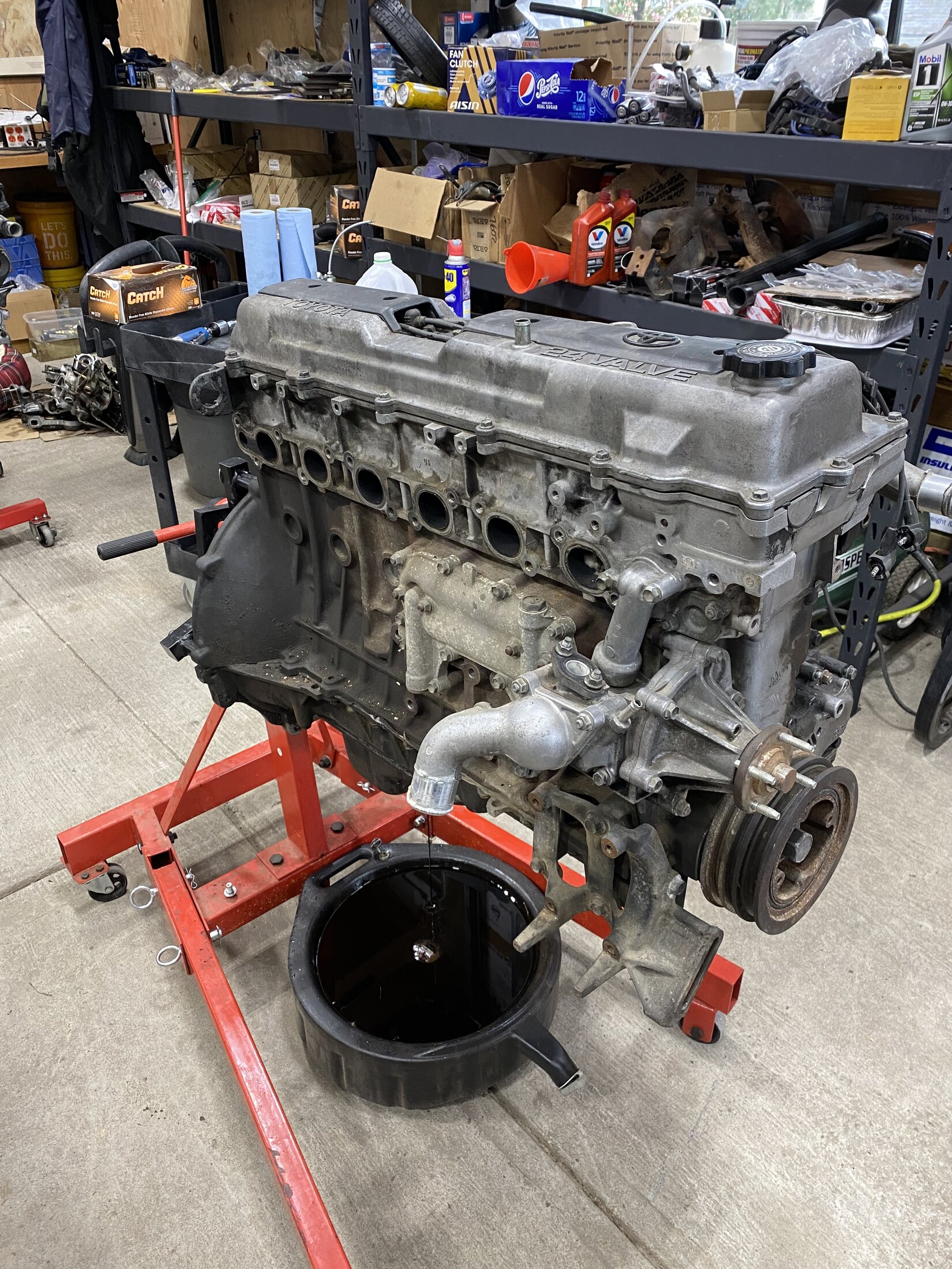

Just picked up a 75 2f for $300 it has been disassembled already and been sitting awhile. Going to bring it back to life. The head is a 61010 casting. It’s missing a couple lifter and the cam doesn’t look good. Going to get new pistons, rings, bearings and whatever else I needs would like to go OEM but not sure what’s available. Machine shop will handle the normal machine shop stuff. Need to research. Will gladly take suggestions for parts and things to do and not to do. Will be researching lots.

I think that oil wasn't changed very often. I'm thinking every working surface will need help. I hope you have a good budget amount set aside - but it will be nice to have a new engine. I would do a pre-oiler system - 90% of the wear happens on start up. Break in oil twice then full synthetic.

It’s only money can’t take it with me! Is a pre oiler common on the 2f have not heard that before. Just getting into these old pigs so I got lots to learn. My machinist has done a handful of these so he knows the deal, make it as good as Mr T. Did and I’ll be happy.

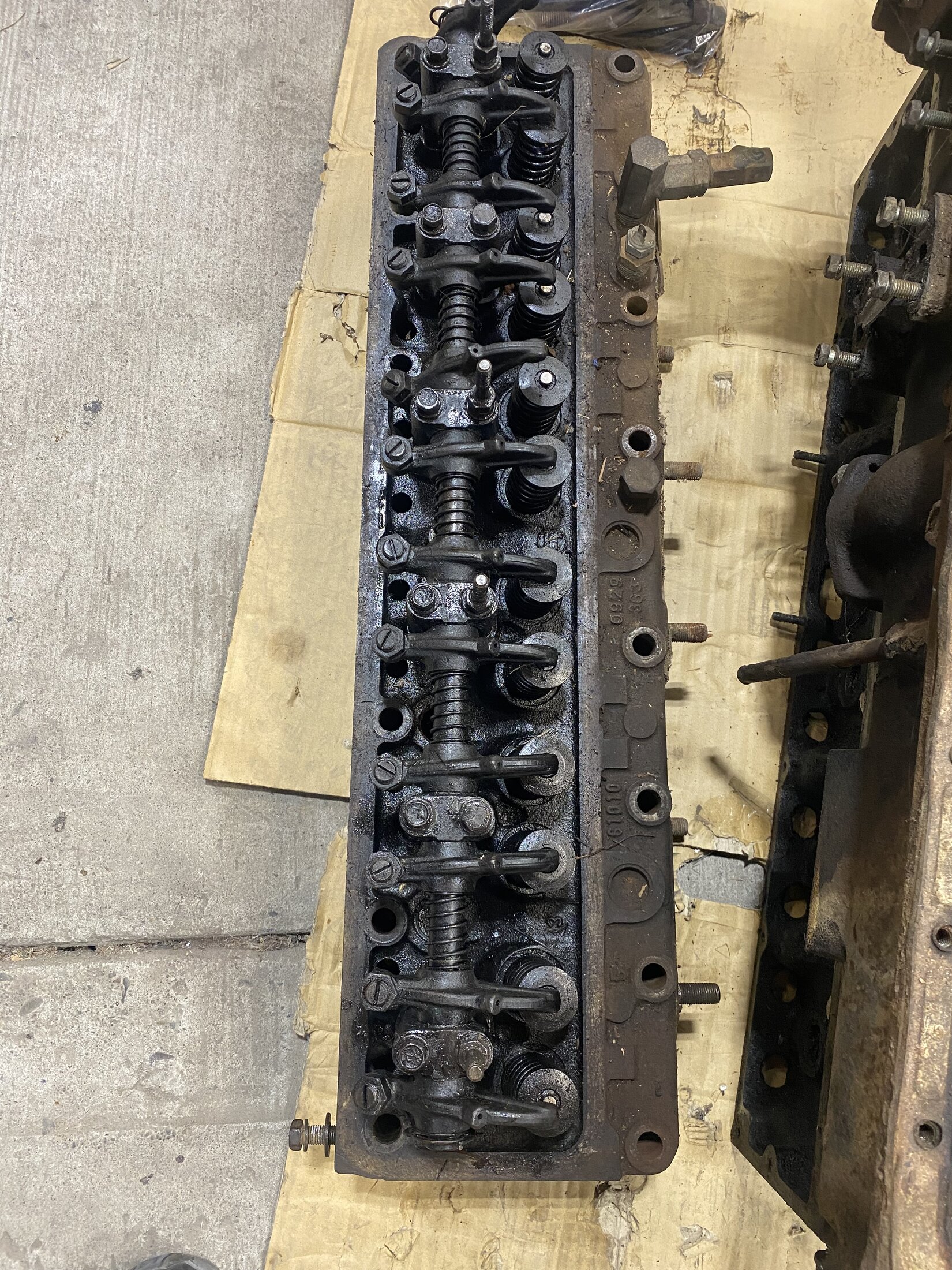

I also picked up a 61030 casting head a while back is one better than the other?

Any big difference in head casting 61010 what came with it or 61030 tht I picked up a while ago. One better than the other?

Any big difference in head casting fj40dash.com what came with it or 61030 tht I picked up a while ago. One better than the other?
pistons and heads more or less go together.
The oval shape head is for flat pistons and heads like 61040 - the more round shape 61030 are for domed pistons
Older heads like 61030 are less susceptible to cracking as I understand it
