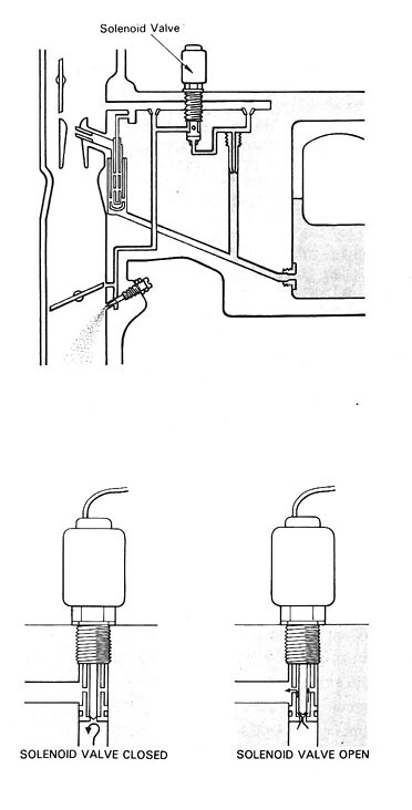

Sorry, meant a sieve. Ok, there is a metal brass rod sticking out, with an o ring on the end. But that doesn't move when the solinoid fires...
Doesn't move? I wonder if it's not moving from its extended state or from its retracted state? The movement is very fast and short, hard to see so it's best to have a finger on the rod while energizing and releasing the thing, so you can be certain.
Does it cut off the fuel flow when extended, or when retracted? Someone here must know for sure.
The solenoid must be energized to allow fuel to flow. Must have 12V. I think when it is energized it gets retracted, so it is opening the passage on retraction and then when de-energized it closes the passage???, with I guess the rod and O-ring. Heck, must be a way to just plug the hole temporarily and run with out it. It is just there to kill fuel flow when you turn off the ignition.

Ok, I've tested the solinoid, again...
So that brass rod you see does not move. How ever, it looks as though there maybe something inside that does move. Very very hard to tell though. Thoughts?
That's different from the ones I've got now although I remember seeing one like that used in a 'partscar' carb I had.
This shows your type of valve. It has a thin rod within the external brass portion that acts as the valve itself. The small arrows show fuel being turned away when closed and allowed in when open, and there's not much movement between the two.
The diagram shows a passage chart for an Aisan used on a 22r engine but I think it's typical.
