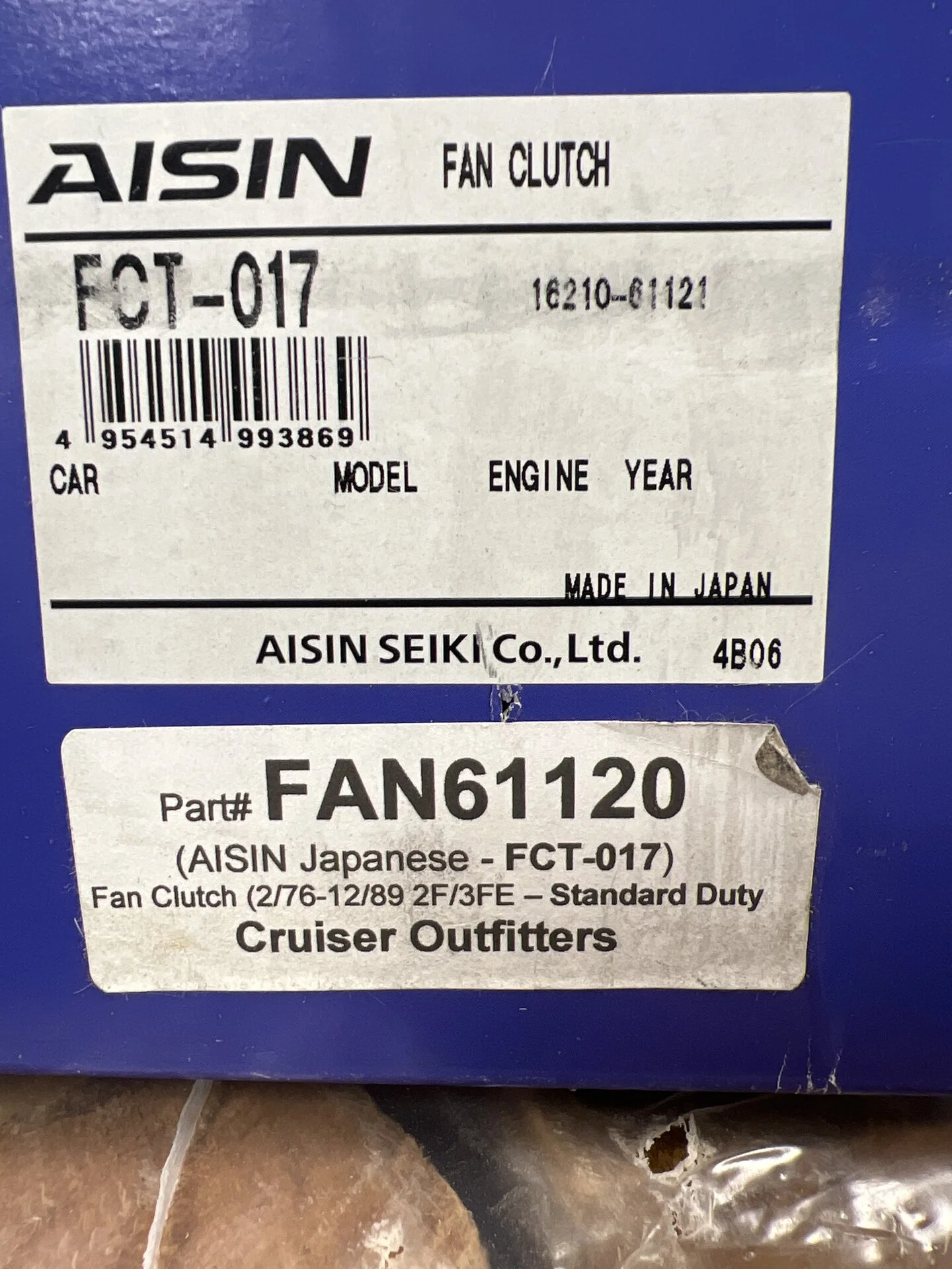

@CardinalFJ60 do you have that Aisin FCT # for the black hub HD 2F/3FE fan clutch? Looks like Cruiser Outfitters is out of stock on those and I am weighing either that fan clutch against the FCT-049 (green hub?). Thanks for letting us know.
The one I have is the standard duty "017" - haven't installed yet. turned out to be a sneaky hose leak I didn't see... I'll take a picture of the box/label in a little bit

@CardinalFJ60 I know its a few years later, but can you confirm that the photo you showed there with 16210-61121 was actually the heavy duty clutch? I notice the box does say "standard duty" on it. I have been looking for a heavy duty (high temp) fan clutch myself since I live in a warm environment, and am trying to figure out which one is which. It kind of looks like the AISIN label of 61121 is correct, and then they put their in-house Cruiser Teq label of 61120 on it incorrectly?

The Cruiser Teq ($137) one doesn't say anything other than Heavy Duty, but is probably correct:
On Rock Auto, they also sell something (US MOTOR WORKS 22076) just referred to as a "Heavy Duty" (with black paint in the photo), but I can't tell if it is actually what I want. Much more tempting for just $42, and it does state it interchanges with part 1621061121... but generally I prefer the AISIN/OEM part if I can get it.
Any idea what is what (or if it is all the same)?
