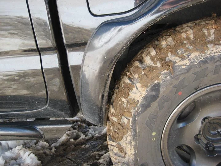

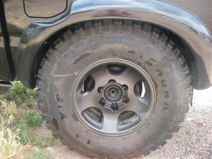

hey I'm running 255 85's on my D-cab, 80 rims too. I had to trim the inner fenders in front, and had to use lift blocks to reposition the axle in back, moved it back 3/4" and it's perfect. If you find you are hitting the front of the rear fender wells, that's what you wanna do.. :)
Only place I rub now is the lower valence thing below the stock front bumper, but that's a temporary condition.. :D
edit: here's 2 pics of the rear, before and after moving the axle back.
