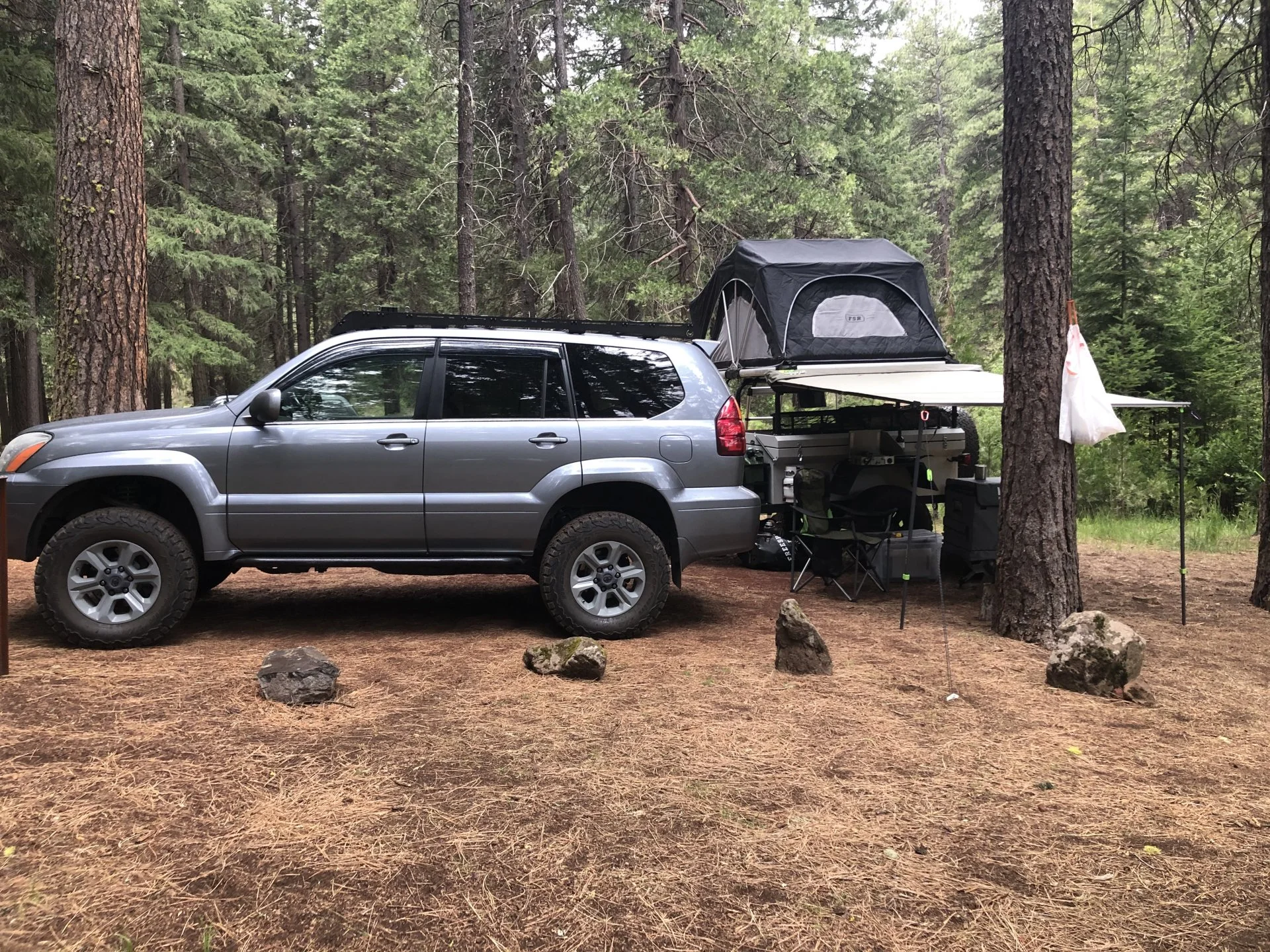

255-75/17 BFG KO2’s
Approx 2.5” lift (Ironman FCP’s), on stock 4-runner rims.
These tires rubbed slightly with stock suspension, but no rubbing with the lift.
”C” rated, good ride, balanced (fairly) easily, pretty light for the class.
Hard to go wrong with the KO2.
EDIT…they do not fit in the spare-tire location. I carry my spare either on the trailer you see (same tire and wheel combo on it), or on a RIG’D hitch-mounted carrier.

255-75/17 BFG KO2’s
