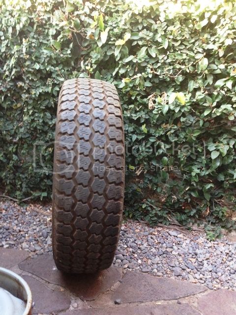

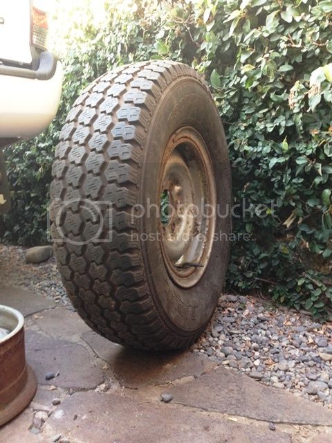

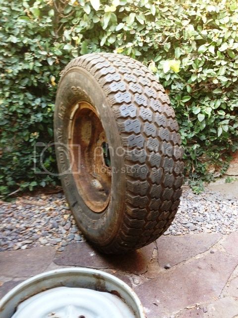

Me again...:bang: ...After some investigations, I realize that 255/85R16 tires are very hard to find here (Chile), lets say almost impossible. I'll have to import them from USA. Not as I was planing.....
Anyway, Today I made a little test, mounting a LT Discoverer Cooper tire 265/75R16 into a R16 /5.5 Toyota split rim, just as a test. (BTW, the tire is old and the rims is not restored yet) just a reference!!!.
The result... looks good to me... (aspect ratio with the wheel)
What do you guys think?

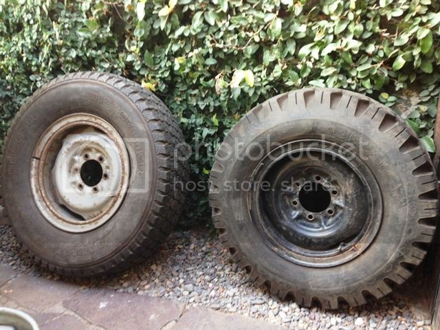

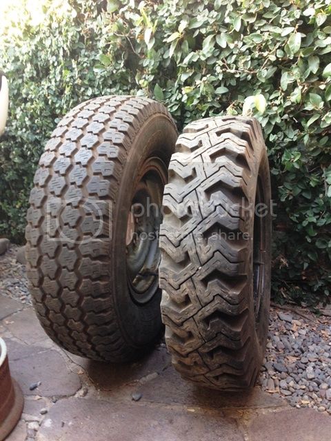

Only as a reference, the black one is a HI MILER 7.00-15 on R15 split.

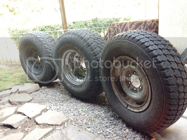

These are the tires/wheels availables in my "private stock" but not sure about.... Steelies :hmm: in my mind !!!!
