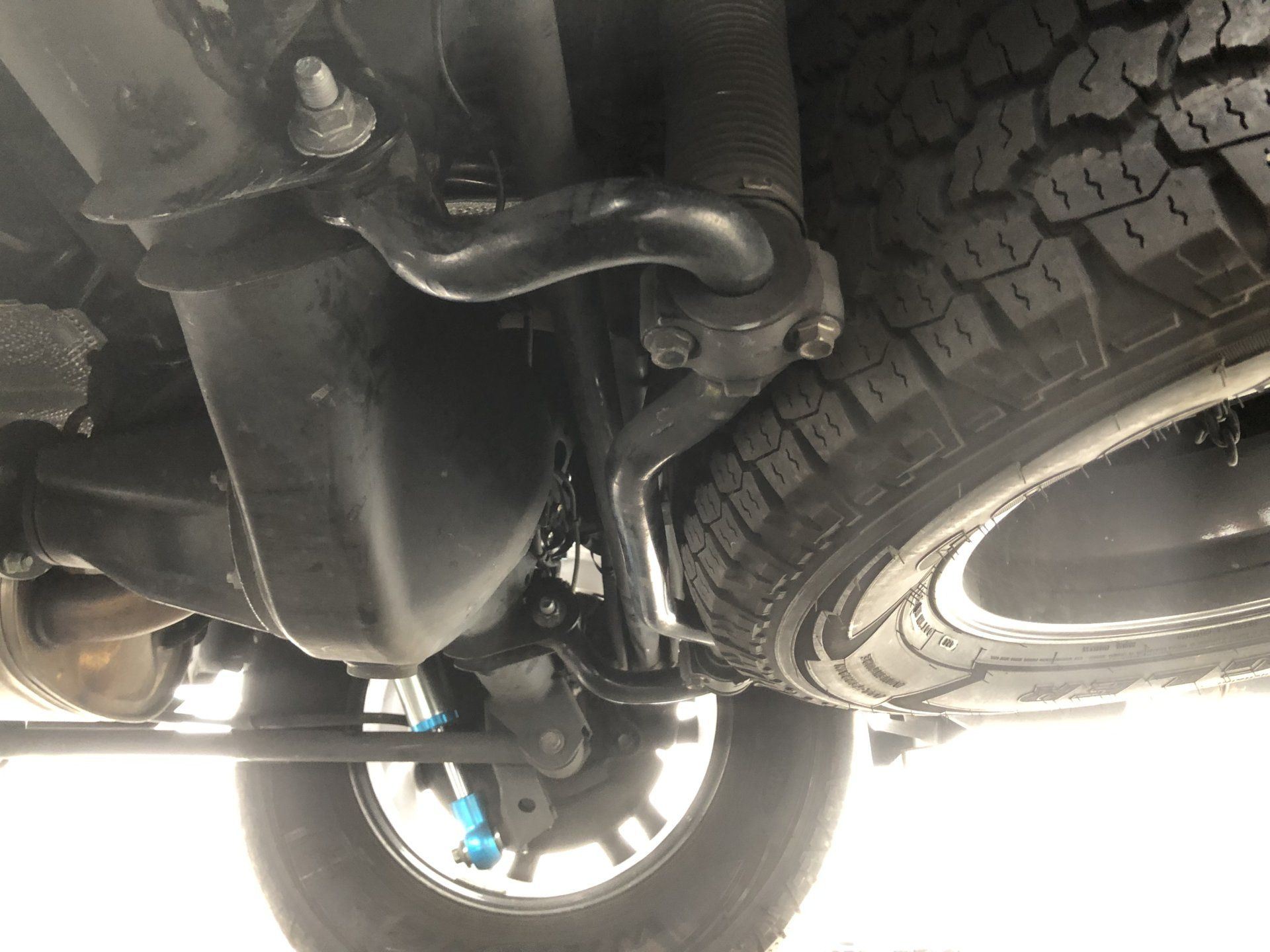

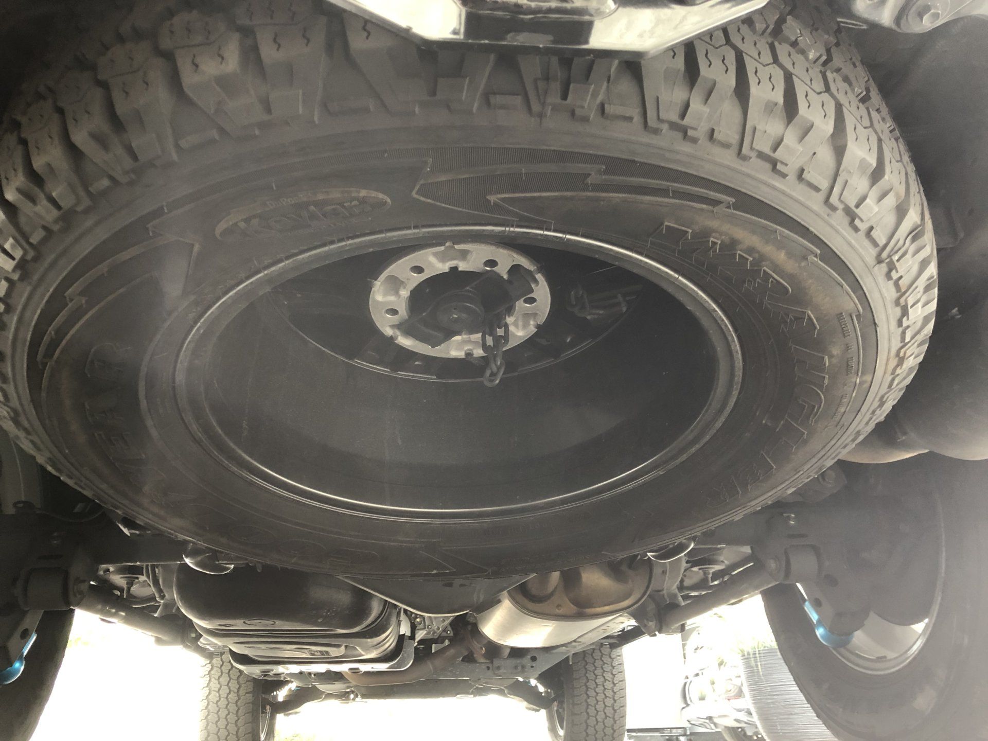

New truck is a 13' GX- I fit a 275/65R18 in spare location and it is a super tight fit. At full inflation (32psi), the spare is 1-2mm away from rear sway bar. I have the small class 3 tow hitch mount clearanced the inside edges with angle grinder. It helped but I run deflated down to 20 psi. Still tight but allows sway bar movement. Next phase will be figuring out how to create more space in spare location for 285/17.
Posted to help anyone in future.

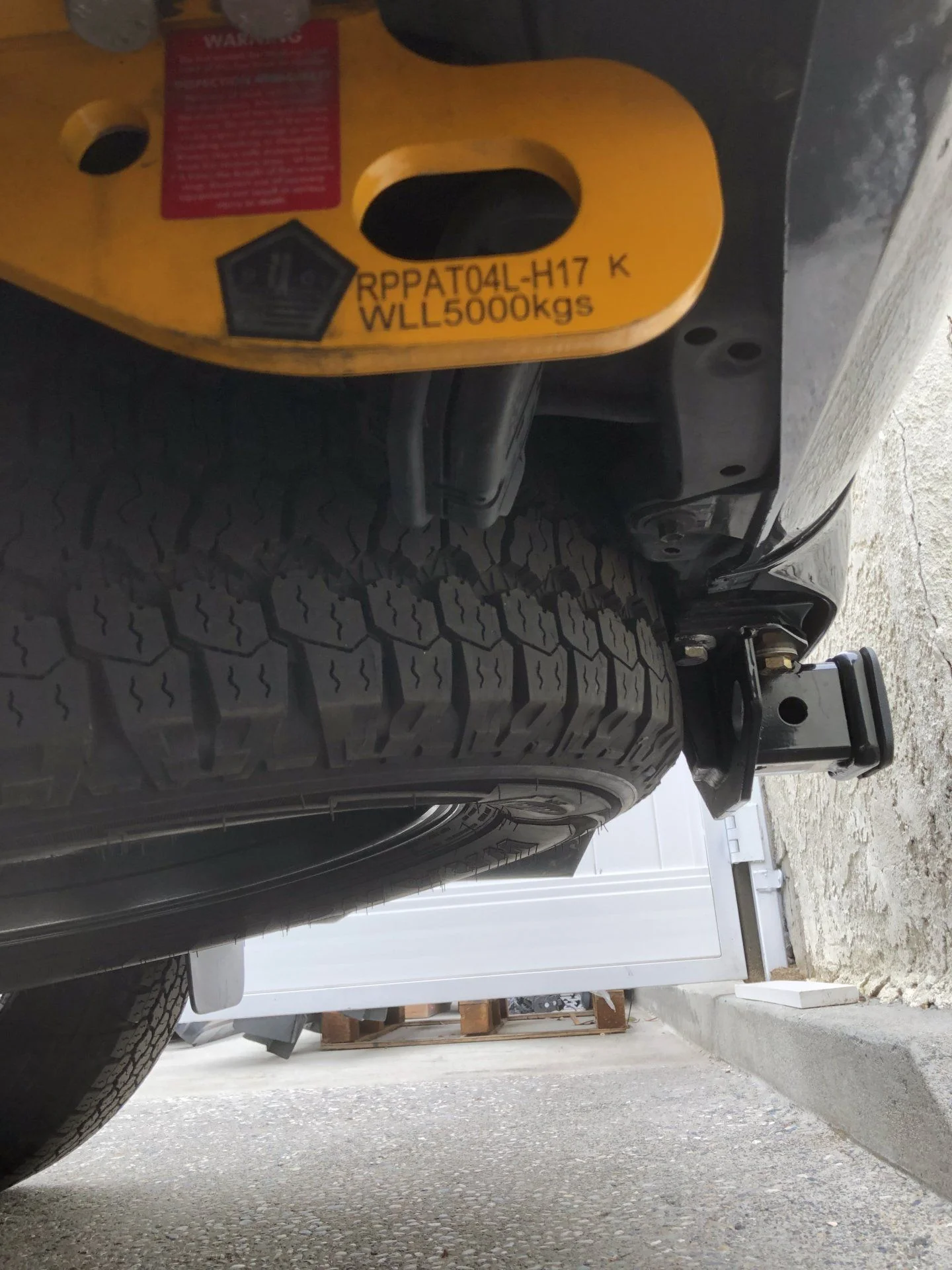

Also, a few of us run the factory hitch which is much bulkier than the smaller aftermarket kind.
It's very strange that the GX has a smaller spare tire location. I looked through part numbers and they do not share identical frames. They share the same wheel base, and the 4Runner with KDSS frame shares most frame components with the GX. It even has all the clips for the air suspension. But the rear cross member is a different part number. Interestingly GX frame models also change part number by year. So they must have made some sort of changes during the production cycle. You can't buy the side rails separately that I can see, so they may also be about 1" shorter on the GX. Strange. The 4Runner has 3 different frames depending on model.
Yes having had both KDSS models, I can see many of the same parts/specs but the spare tire location is very tight. Working on some solutions.

BTW the tires is hanging rather low, I probably will try to find a skinnier tire with same diameter for spare.
