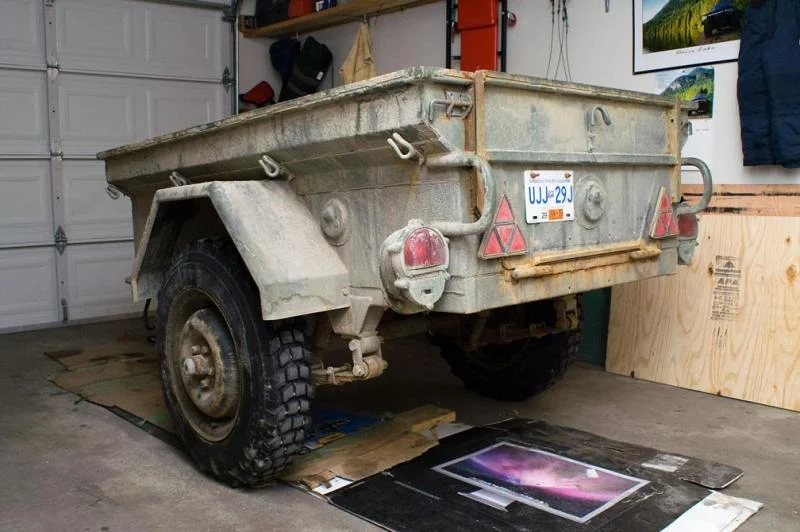

lotsa room. this is a stock setup

Hmmm. Do you think they'll rub only when the suspension is flexed or just any time? I definitely don't want them to rub.
At worth you will need bump stop, but my guess is that they won't constantly rub, I have 31" and about 2" 2 1/2" to spare to the back or front of the fender. What might happen is if you hit a good bump and the trailer is really loaded you will wrip the fender and scrap a tire has the thread will hit the start of the fender. So you will need to cut the verticale section of the fender and you should be ok.

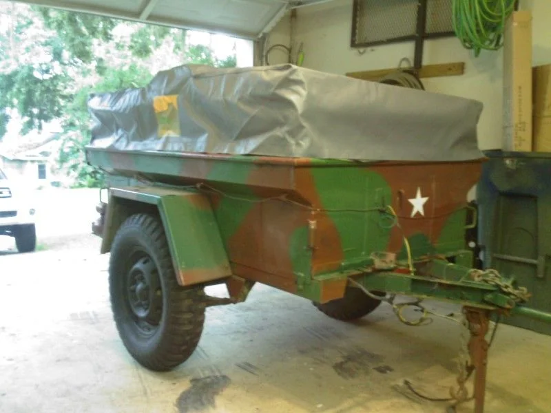

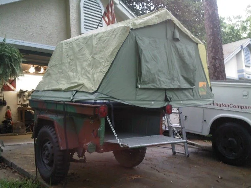

Hey, I just bought a 1/4ton military trailer to build a "camping trailer" I am having an issue as to what size tire to go with since the Military 7.0 x 16 tires that are on it are original and 30 years old.
the actual military tire measures out at 30" tall and about 7 inches wide. I was thinking about a 245/75/16, but wanted to check with you all here on Mud before I make the dec. THanks in advance.

I like narrow tires.. they pull easier, and cut through snow better, also will pick up less nails..
You can upgrade to 235/85r/16 or stay with the smaller 215/85r16.. the 235s are easy to come buy every tire shop will have lotsa inventory. the 215 are available, but may have to be ordered. same hight as the 245 75 16, but narrower. they will fit nice on th rims and will not be to wide. they are almost always ten ply, great capacity.

I have 245/75R/16 Goodyear wrangler MT's mounted on the stock m416 rims. I have used this combo for 12 years and have no rubbing or problems what so ever.
THanks for the help. I will make a phone call to the local tire shop tom. Thanks again for the help.

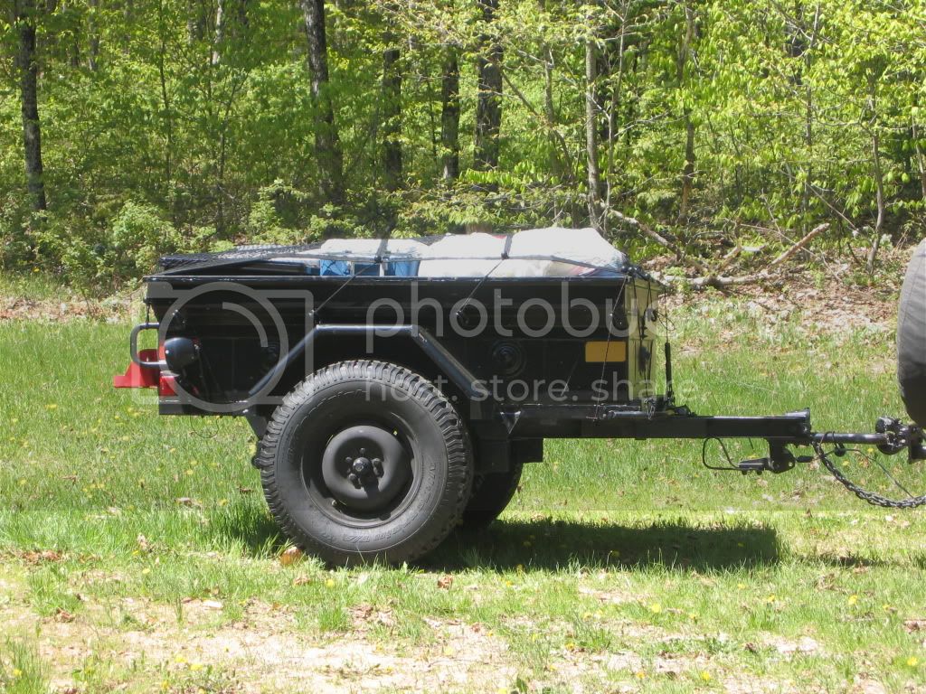

Here's BFG AT 235/85/R16s on a stock M101 trailer. I think 255s will fit with a SOA but will stick outside the fenders a bit.
Not hooked up to my new Taco :doh: but this will give a bit of a comparison between the 235s and 245/75/R16s
