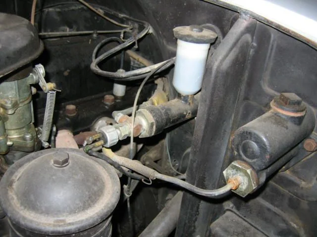

I've got the SOR piston in mine. The retaining washer is sheetmetal .035" thick. When all the way back you can see the piston in the rear hole, not rubber. Here's some pictures but it's hard to see.
Thanks, Jim!!! I do appreciate that. :) I'm just wondering if the replacement SOR piston is the wrong one and way too long to begin with. A quarter inch is a lot. :confused:
