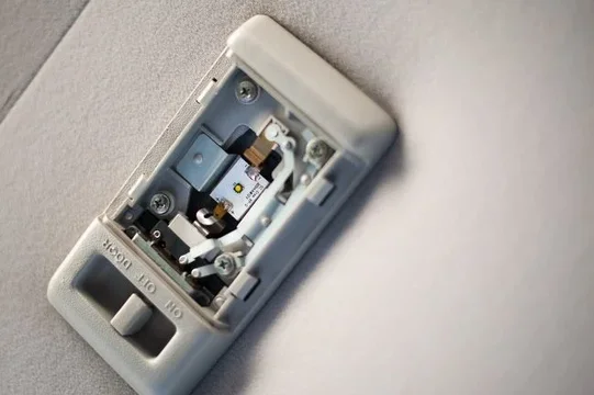

I got together with electrical engineer/LED guru George Scolaro and made some LEDs that I'm selling on the 80s forum. The LEDs can handle anything from a few volts to about 50 volts. They work fine in 24V systems and will only draw about 50 to 100 milliamps. They're not cheap but they won't burn out and will last virtually forever. They also put out a lot of light.
A lot more pictures here on my Flickr page.
