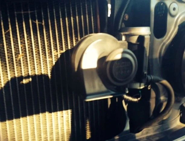

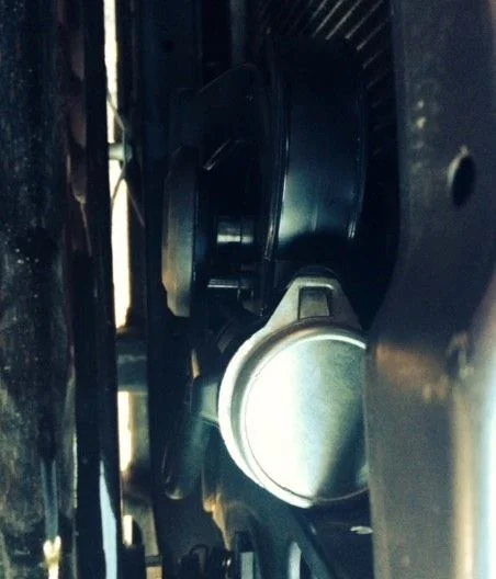

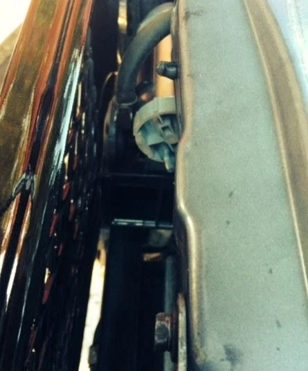

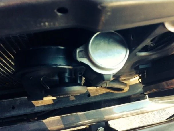

Picked the truck up from shop yesterday. Two horns installed, that sound just like the video above. Warm, rich, loud. Sounds like an air horn, not an electric horn (honk, not beep).
Fits fine in my BJ 73, high up in front of radiator, about an inch clearance between front of horn and back or grille. Looks like plenty of room between and below for A/C, trans or intercooler radiators. Photos below without and with grille in place.
