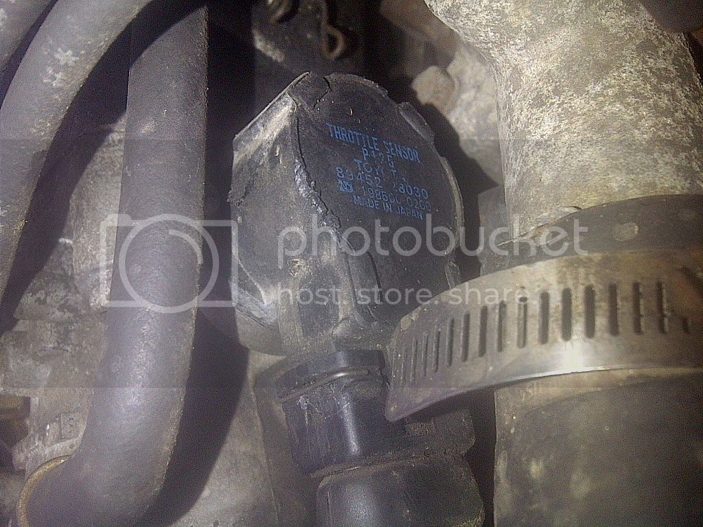

i did discover if i tap on the front of the intake manifold where the butterfly is . if i tap useing like a ratchet it will make it stall out. but i will check the tps when i go back out. Its running like it has a real bad misfire. almost but not as bad as when it had cloged injectors. mr injector cleaned them. and it had new fuel filter put on. Hope its the tps

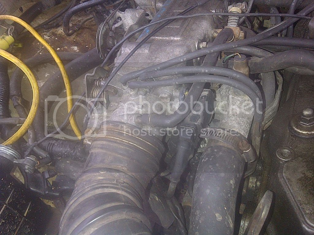

Check the air duct that runs from the filter to the intake. Check that the clamps on each end are tight, and especially look at the flexible elbow right by the intake - they tend to crack down inside the low spots. Any air getting into that tube is not being measured by the MAF, so the EFI control is not accounting for it and you will run way too lean.

yeah plug wires are fine not only do they have less then 400 miles on them i slid my hands up and down them while running. with one hand and had my other on the intake. If they were shorting i should have got shocked. I unhooked my TPS it didnt change how it runs. had the exact same rough idle and hesitation as it does hooked up. think its my tps?

thats what i had unpluged as tps. Im corect in thats the sensor right? On the yotas is there a way to clean them or do i just gota suck it up and go buy new one.
when it started running ruff sunday. i was looking for the problem and was taping on front of the intake manifold in the area of the tps and it made the truck stall.

also didnt have this problem till i adjusted my idle. COuld the tps cause a hesitation? Like i lost a cyl almost

This still sounds like a cracked intake hose to me. The elbows get brittle when they are old, and cracks can be hard to spot. Bring it inside, get it warm, then shine a flashlight thru the elbows while you gently flex it, see if you can see any light coming through.

still weird that you can stall the engine while tapping on the intake manifold.
