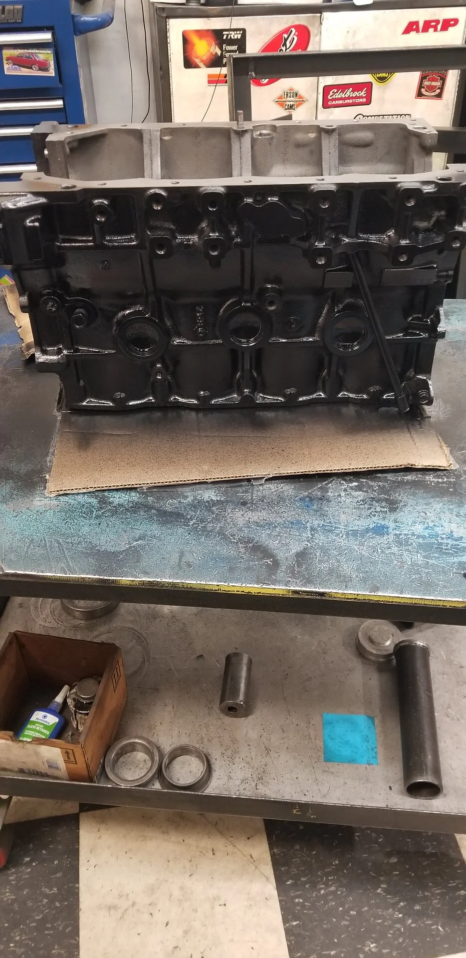

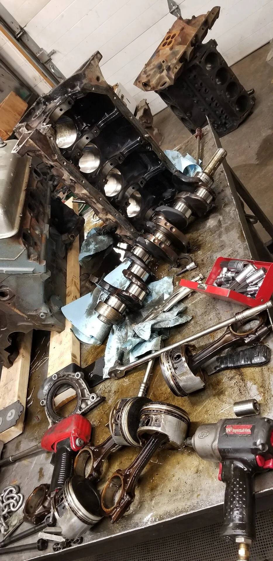

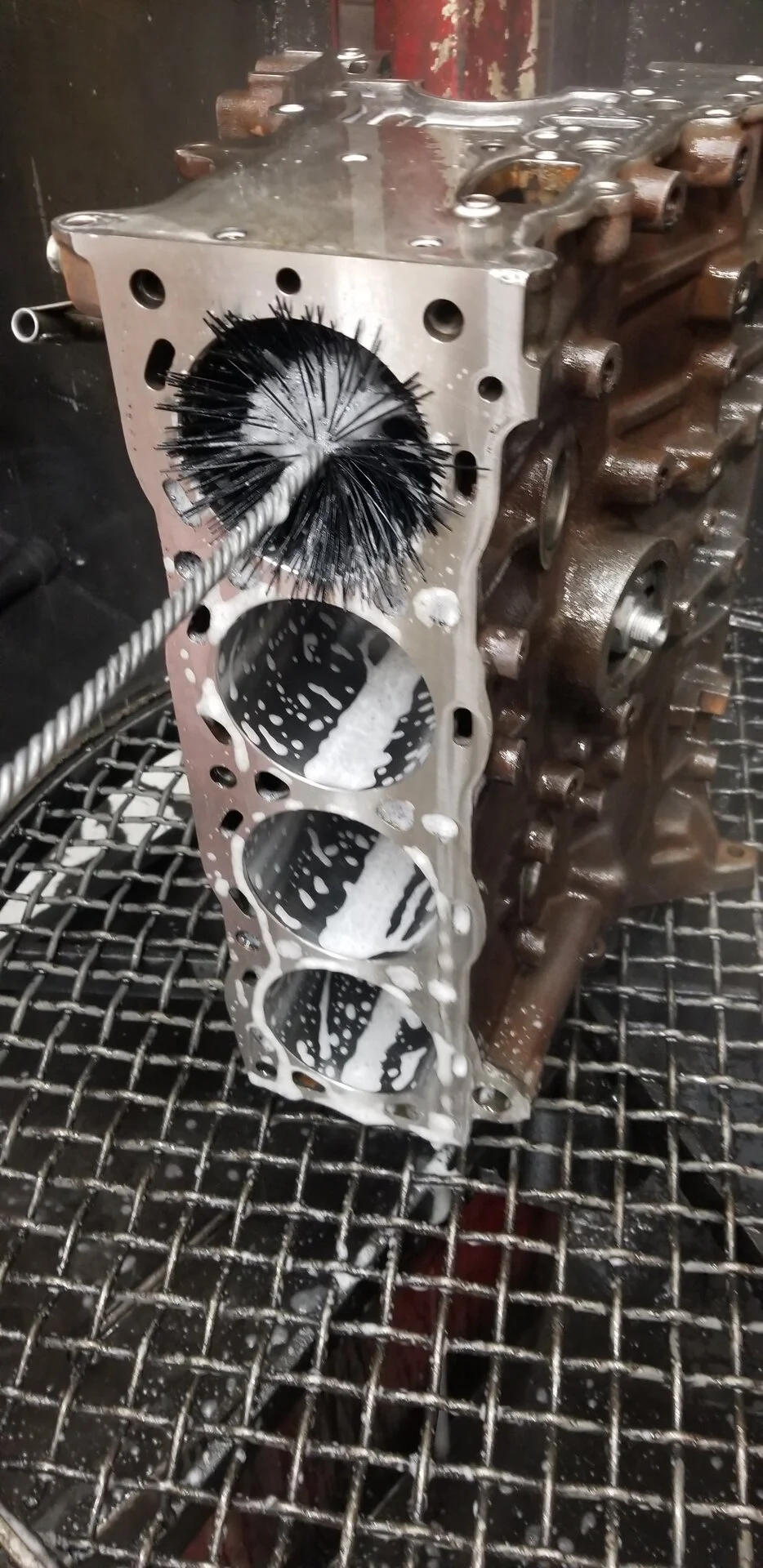

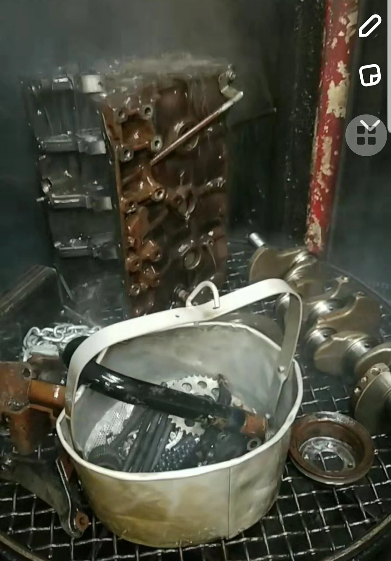

I blew the complete engine assembly apart in record time, hot acid tanked the block and crank, washed it, decked it, and started punching it.

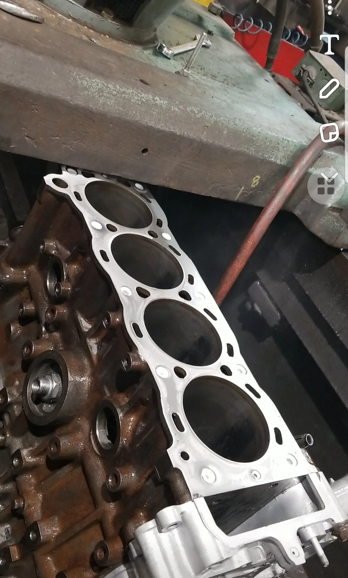

The deck took .012" to clean up. It was pretty straight and square around the #1 hole, didnt touch the middle much, and hit half of #4 hole. Lots of pitting and erosion around the water jackets. Didnt take a picture of the first pass, but thats it ready to come off the machine. I have no idea how this thing ever held a head gasket. Possibly lowish compression from a slightly lifted compression ring around #4 hole?

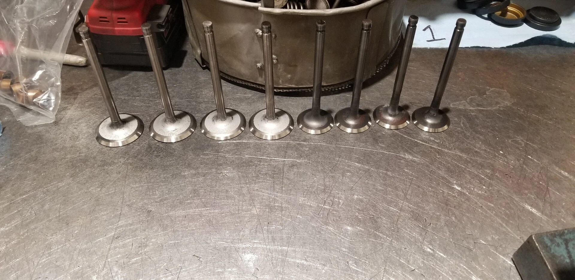

All the intake valves vac'd like freshly machined valves and seats, and all 4 exhausts were roughly the same leakage rate.

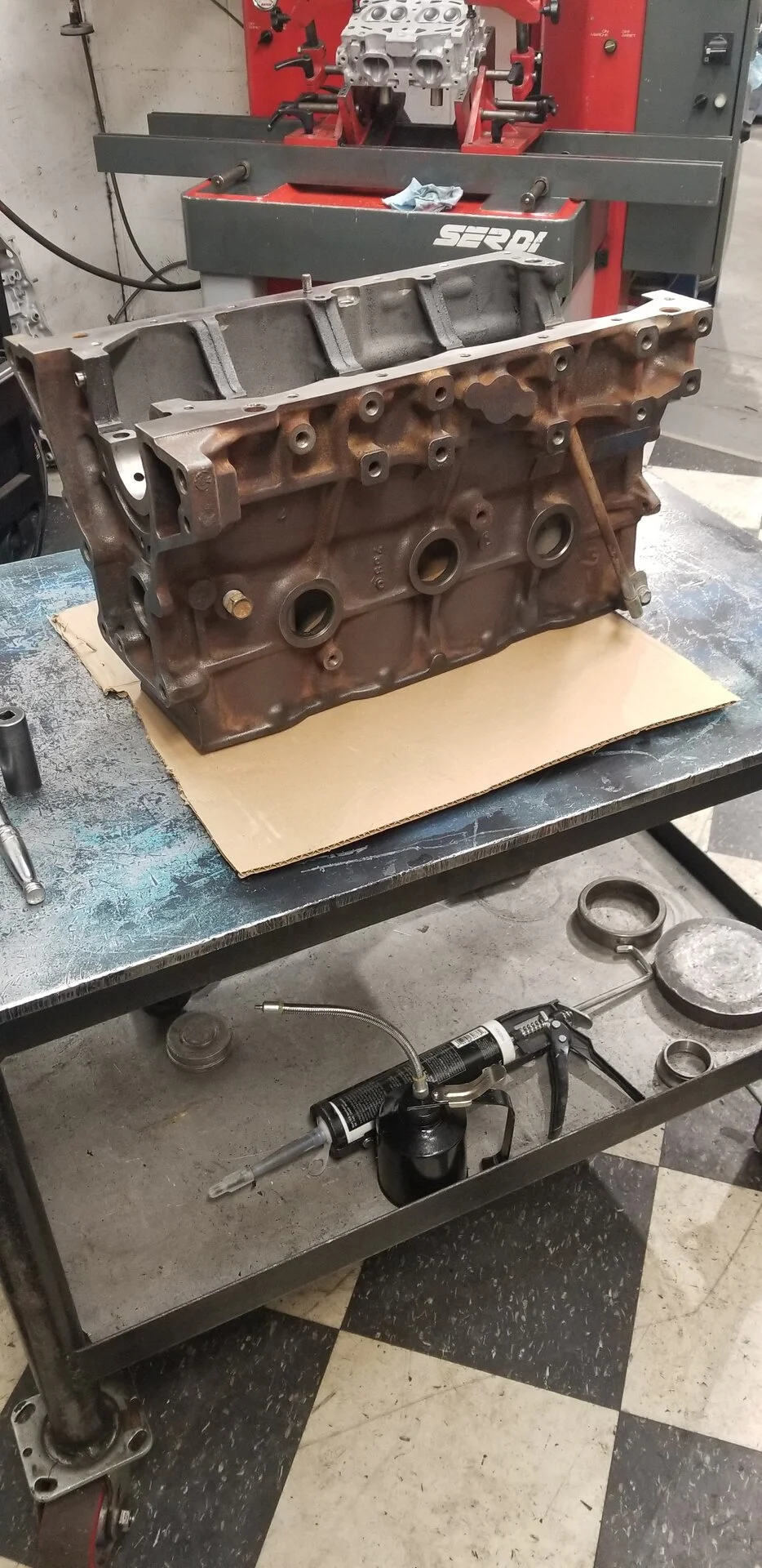

All the bores were atleast .0015 taper and out of round. And .0015" larger than max spec. Cleaned up pretty quickly in the Sunnen Ck10.... no problem cleaning up for a .50mm piston. Aka roughly .020" over.

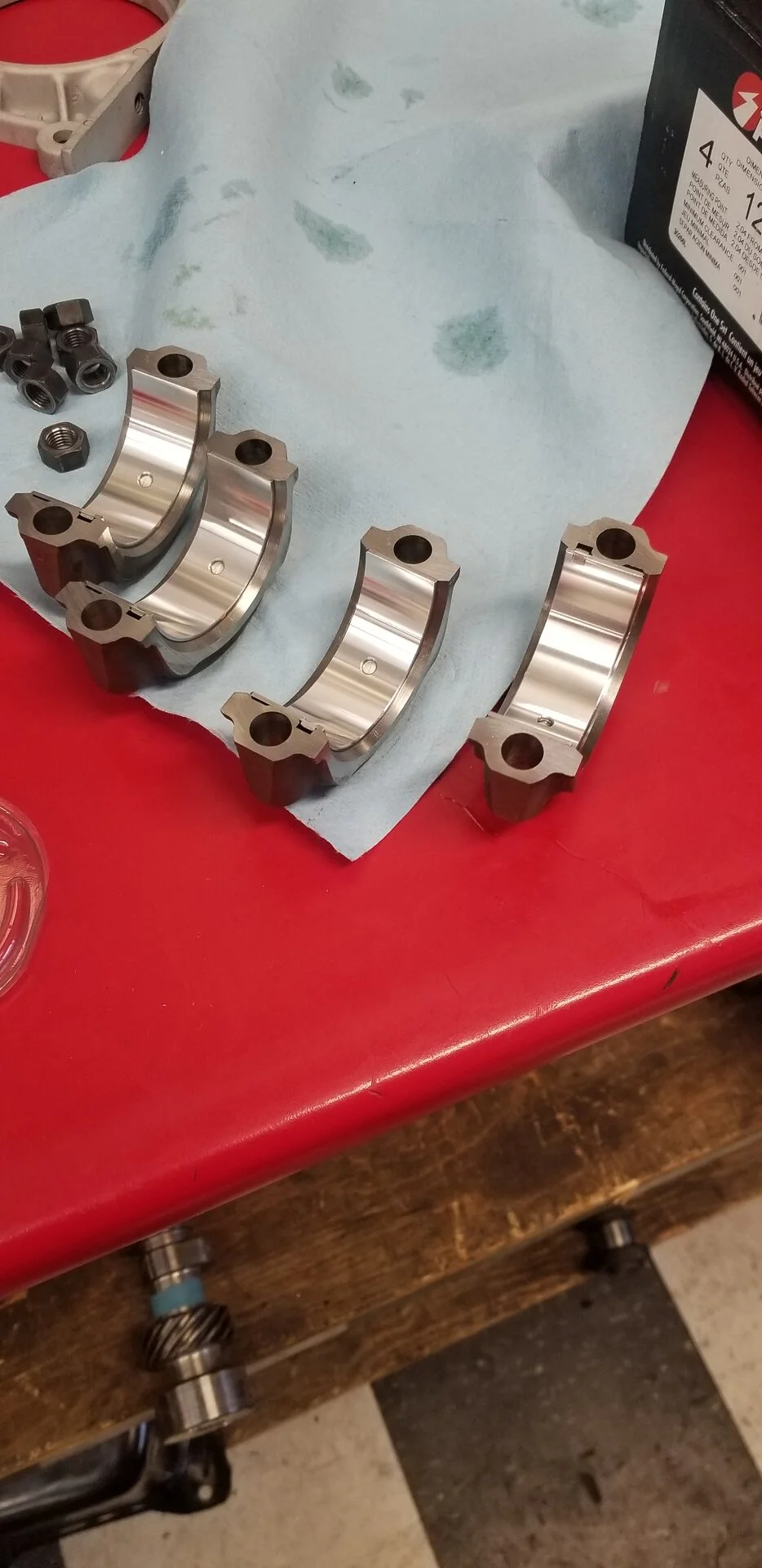

The bearings looked fairly good but just startimg to show some wear on the thrust sides. The crank measures standard and perfectly. The finish is just about as nice as it would be coming off the crank grinder, a polish will get it there. .0001" under max on the rod journals and .0003" under max on the main journals. Usually dont get this lucky when it comes to the crank. Toyota set this motor up pretty tight at the factory. It will go back in with standard bearings.

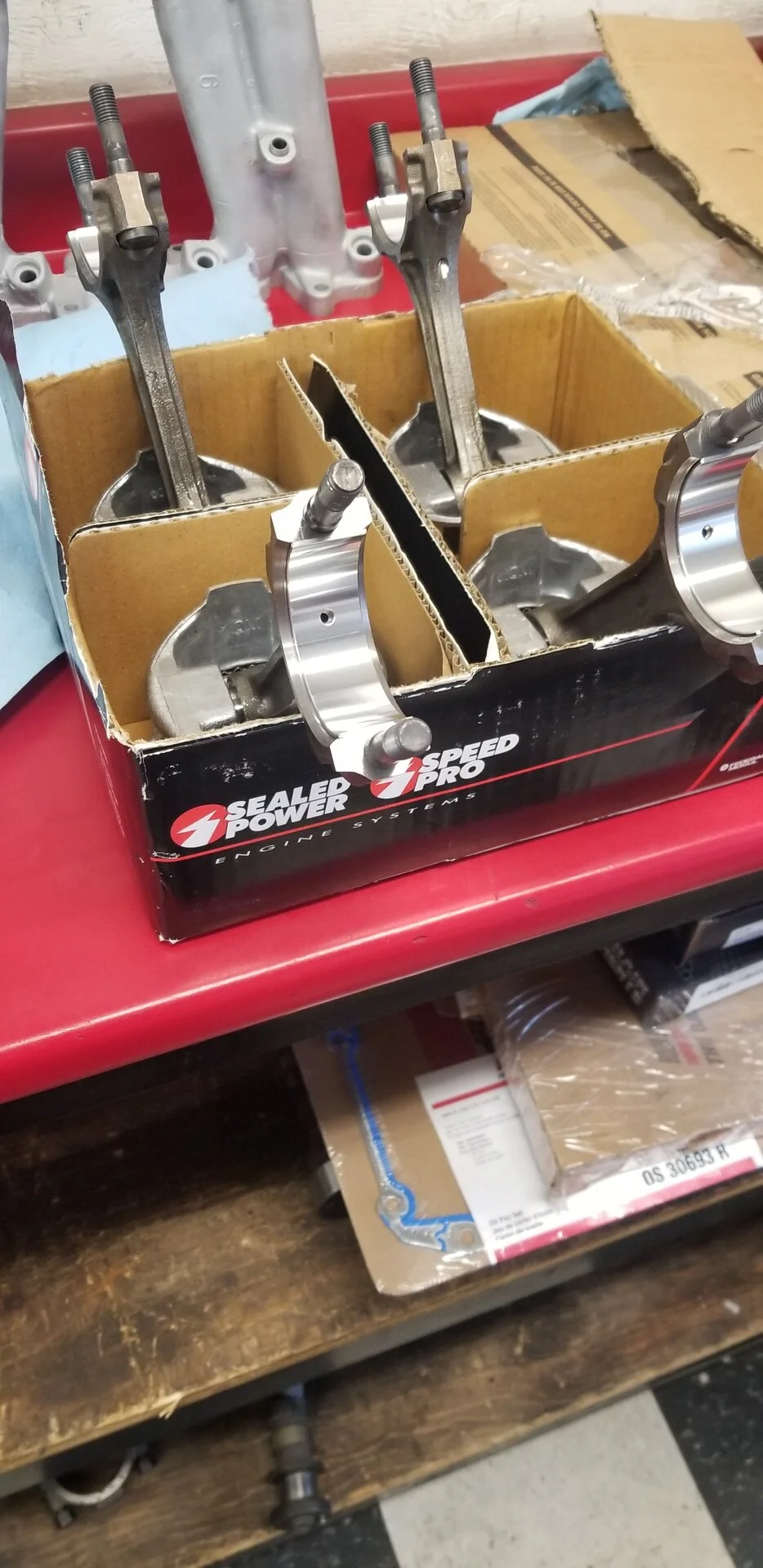

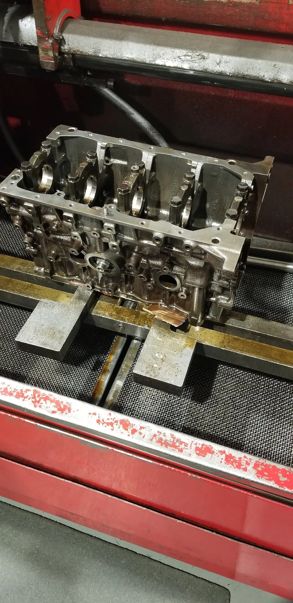

I finished honing the block today. You can remove a lot of material fairly quickly to get it to a roughed oversize, but finishing to size takes time. For a .020 piston you would cut out .017 with roughing stones while avoiding cutting a taper, hour glass, or barrel shape into the bore. The last few thousandths to finished size are done with finer stones. Being mindful of heat, the bore gets taken to final size while keeping it round and straight. It takes several attempts to creep up on the final cold bore size. Heat generated from cutting will make the bore measure larger than it is and its cruical to let the bore cool down and go back and give it a few more rubs to get the final dimension.
The coated skirt cast pistons I chose came out of the box with a .0003" variance in size and a minimum clearance of .001" required. I blue printed the bores to the pistons to end up with a final skirt to wall clearance of .0014" for each hole.

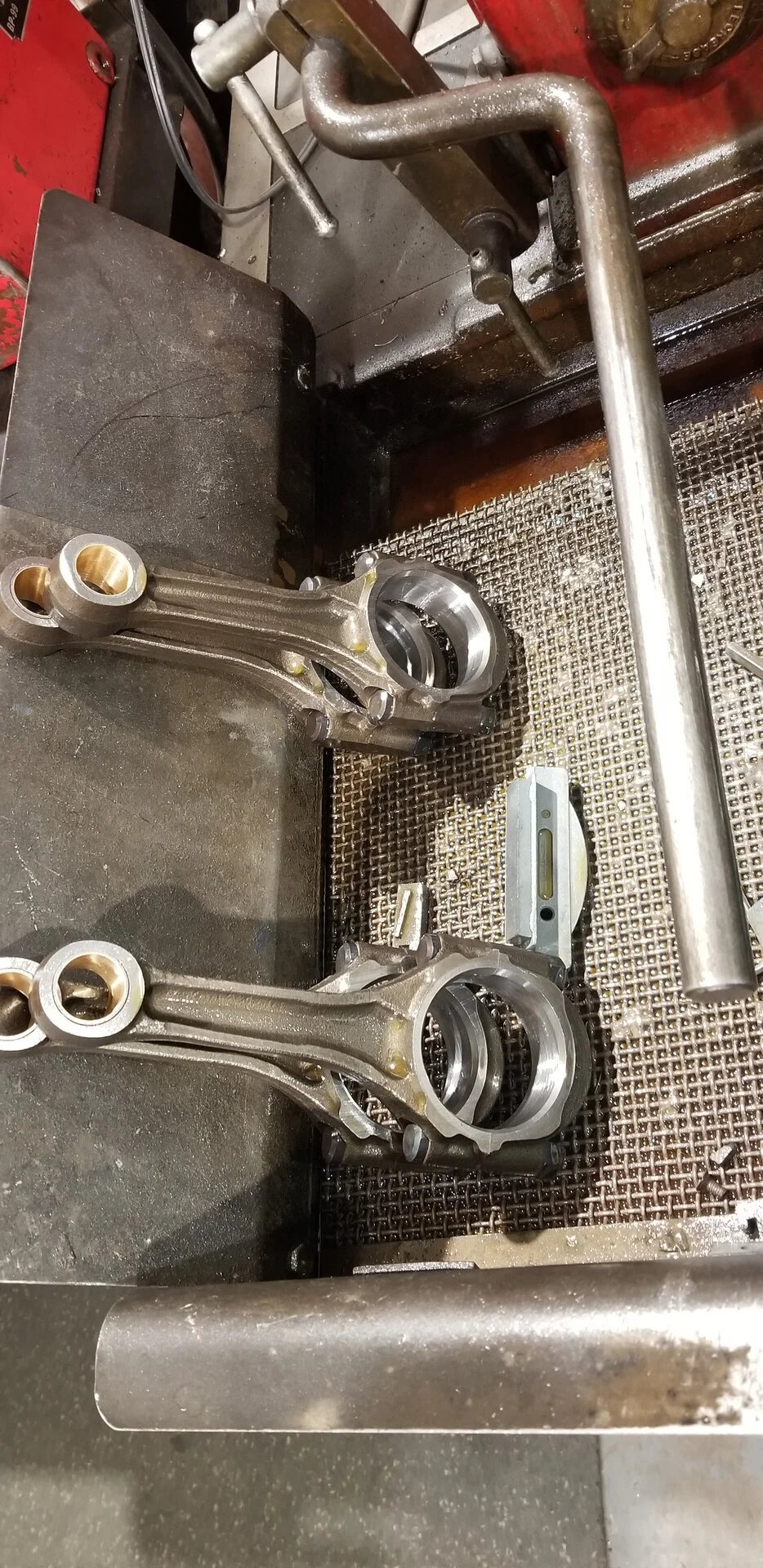

I will be resizing the rods, small end and big end. The original piston pin bushings looked worn and 1 of them was too loose. The other 3 were tight enough but I failed them on a visual... likely not far behind being worn out. I pushed the old bushings out, pressed in new ones, and sized them to the pin supplied with the piston. This takes time to rough size and come back to the cold rod for final cold pin bushing size. The big end of the rod measured fine vertically but was showing distortion and was out of round. I cut the caps and rods and roughed them to size...again need to creep up on final cold bearing bore size.
I mentioned earlier that the crankshaft rod journal measured .0001" off max. size. The rod bearing bore measured .0003" off min. size. With a brand new aftermarket bearing, that would put the rod oil clearance at .0009". The oil clearance spec is .0008-.0037. Toyota set this engine up at the factory threading the needle on squeaking the rod bearings when it left the showroom floor. Now thats not to say the OE factory bearing didnt have a couple more tenths clearance in it, but its quite impressive to me how good the crank looks after 150k miles. It is my opinion that Toyota truly set this engine up at minimim oil clearance to let it wear in over many thousands of miles.
The old bearings are in the dumpster but I'm going to dig them out and see what its oil clearance was at the 150k mile mark.

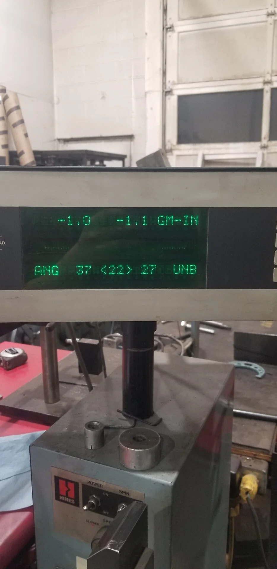

So I figured never a better time than right now to balance the engine.
Being an inline engine I didnt need to make any bob weights. And theoretically the FW PP and HB are all neutral... not quite. Balanced the crank then started adding and zeroing out the Flyhweel, PP, HB. This crank was really close right off the show room floor. 10 grams on the snout and .7 grams on the tail. The fly wheel can go on in 1 of 6 positions, at a minimum it was out 0 grams and at a maximum it was out 17 grams.... I chose the 0 gram position. Harmonic balancer only goes on 1 way and was 5 grams out. The PP can go on 1 of 3 ways. In the best position it was out 15 grams and in the worst position it was out 35 grams. I chose the 15 gram position.
bit of drilling and flapper wheeling on the PP and HB and I called it a finished balance at 1 gram. Seems slapping it together all willy nilly at best I'd have been out 5 and 15 and could have been out 5 and 50...plus whatever the 50 transfers to the snout.

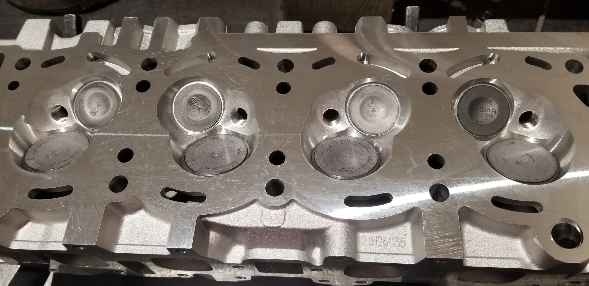

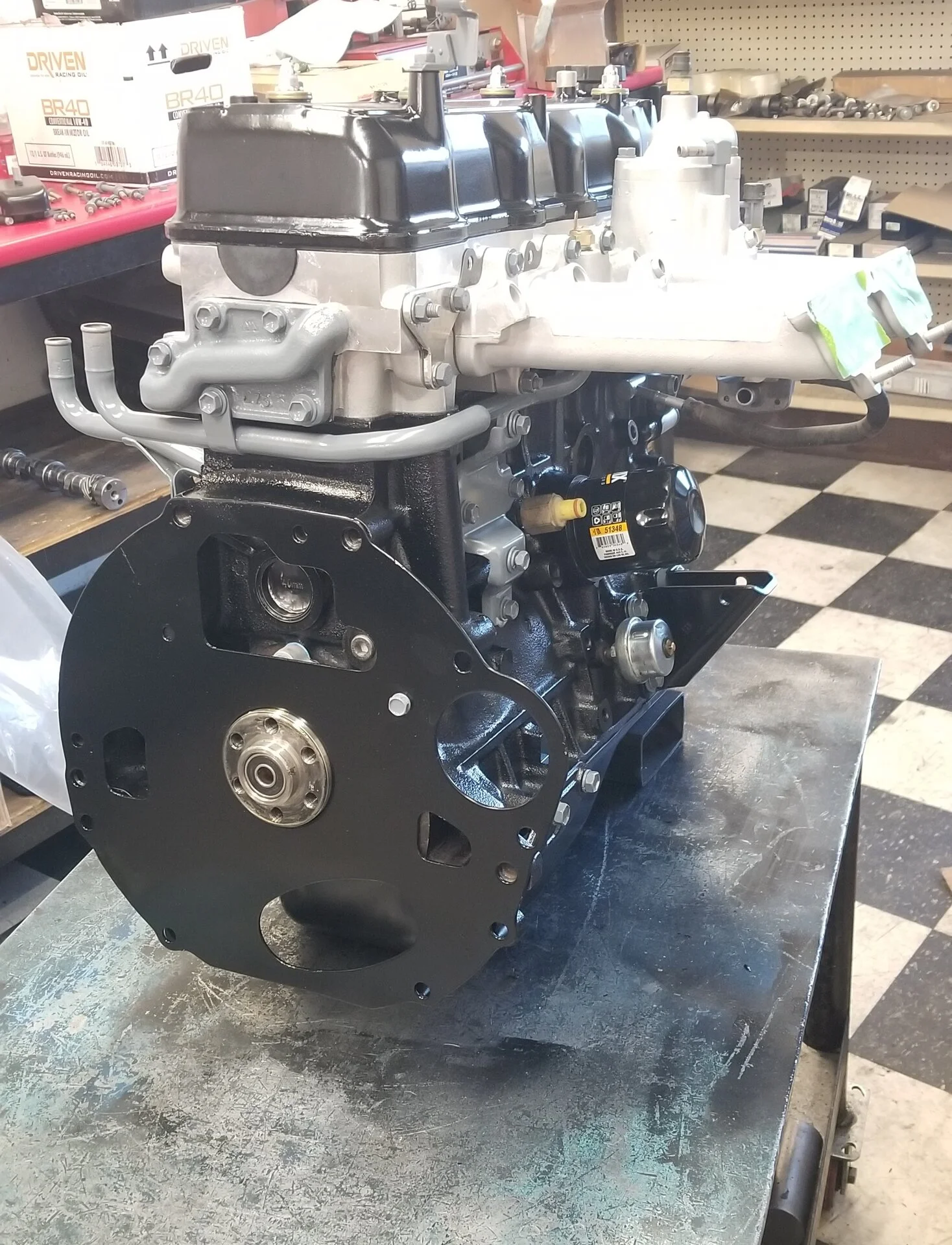

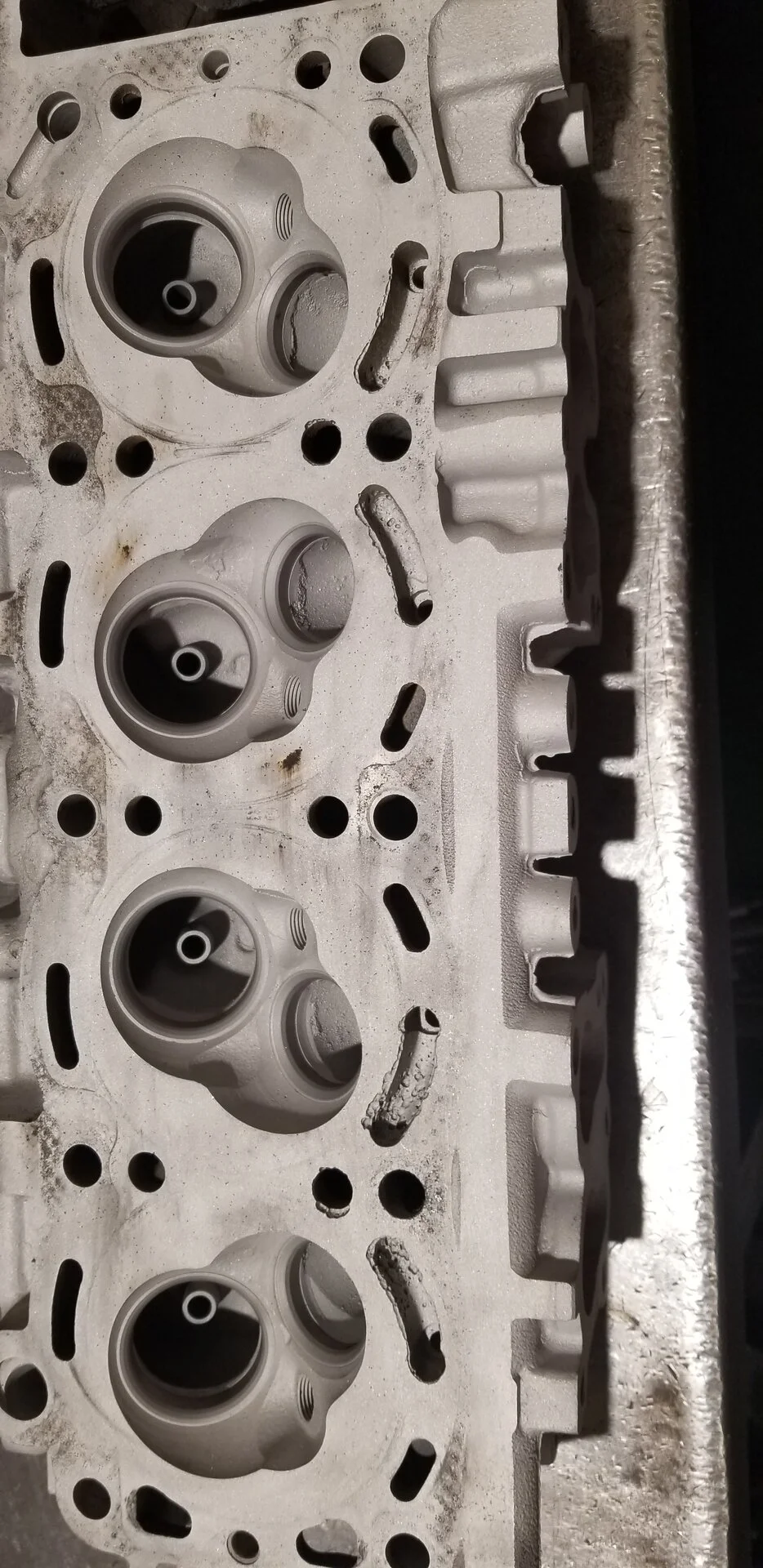

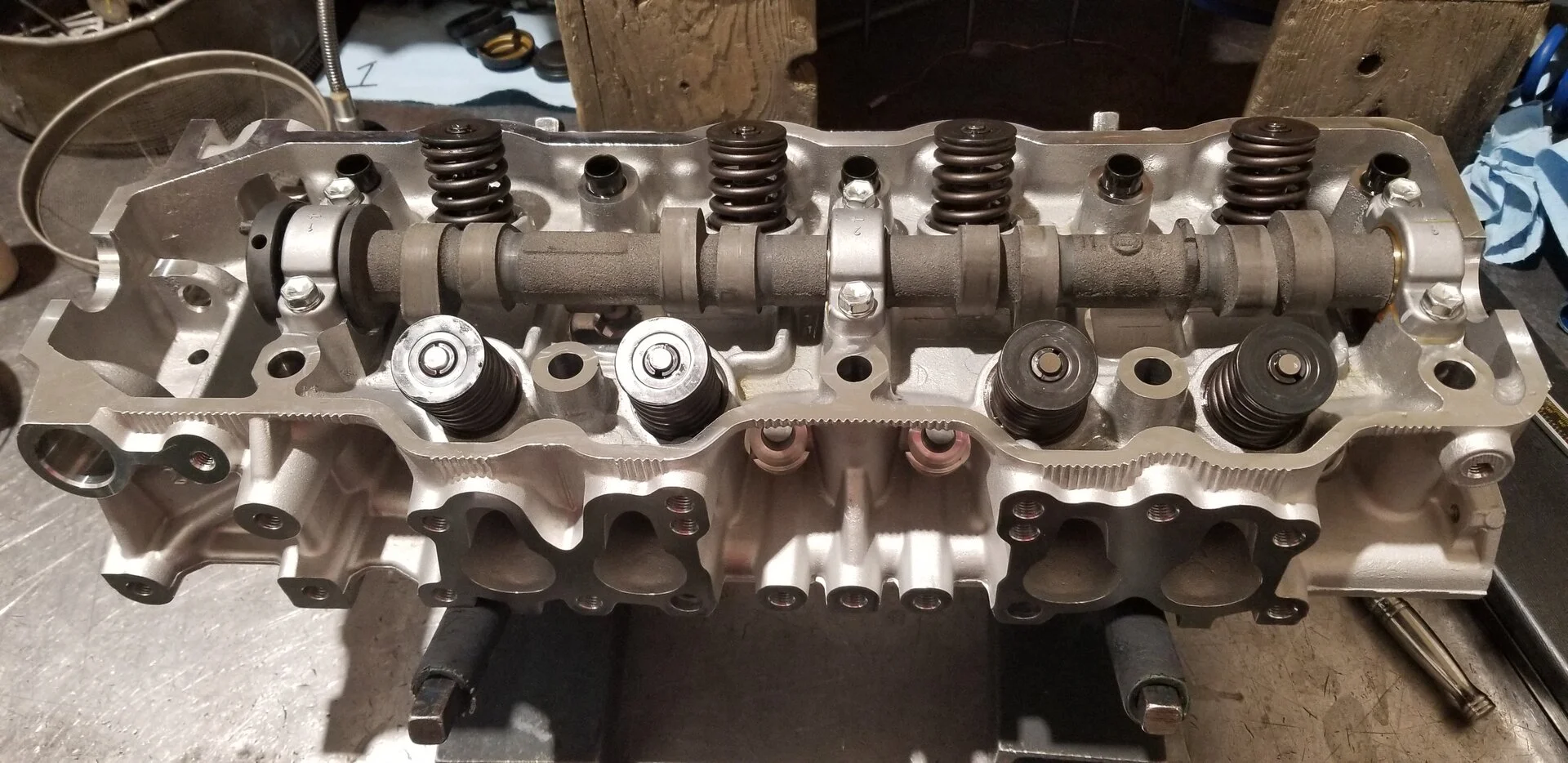

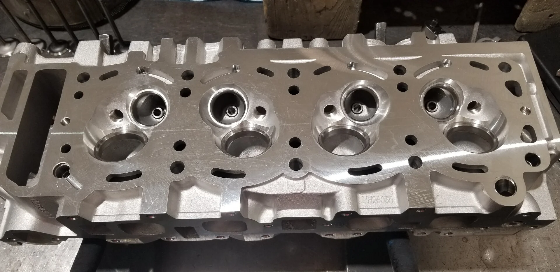

Cyl head casting was shot. Possibly repairable but not worth the time or effort. Exhaust seats were pounded out, heavy pitting into the firing ring and deep into water jackets. The guides and valves stems were minty though. New fully machined castings are available cheap. I bought a bare casting and assembled it with refaced and polished OE valves, springs, a OE cam ground to .430 lift .213° @ .050.
The seat contact position and guides on this head were perfect, dead flat. Couldnt ask for it to be any better.
The "miled out" stock springs were still in spec and had 5lb more pressure than a 300 mile set of aftermarket replacement springs.

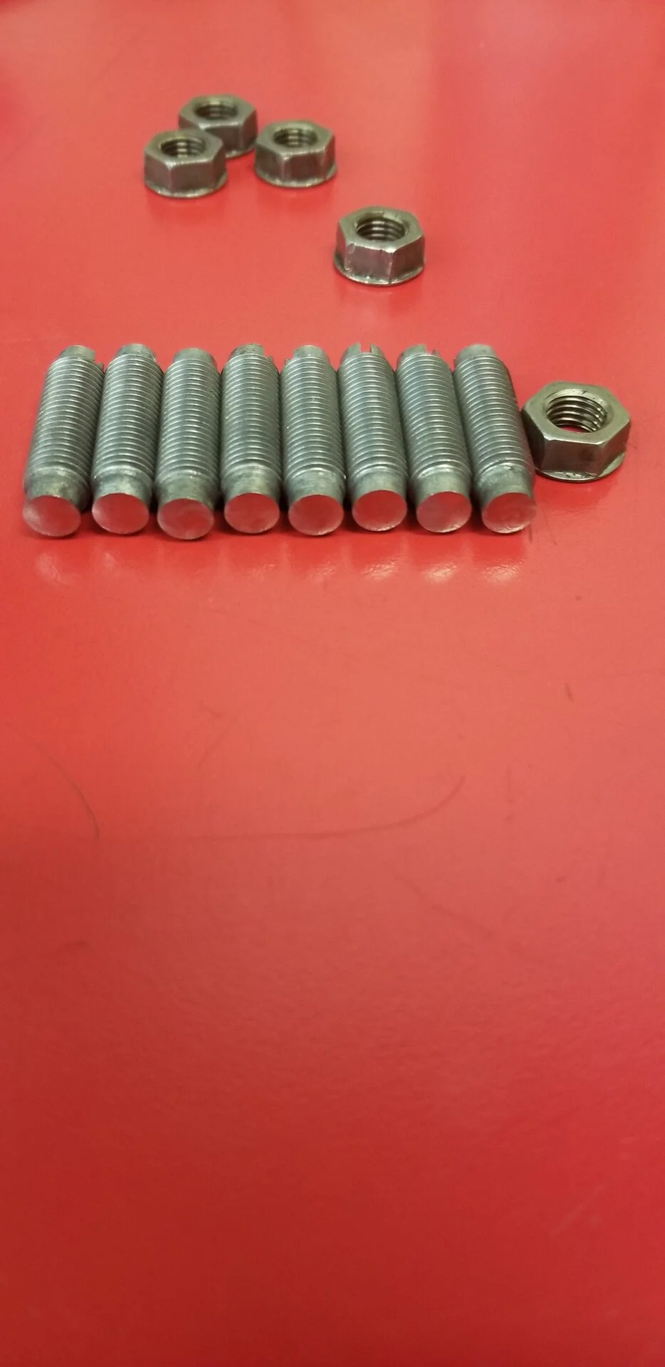

New valve adjusters from Toyota.... spendy at $10 EACH, lol. I trimmed the valve tips, and had the rockers refaced when the cam got ground. New head bolts.

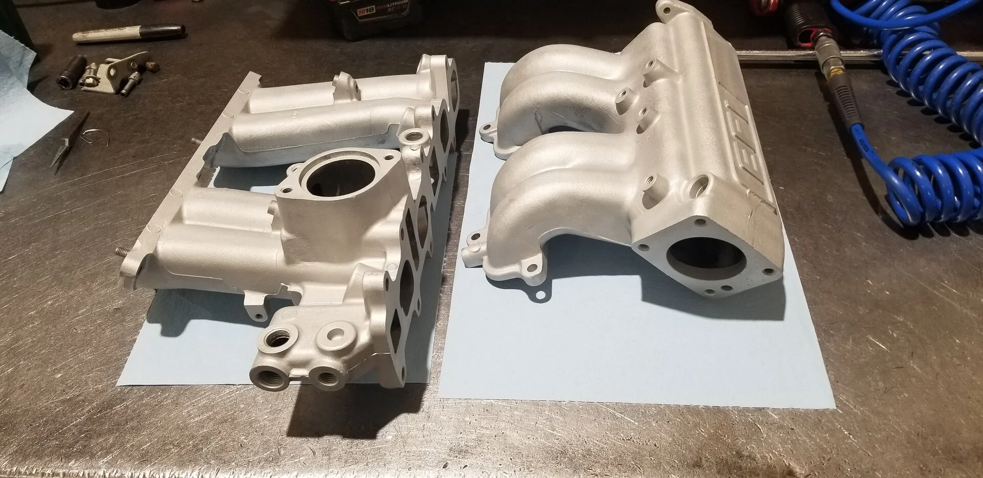

Knocked out the plugs in the intakes and cleaned em up real nice.

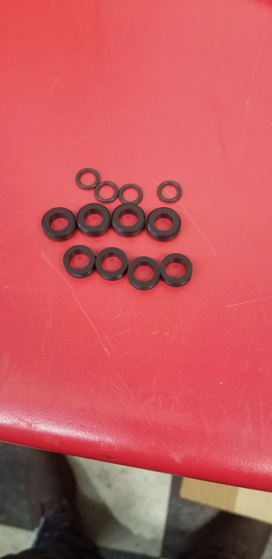

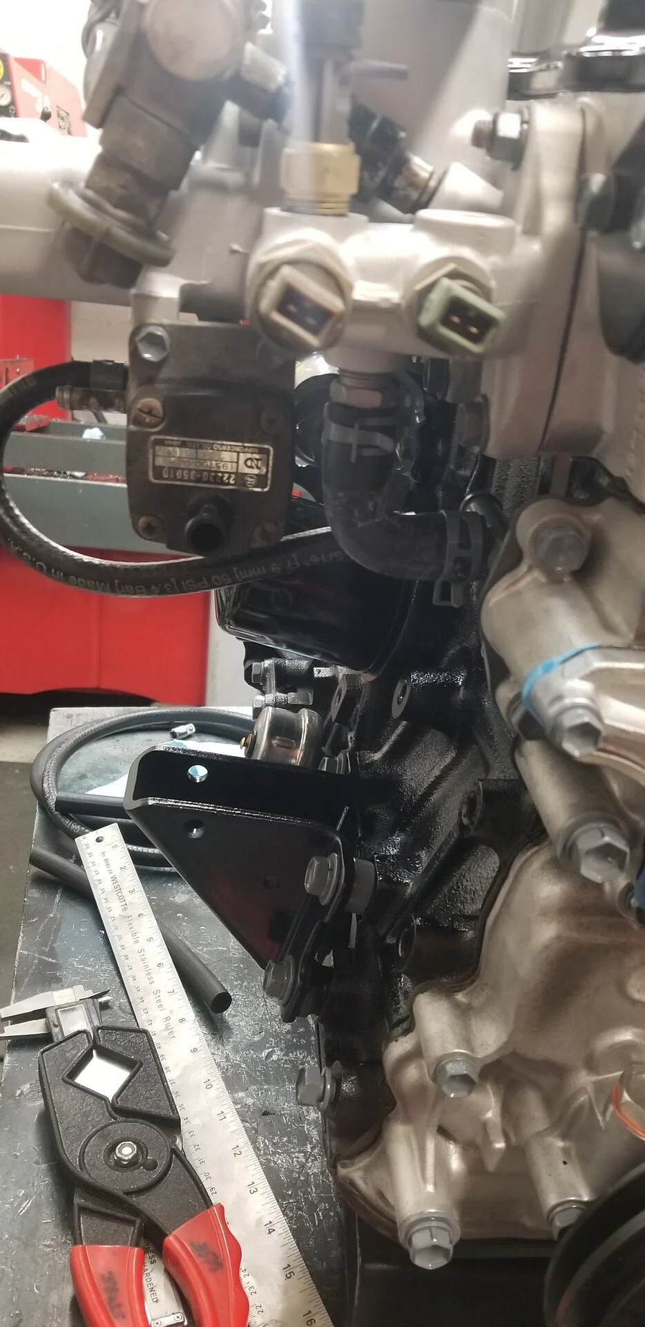

New injector O rings and coolant lines are pretty well standard while youre there items. Had the injectors cleaned and flow checked. Fixed some wiring loom and dried up stuff.

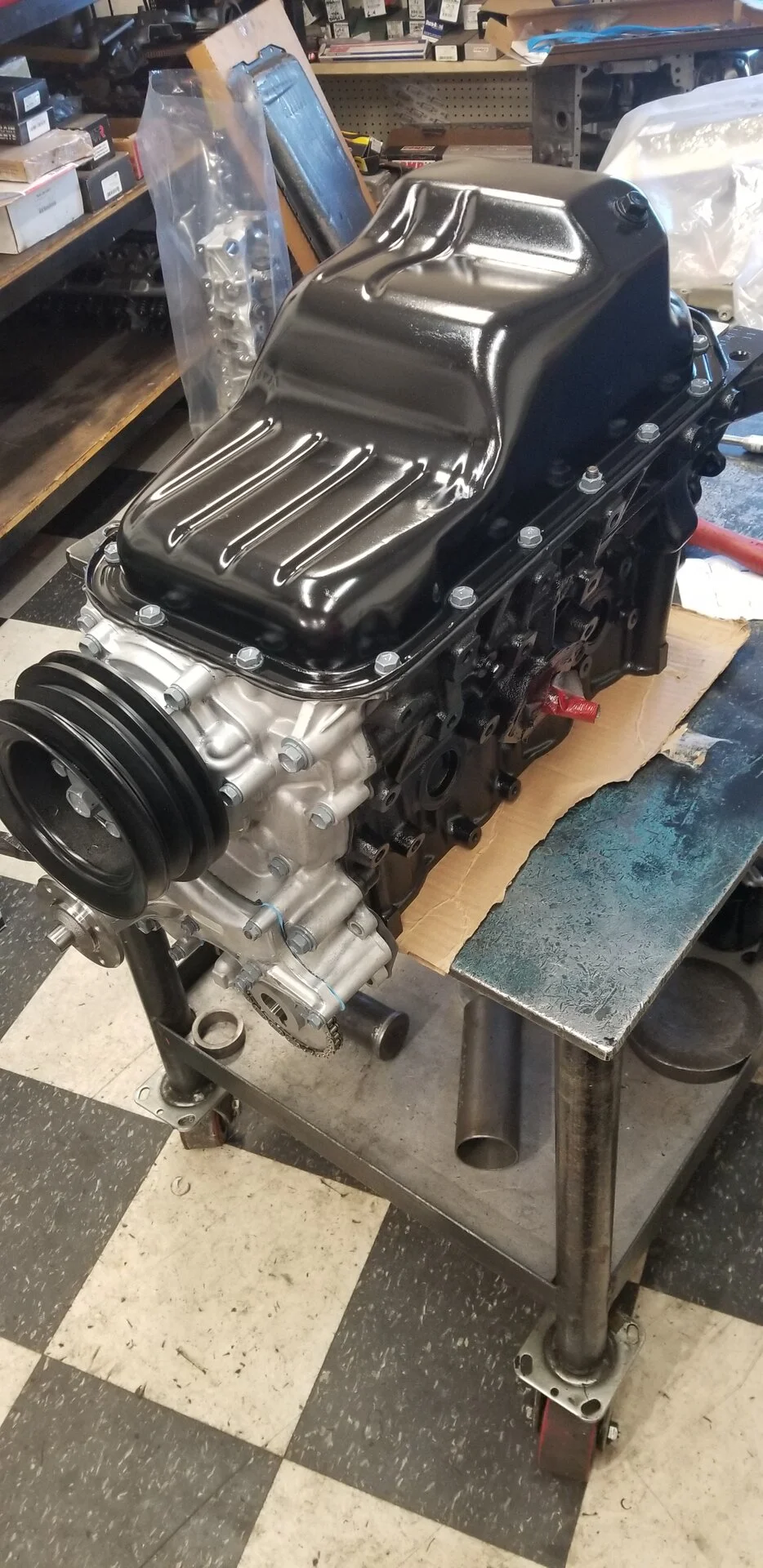

And thats pretty much it. Ready to go in the hole minus a dozen small things left. I'll try and get a video of its first fire up.

Looks great. Going together with clean parts feels good. Cleaning them.... doesn't feel good.
Did you buy an OEM bare cylinder head? If not what did you get?
Thanks, I cant stand dirtily assembled parts... and I especially h8mud :cool:
Enginetech cyl head casting. Seems theres atleast 3 claims by 22re builders claiming their casts arent junk but they arent OEM either. They also wont tell you where they got them or who's name is on them except claim "buy from me for X reason". I have no reason to believe their cast source is any better than what enginetech will sell me for half the price. Time will tell. OE cast is around $1000.... 3-4x the price of anything else available.
