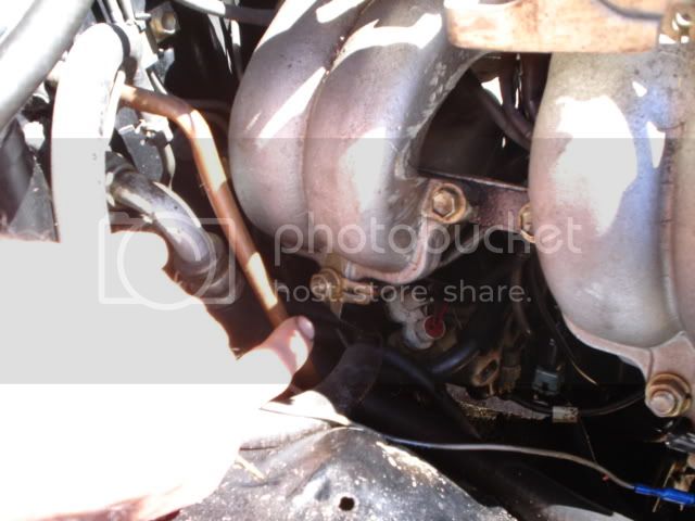

this is the bolt on my 86 that more closly resembles the one on your 85.
in my first post i was mentioning the placment on my 89.
they are slightly different.

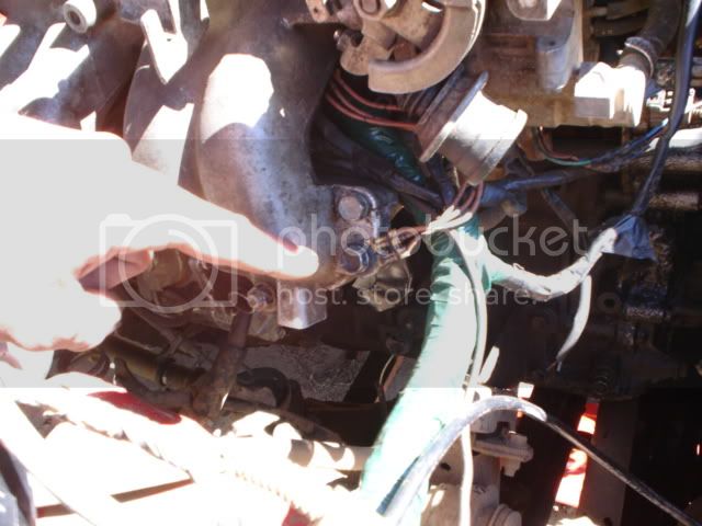

this is my 89.
