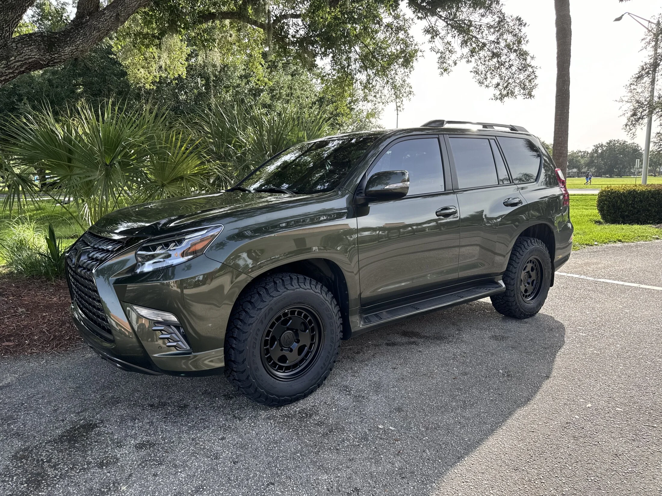

My name is Craig, and I recently purchased this '22 Nori Green Black Line with just over 20K on the odometer. My most recent vehicle before this one was a 2020 Ford F150. I loved that truck, however, it was just too big for normal everyday driving and I was looking into getting into an SUV anyway. I previously had 2 Tacomas, a 2nd Gen and a 3rd Gen. Having had a pretty terrible experience with my F-150 and the lack of support from the dealer, I knew I was going back to Toyota / Lexus. When I looked at the cab of the 4th Gen Tacoma, I was a little disappointed by the interior space and didn't really feel confident with the reliability of a brand-new generation. I also didn't want to wait for a new 4Runner or Land Cruiser. I didn't think to take any pictures with it stock, at least none that I could find, so here is a photo from today right after the new wheels and tires were installed:
The wheel/tire set up consists of Fifteen52 Turbomac Classic HDs wrapped in BF Goodrich KO3's sized 265/70R17. Unfortunately, I misjudged the size of the tire a little bit and there is some rubbing when turning left and right, but it does not appear to rub in the rear at this time. I don't intend on fully flexing the vehicle at all and this one is likely to never see more than flat dirt or sandy roads to the beach. I'm trying to figure out whether a small spacer lift or trimming the fender liners is more appropriate.

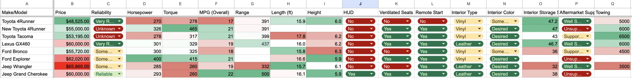

My decision making process really came down to putting every vehicle candidate on a spreadsheet and making a decision based on data. If you're curious to see the craziness, here's a screenshot of the sheet that helped me make my decision. Some of the numbers are rough estimates, so don't beat me up to much on the accuracy:

Congrats! For the rubbing, unless you want to add a spacer lift (which may or may not fix your issue), I would start with having someone turn the wheel lock to lock to see how bad the rubbing is and where it's occurring. You may only need a heat gun to massage the plastic and / or a knife to trim a little. The width and backspacing on the new wheels is going to play into it.

As an engineer I like your methodology for decision making.
After looking at your spread sheet, I'd have to agree that the GX fit the bill best of the vehicles you listed with your desires and wants.

Regarding your wee bit of rubbing, myself and I'm sure most everyone on this forum would recommend you do a body mount chop (BMC)
As I tell folks new to this, it's kind of like getting your tonsils out, almost everyone has it done, it's painless and you can treat yourself to an ice cream afterwards.
Seriously, the body mount of both the GX's and the 5th Gen 4Runners is a major problem, but... it is one of the most common mods, doesn't cost very much and should cure your rubbing. Another option is, don't cut your inner fender wells, try to get a good view of exactly where your rubbing is, and see if a heat gun will work instead of cutting. Using a heat gun may be all you need.
Hey Bang Bang, thanks for the tips. Based on the content that I've watched on YT, it's definitely rubbing in the usual places on the bolts holding in the rear of the fender liner and on the mini-mudflap on the front. I think I'm going to start with securing the fender liners with a thick zip tie and doing a light trim of the fender liner, and taking the front mudflap off.

So.... that spreadsheet.... what type of engineering degree do you have? :)
Haha, no engineering degree. I am a project manager of sorts in the Insuretech space. In my previous career I lead a claims team and spent my life in spreadsheets and system data tables.
