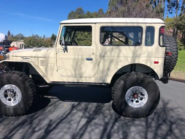

Well you busted me Don, Yea I finally got a break in everyone else's projects to complete the top for my Cruiser. It took two hard tops because I stretched my tub when I built the Cruiser for more wheel base. The front is from a early 1972 with the large side window and the back half is from a 1976 with the pop out side windows welded those together then cut up the fiberglass tops to fit, married those together and ordered a custom head liner and I'm using all the newer doors all round.
So I changed my mind about going and got some other things done. Where did all the FJ40 go?

And the old straight six was tuned up a bit too! What a beautiful piece of work Tim. Are you really going to hang on to this one? Let’s get it muddy next year😉
