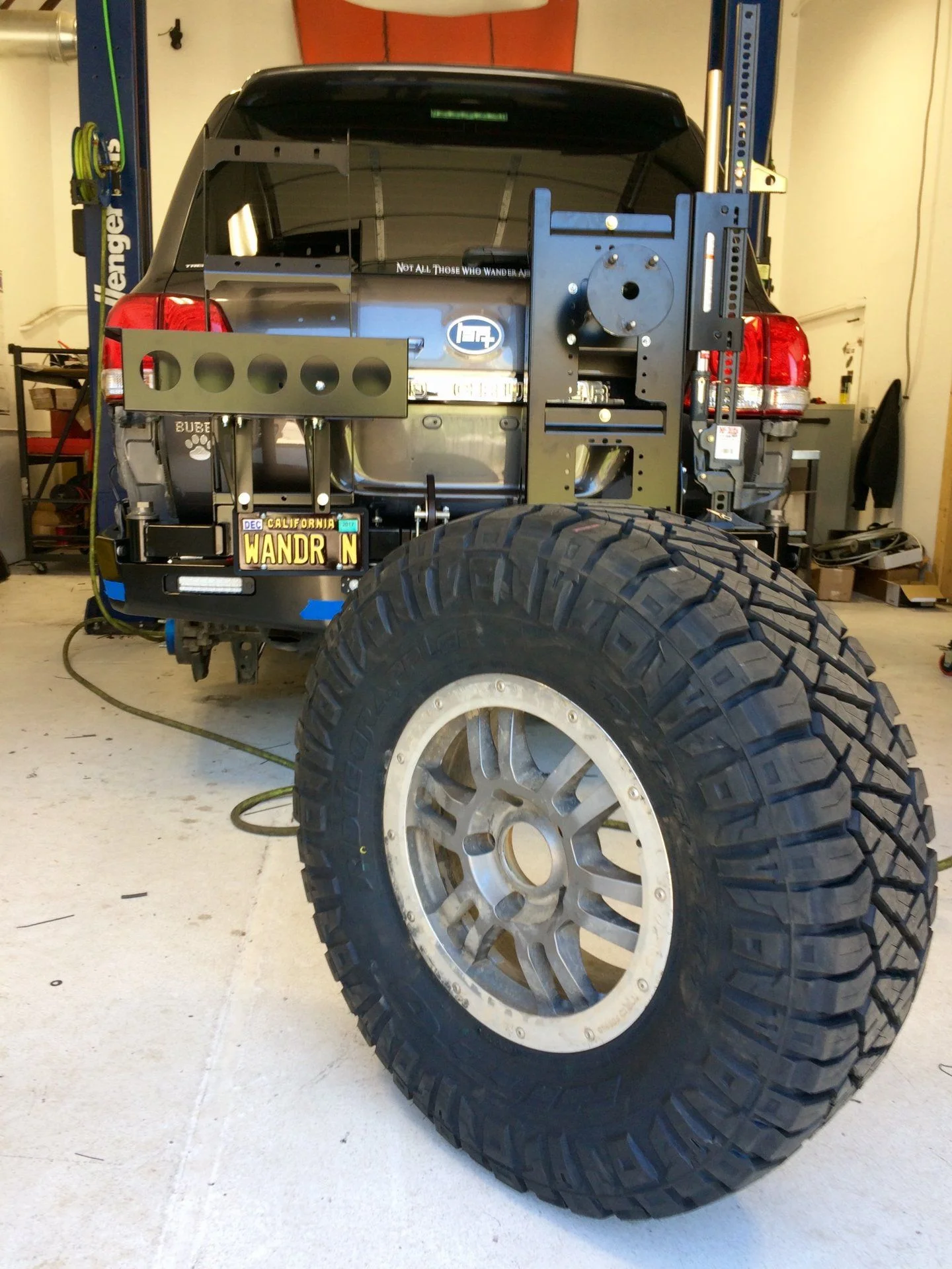

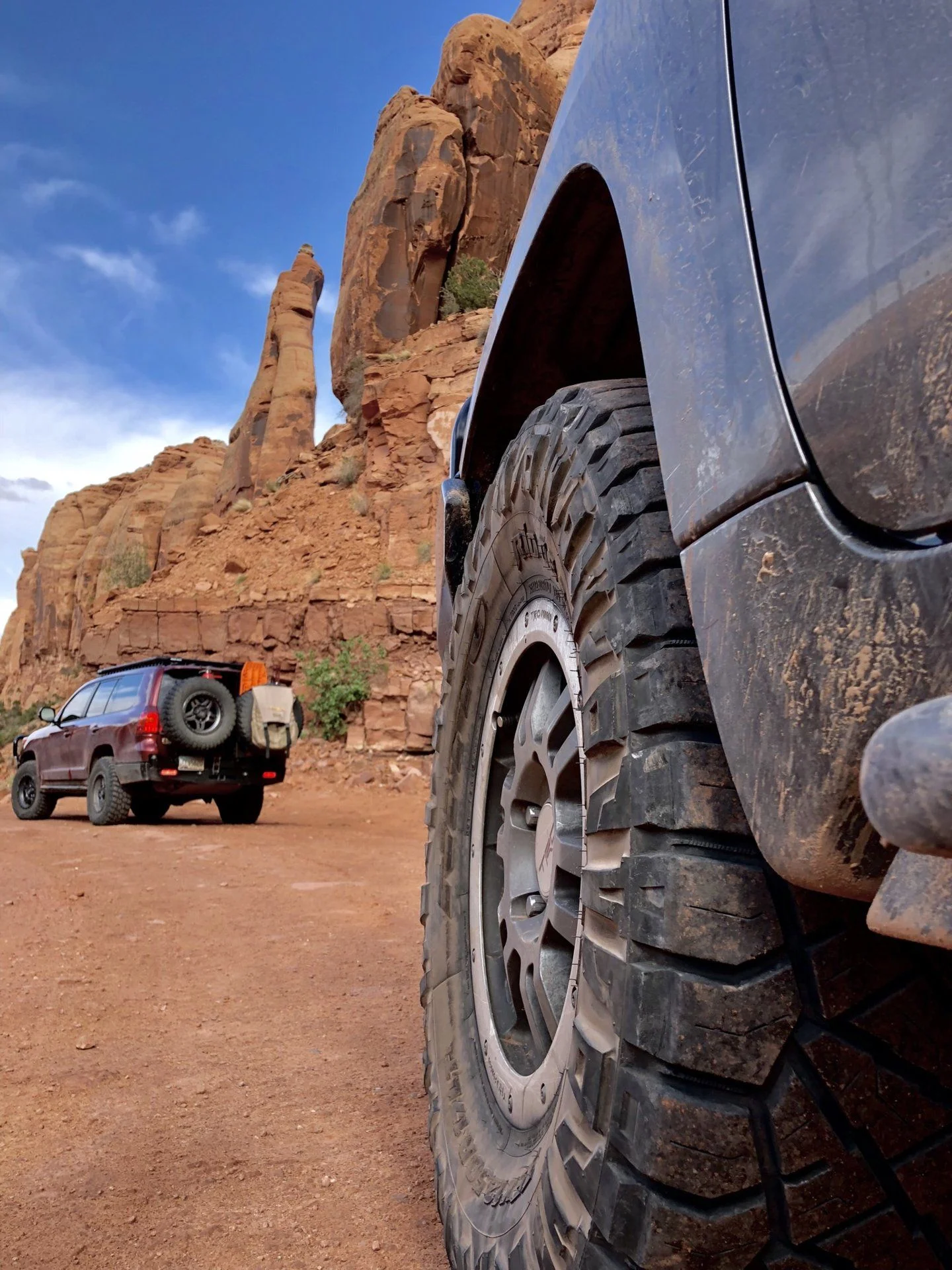

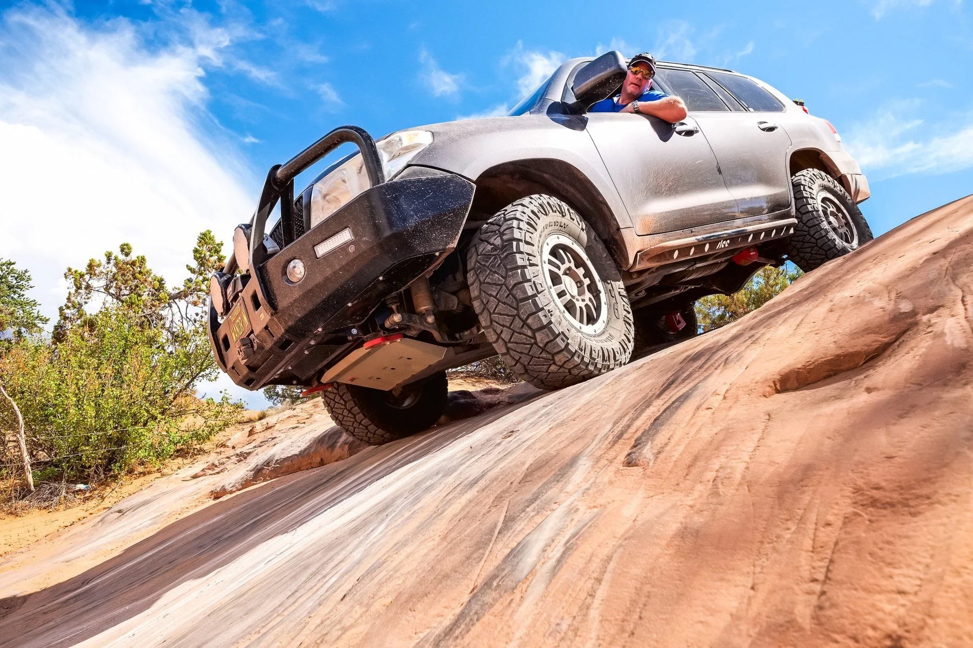

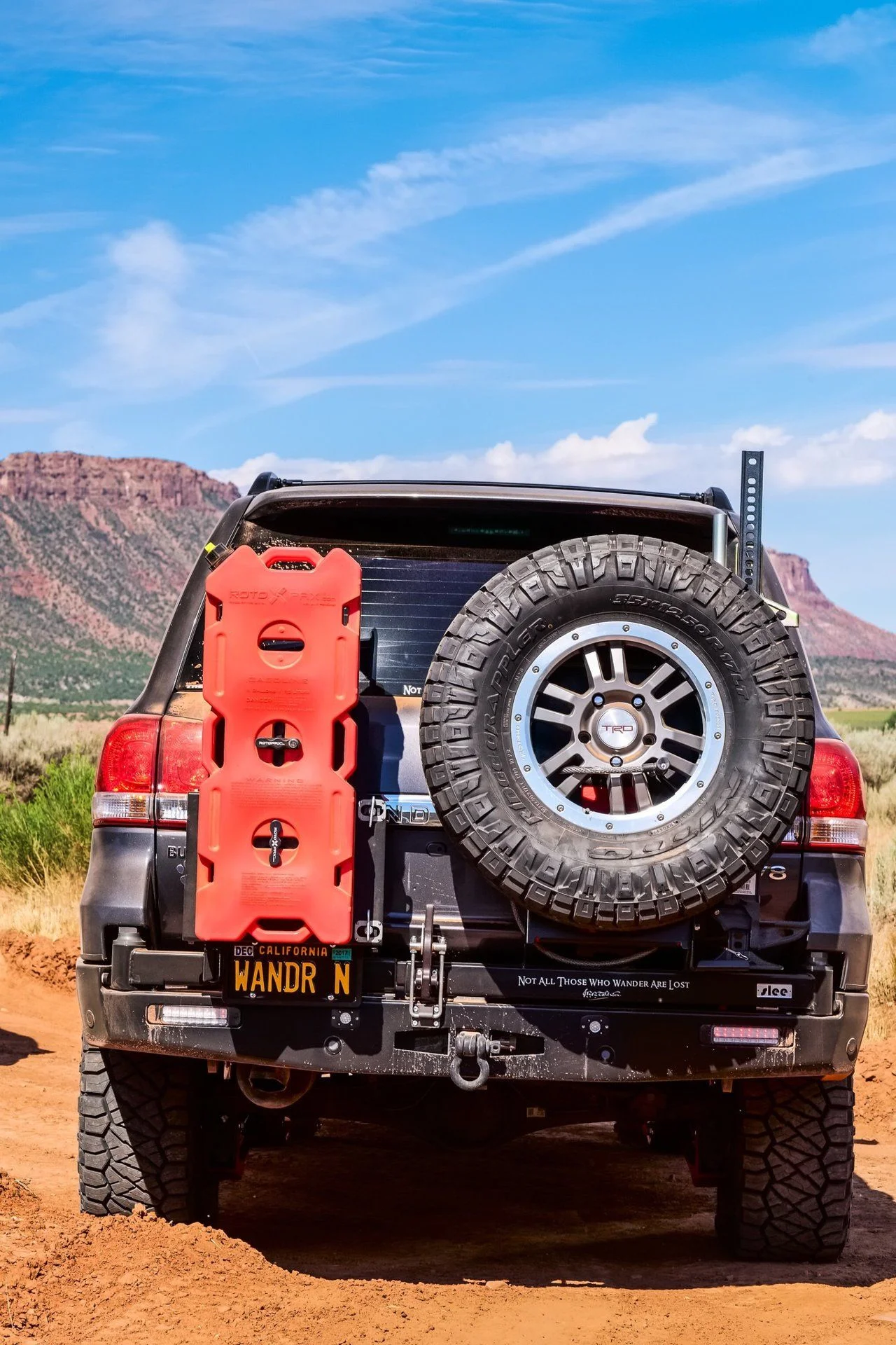

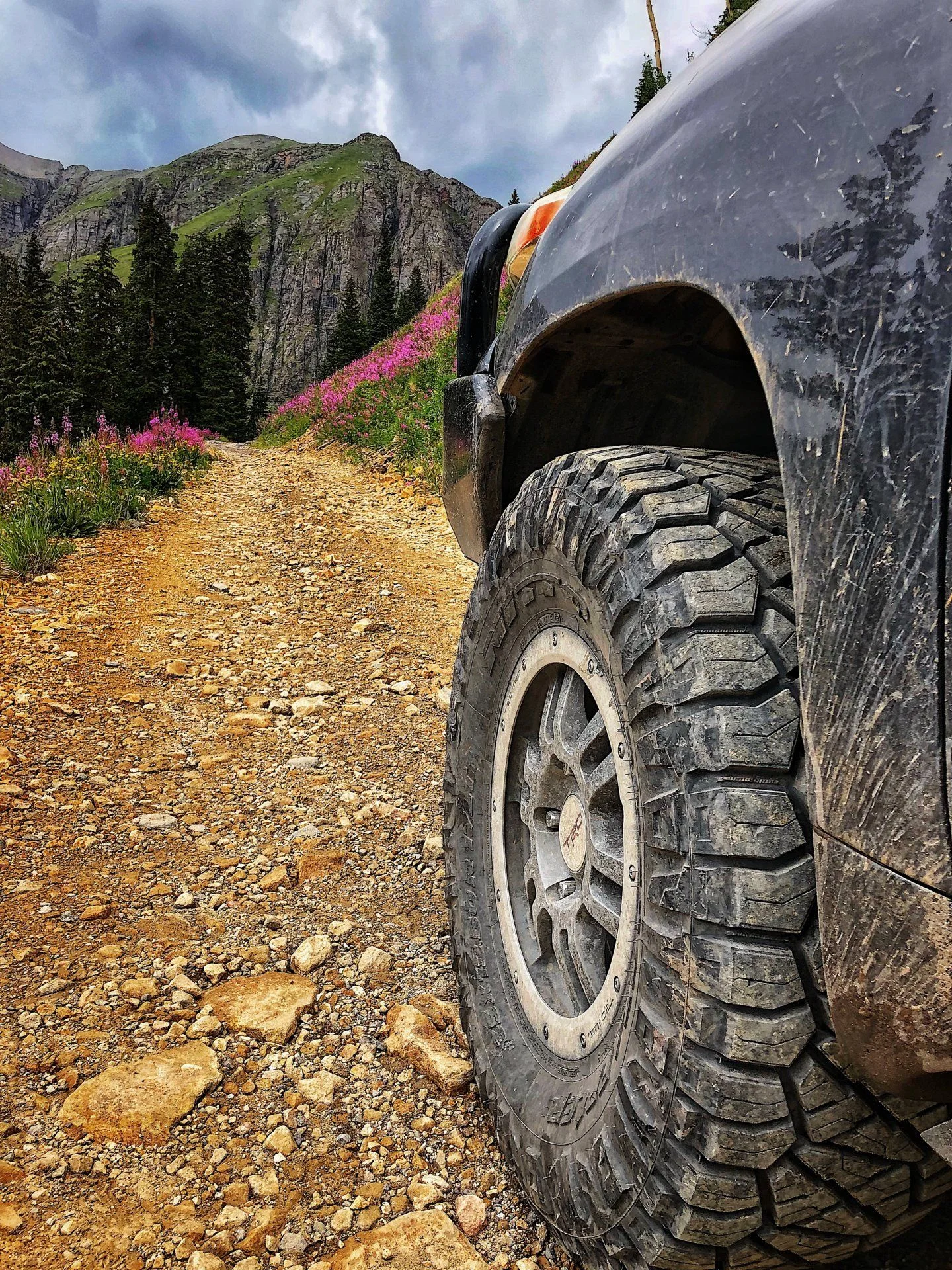

Hmmm. I wonder if I have any tire/wheel photos... :hillbilly:
Rock Warriors
17”
50mm offset

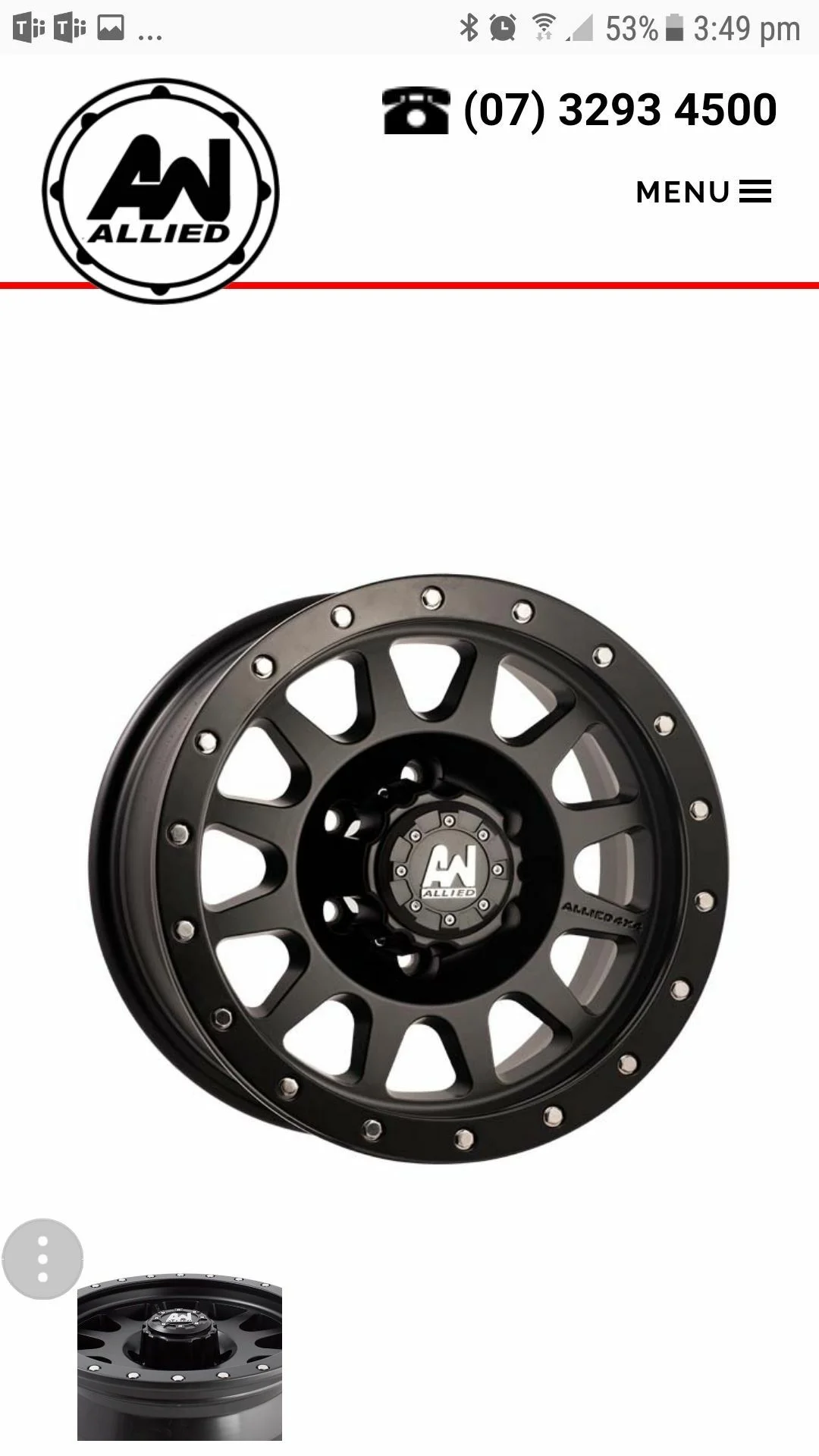

Those Allied's would look awesome on your 19! Plus that would reduce the number of PNW people looking for RW's :).
is that a "these aren't the droids you're looking for" move?
Methods, Allied and other do look great but I have yet to find one with the correct offset in either a 17 or 18. I am probably too late to the RW party and don't know if any of the (reasonably priced) aftermarket wheels are better than stock LC and Tundra wheels. Sadly, the $50 Pro Comps don't seem to fit. If anyone has a specific recommendation, I would greatly appreciate it. And of course, nothing weird. Just normal spokes or "D" holes and preferably without fake bolts and other bling.
