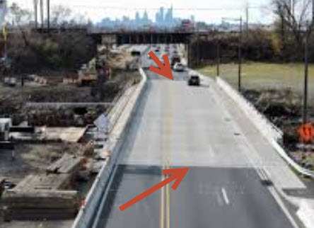

Im talking about just stuff in the back, 3rd row seats stowed, loaded floor to ceiling. When on the interstate at 70-75mph and crossing over an overpass bridge, if the transition from road surface to bridge surface and back to road surface is not perfect it will induce a fairly disconcerting wallow that lasts two or three cycles.
If there is any curvature in this section it upsets the chassis even more. Very uncharachteristic for such a vehicle, IMO
