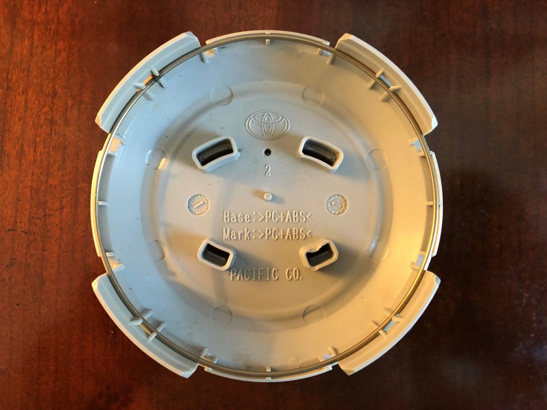

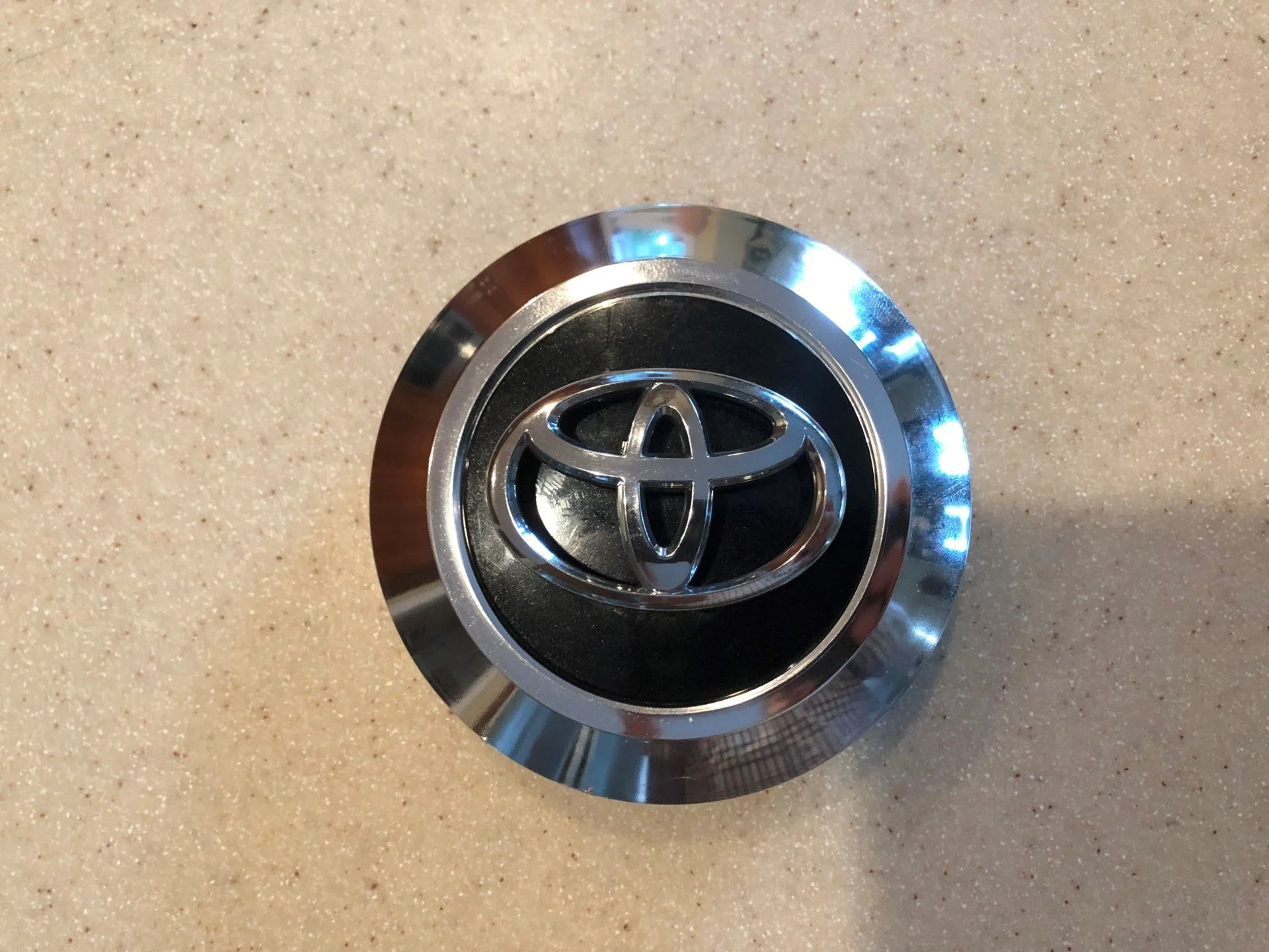

Need some help/advice. I have a 2017 LC and had put some aftermarket rims on. I recently purchased a 2004 Lexus LX470 and thought it would be great to put the 2017 LC rims on it. The problem I'm trying to solve is getting a Lexus center cap for the rims. I can't find a Lexus center cap that will fit. The LC center cap is ~95mm in diameter. The black portion is ~62mm but does not come off. However, the Toyota emblem pops off the black piece.
I have seen emblems that you can stick on with adhesive but was hoping to avoid that.
Have you tried fitting the wheels? I don't think the front center caps will fit over the 100 series front hubs
You may have to pop the metal cap off the hub to get the center cap/wheel to fit. I had to do this on my 2013 that has 2016+ wheels.
The hub design is still pretty different and the 100 drive flange and axle stub stick out a good bit further than a 200 hub with the unit bearings.
If I remember correctly anyway.
