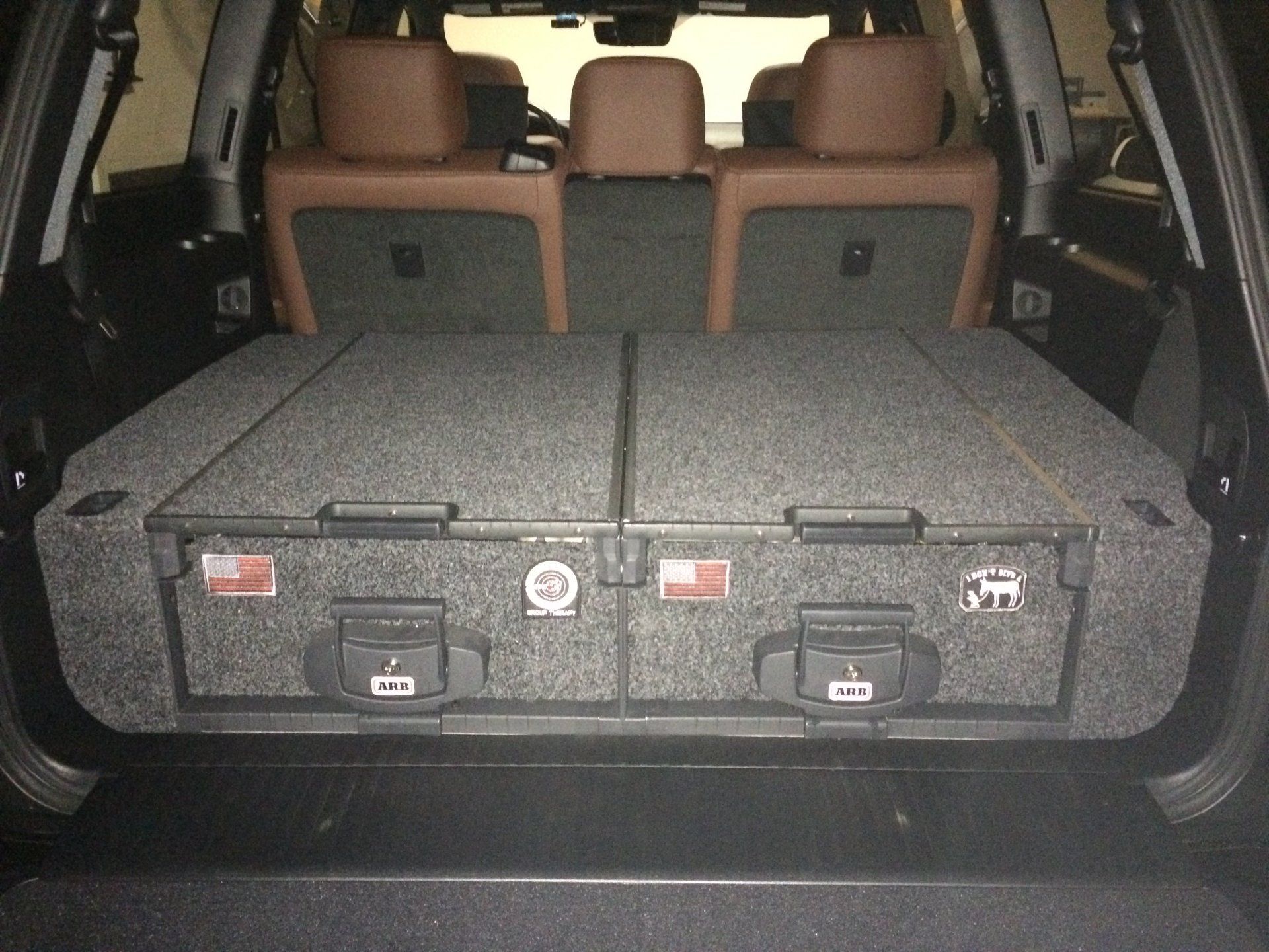

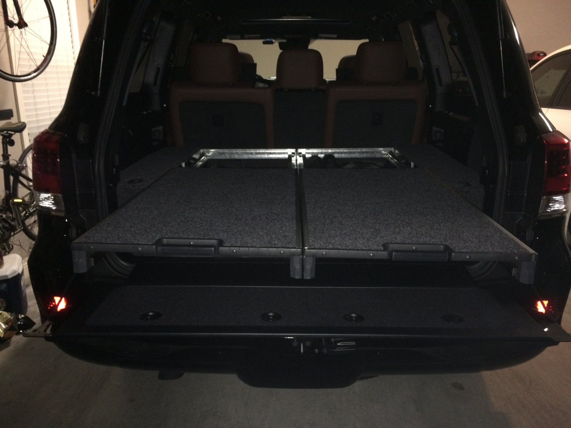

I installed 2 ARB drawers, both with sliders and side trim pieces, in my 2017 LC. The entire setup fit and operates perfectly. I was able to complete installation without drilling into vehicle as I was able to use longer bolts in the 3rd row seat bolt locations. I am most pleased with the finished product.
I uploaded two photos. I took them this evening. If you request, I'll take more pictures during the day and upload them as well.
I hope this helps.

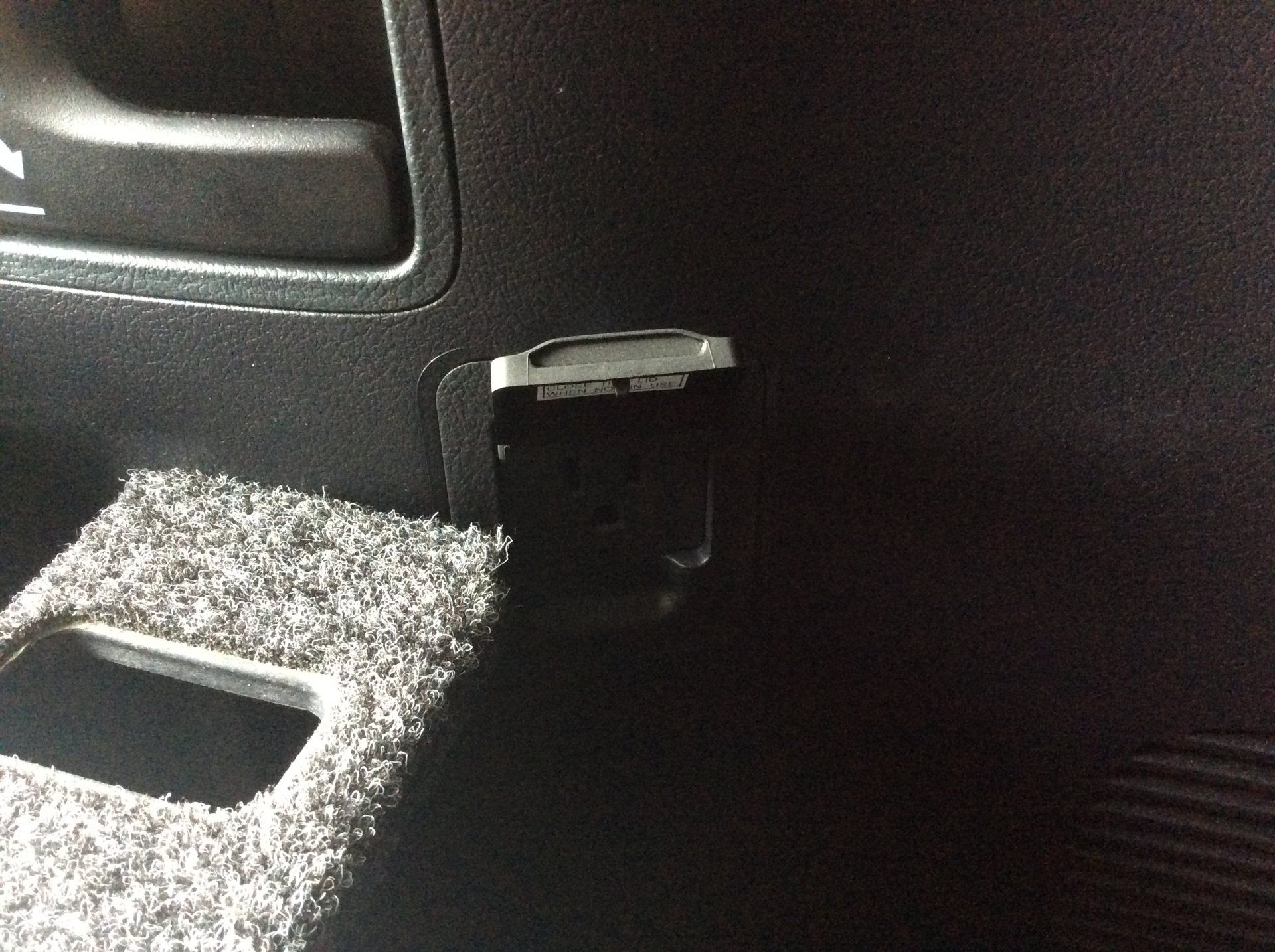

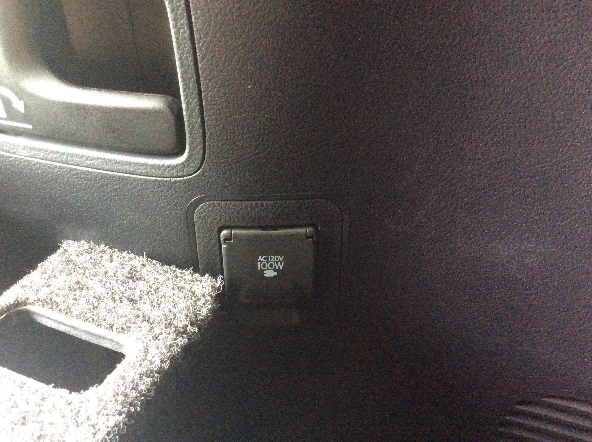

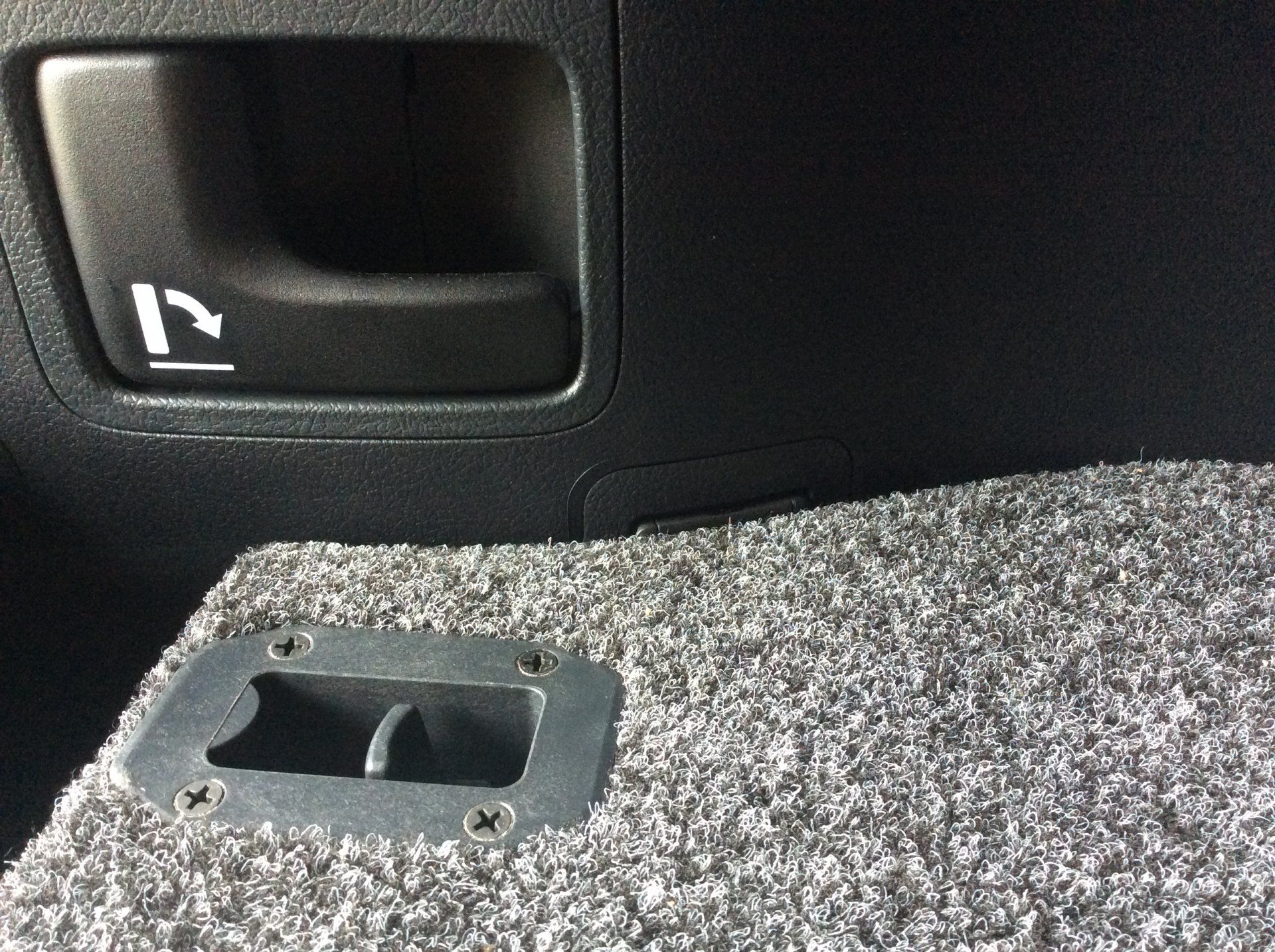

Just ordered me a set and am driving up to Slee to pick them up Monday. A question that I just thought of- can you still access the 120V outlet from above, or is it now below the fit kit?or no longer accessible at all?
Great question. The panel sits at the same height as the outlet. It is still usable but only with the panel unlocked and/or removed. At some point I will move the outlet, as others have done, place it in the vertical panel on the left side of the drawers. I've uploaded some pictures for clarity (no pun intended). Hope this helps!
View attachment 1480372 View attachment 1480371 View attachment 1480370 Great question. The panel sits at the same height as the outlet. It is still usable but only with the panel unlocked and/or removed. At some point I will move the outlet, as others have done, place it in the vertical panel on the left side of the drawers. I've uploaded some pictures for clarity (no pun intended). Hope this helps!
Awesome! Thanks for the photos.
Yeah the key is that it stays usable after the install, I hit the road mere moments after the install and I need to have my fridge running for the trip. Like you,I plan to both move the outlet and wire an always on back there for the fridge as well, but that won't happen in the next 5 days.
